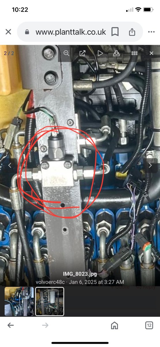

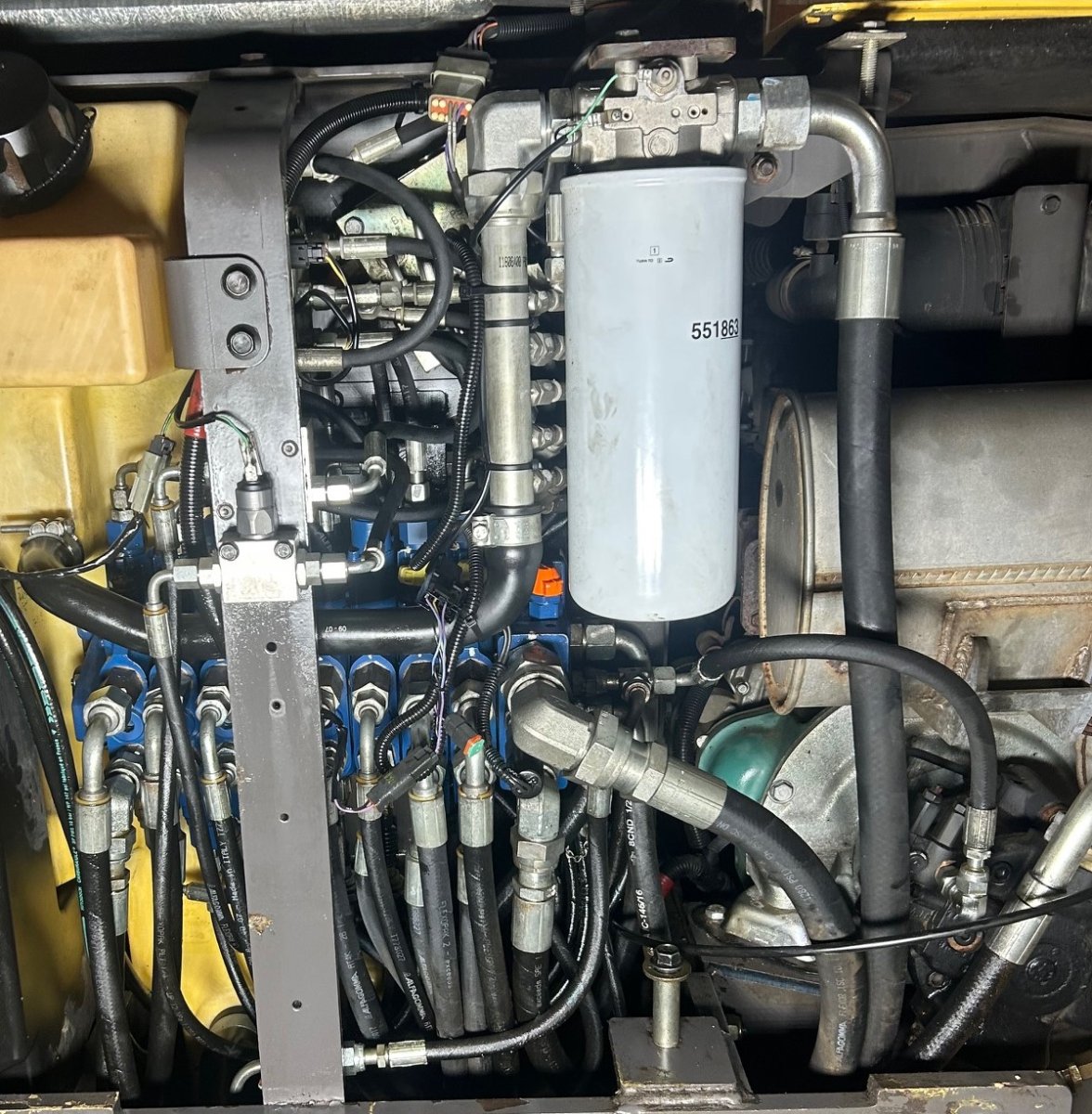

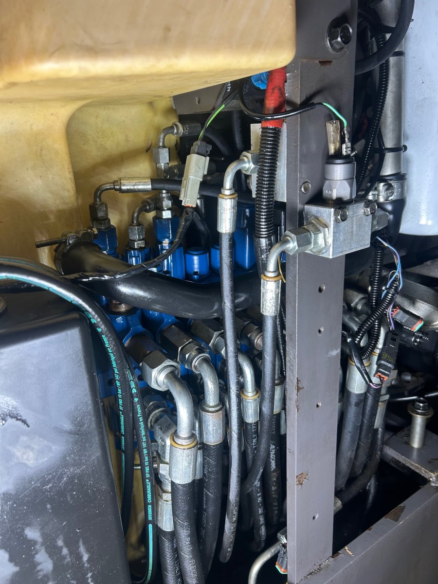

This has to be simple but my excavator swing brake will not release with any machine function except for me activating the thumb which is the boom angle as well. I have used a volt meter and I am only getting voltage to the swing brake solenoid which I think is mounted on the back side of the vertical bar when I press the thumb function but then it locks the swing brake after 5 seconds.
Any volvo or swing brake experts have ideas?

thank you Mick - the - fitter, I don't have a manual nor wiring diagram so i am not ware where the solenoid is for the thumb? Anyone have a manual or location?

Try this one first, pull the wires off, tape them so they don’t touch anything!

Oh yes well spotted Gra, I went for that as it looks like a bolt on item!!

Maybe the one bolted behind, as the hose coming to the right hand 90 looks a bit odd beyond!

Ok, Had a look in the manual, This is the "Slew brake, pressure sensor"
It takes its signal from that back into the Vehicle ECU

I stand corrected i was wrong,
The slew solenoid is mounted behind the bar, MA9402

'Drema has one - solenoid failed and it was locked solid :mad: .. bloody annoying and took some sussing/finding
could've failed internally then -- again had a very similar looking one fail, but that sh*t itself all over the floor, so was an easy / deffo bollo-ed find
