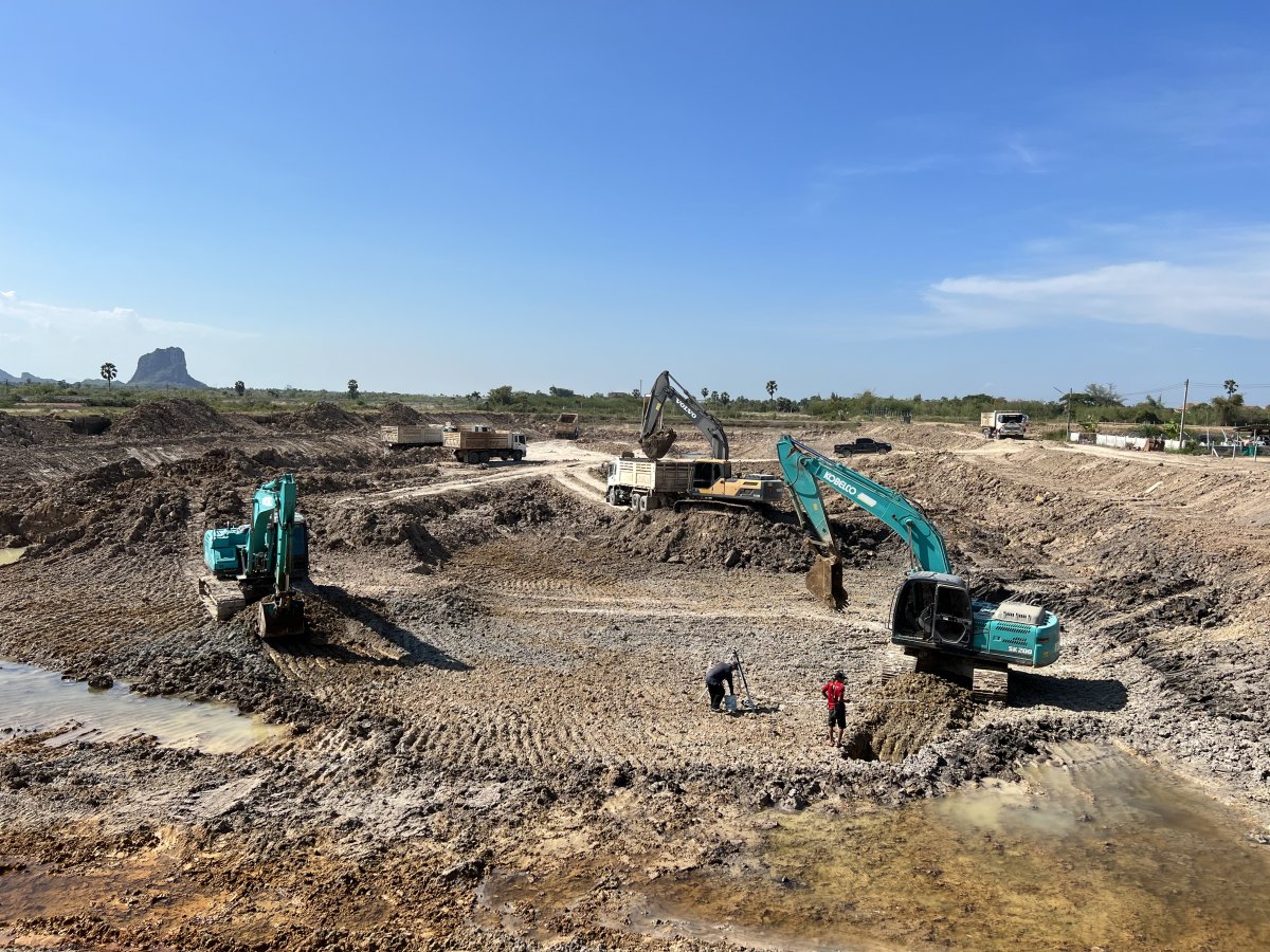

Attached photo of current project of mine it’s on.
Whats the project there?
