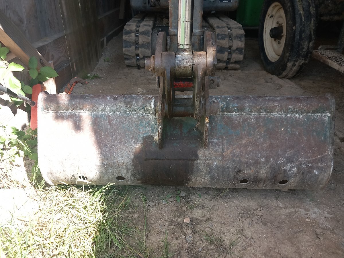

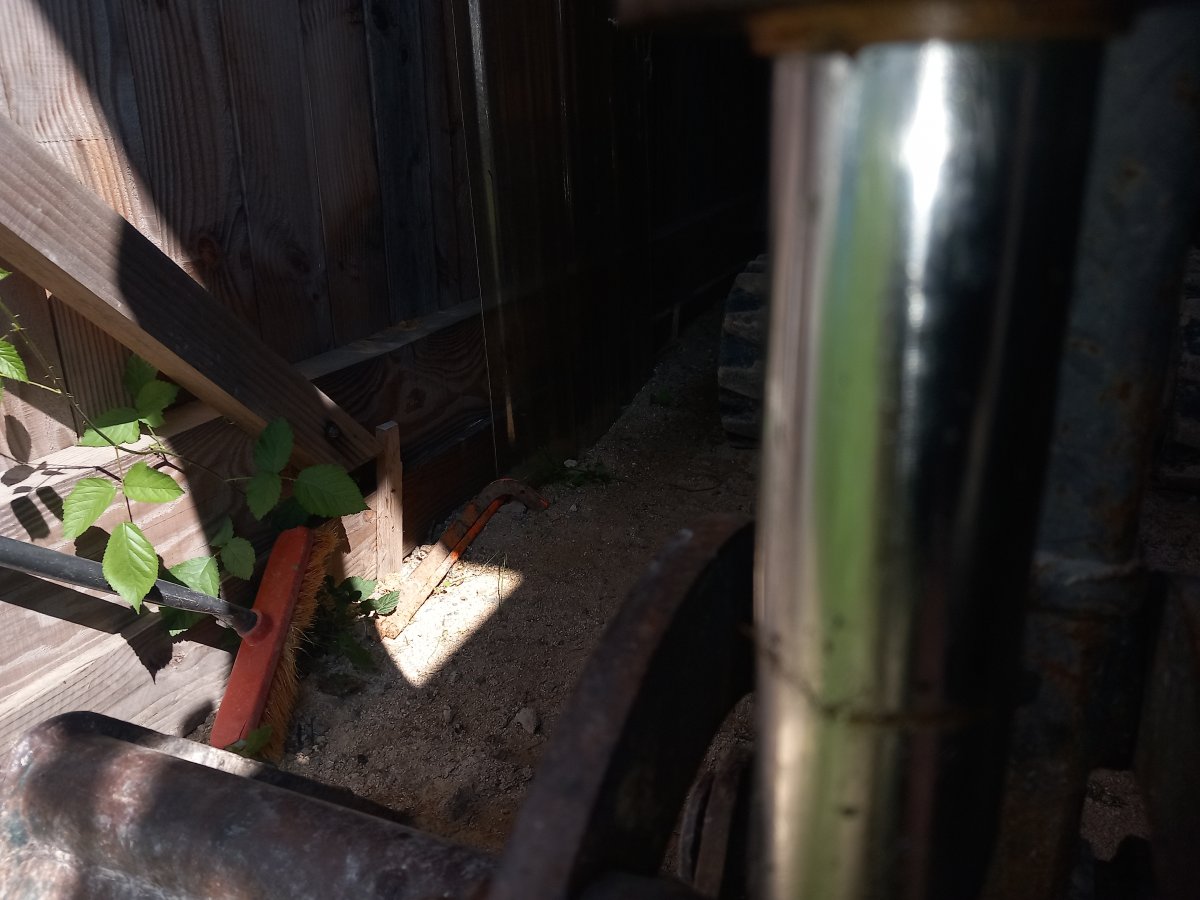

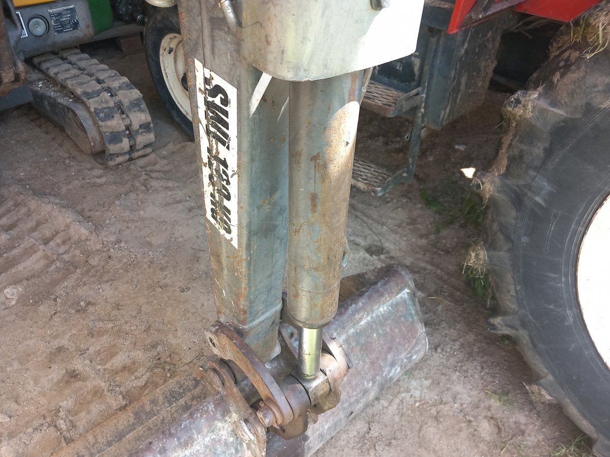

I went to the barn today and noticed an oil stain on the bucket.
Im assuming the seal has gone?
Is it just a case of knocking the pins out and undoing the hoses and taking it to be repaired.
Mechanics aint my thing and Im a bit concerned it maybe under pressure.
Any advice will greatly received.
John

I wouldn’t say it’s majorly urgent but yes, just remove ram and take to your local ram repair place. Will only be under pressure if you don’t life the bucket clear of the floor! Shouldn’t cost much.

rod's looking a bit past its use by date though Doob
