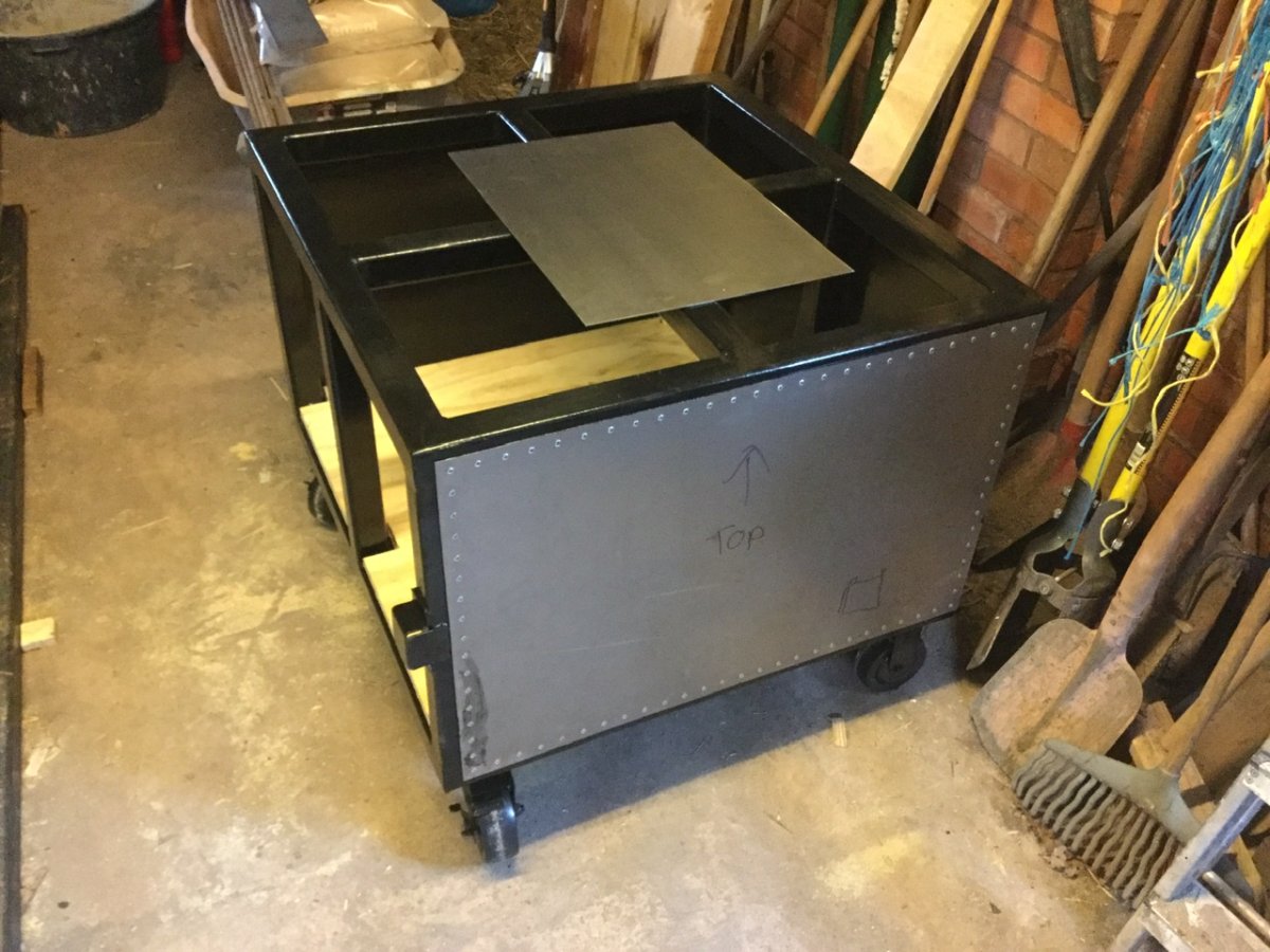

The top is made up from 50x175mm beams, topped with 18mm MDF. The mdf is not ideal because it soaks up most fluids. Because the main layer is beams I needed something that gave me a nice smooth surface, hence the mdf. It is also cheap and very easy to replace if required.
I wanted something strong enough to take a gearbox or part of an engine block. Probably a bit over engineered but it works very well.
The drill stand next to it is also homemade. Unfortunately I forgot to take photo’s after this one. View attachment 20596

If you've got a 2in thick timber base under your top you could always use a sheet of alloy instead of the mdf.

3mm steel'd be better ..... ali marks too easily and will 'gash' ... I have a couple of 4ft2 benches with 18mm ply top and a 3mm plate covering it ... taken a reasonable amount of abuse over the many years i've had them ... ex-shool workbenches that had the 2.5" hard wood tops 'liberated' off them :( .... the frames're gonna give out 'fore the tops do

Goes rusty though. Depends what you're using it for stainless would be harder wearing but the beauty of alloy is if you're rolling a gearbox casing around on it for example, being softer it won't burr any edges on it.

If you have a good strong worktop you could fit a sheet of plastic sheet from Direct plastics, easy to clean, won't go rusty, doesn't damage what you are working on and cheap to replace.
Just a thought. We've done it with a few benches next to machine tools at work.

Personally I prefer a wooden worktop as it deadens the sound a little bit compared to a metal worktop. Obviously both have their advantages/disadvantages and it all comes down to personal preference.
