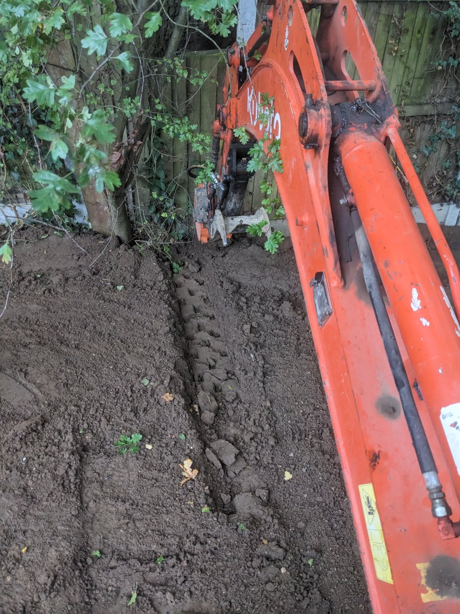

This little thing is handy for small/delicate areas

The bucket has been usefull occasionally for reaching through a hedge or a bank. Dug a watermain in with it the other day as I was confident in lack of services. Works okay and a lot quicker than digging a 760mm deep 1trench 150mm wide... but you cant see owt.

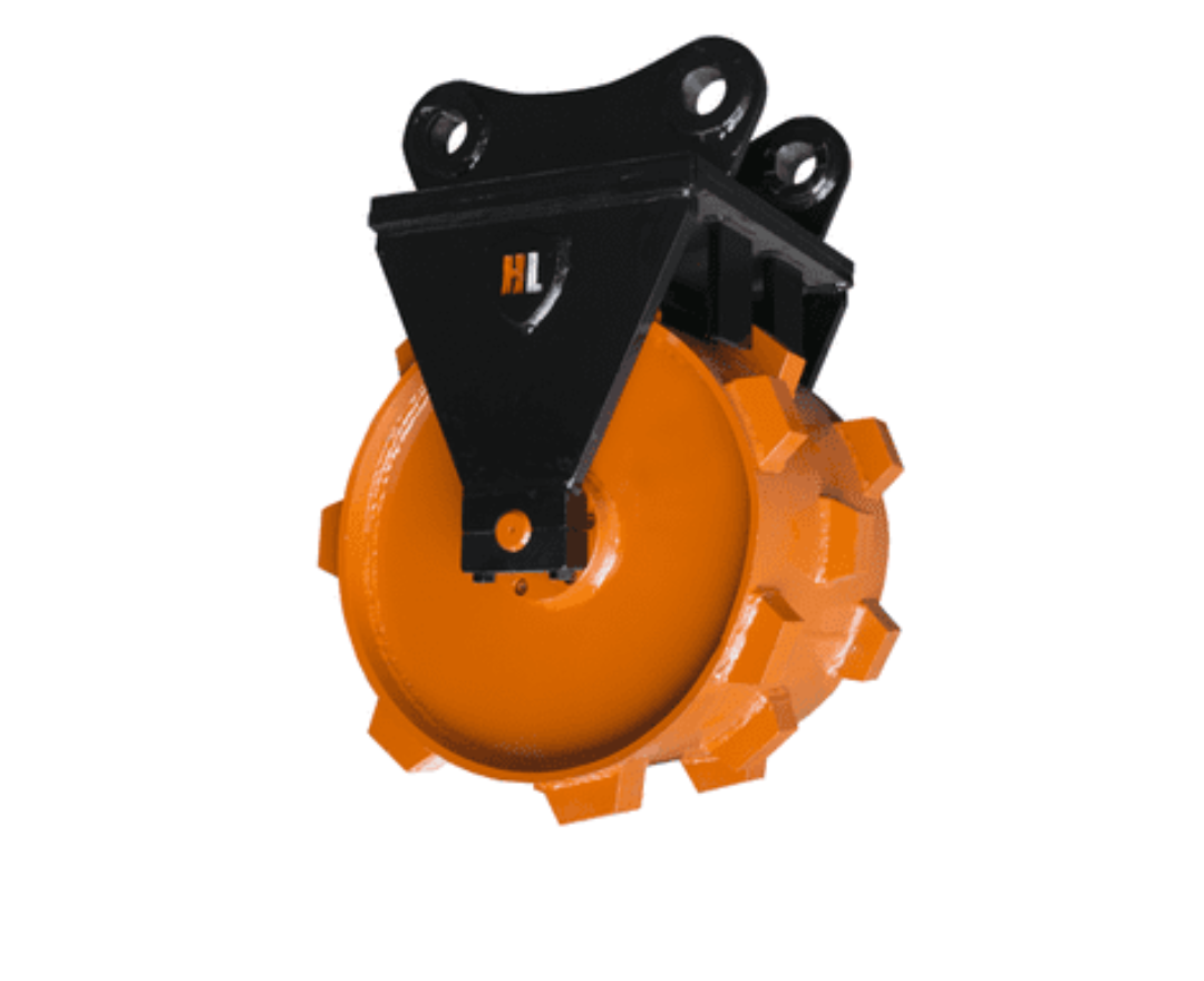

I've got one like this, doesn't vibrate just pushes down the material under the weight of the machine. Great idea but not really used it since having it, never seem to have the right sort of backfilling to do.
Bet one of these would be handy under the tilty for our work when it comes to backfill time, not having to get over the trench and rolling from anywhere would be a pop, not for road crossings and such but for trenches in gardens etc.
What width is it :)
I think you would struggle to get an even compaction rate as when you compress the next section I think you would end up loosening the section you have just done. Trench compactors are bad enough as it is for this when the foot isn't wide enough for the trench.

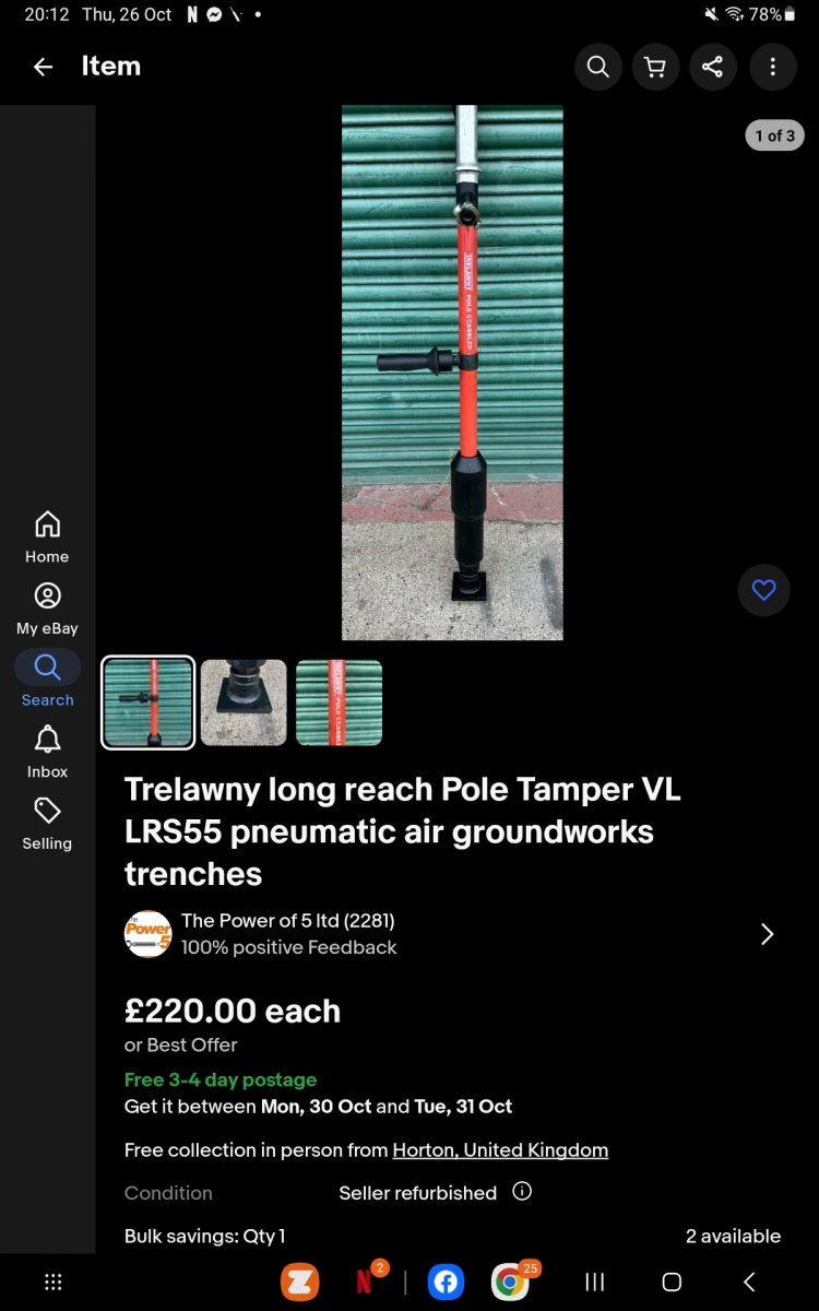

Amman do a micro trench compactor that would fit your narrow bucket but if you are trying to save cost the best bet is probably the Facebook guy tha refurbishes utility kit
What’s he called or got a link?
What width is it :)
This one is 225mm, probably comes as a wider model for larger machines.
I actually got some use out of it the other day compacting soil around trees where I couldn't get in with the tracks.

Yeah that's the one.
I had originally seen them on Instagram, couple of American firms using them on 22 tonners under tiltrotators for backfilling basements, drainage etc.
I don't think I am getting anywhere near the productivity they are with my 1.8 mini and straight hitch 😂 but for occasional use it beats getting shaken to bits with a jumping jack.
unitedtoolsnwltd-2008 is his eBay trader name, he says he doesn't have much of his inventory listed but to message about specific items if they aren't listed

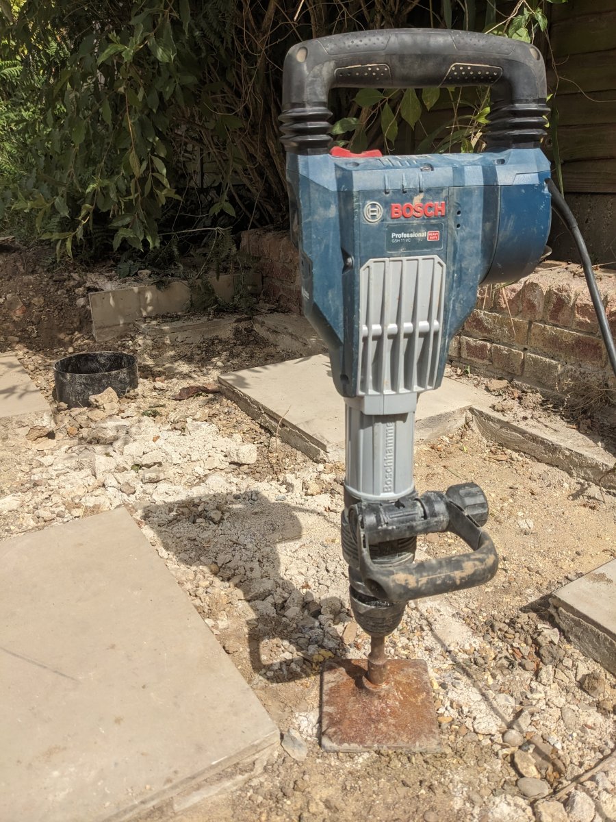

I bought off unt tools paid good money last year for dpu 2540 now fecked after about 6 or 7 jobs
