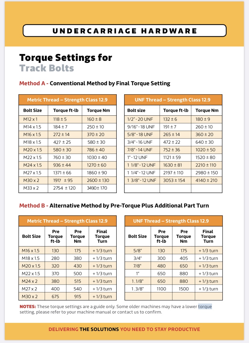

Hi, here's another maintenance whilst we're all hopefully keeping safe! Was wondering what the torque figures are for track pad bolts on a 13 tonner and procedure-are they pre tightened and then torqued up or basically do I just swing off the end of a scaffolding pole?!!!

What size bolt and thread is on your 13T? Metric or UNF
They should be torqued up, here is a guide I follow

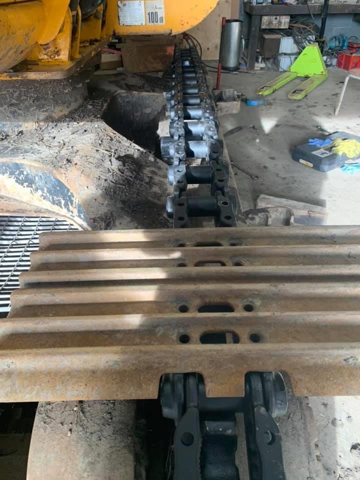

This is not good

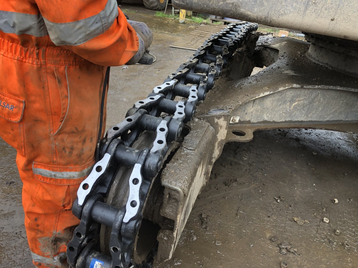

This is good
