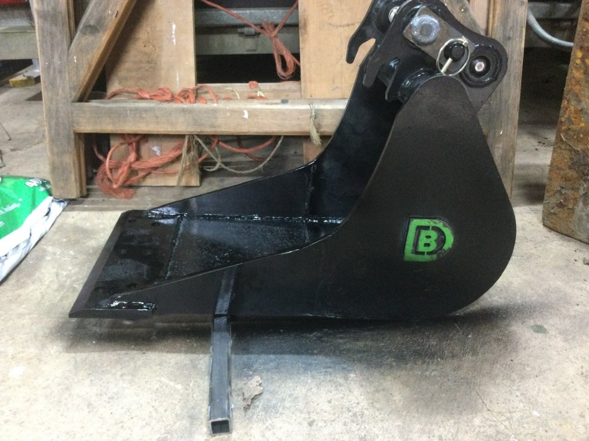

A little update on this. I have spoken to Robert Welsh (BMC) and he was very helpfull. My goal was to have a toothless bucket with a longer toe. However I wasn’t sure how long I wanted the toe to be which didn’t help the situation.
As a result I bought a 12” digging bucket from DigBits and set about modifying it.
This is what I started with.
None of my current buckets clean up against the blade, which can be annoying. As a result one of the criteria was that the modified bucket needed to reach the blade without its teeth. To achieve that I added a 10” extension to the base with tapering sides. It can now be used with or without teeth.
Whilst I appreciate that it might not be to everybody’s taste, for me it does the job as intended. It has been out and about with me and it seems to hold up fine.

Looks dead handy 👍 there very useful like that for digging under things. I welded a plate under the teeth on a 1.5 bucket that stuck out about 6 inches it was very good for underpinning
