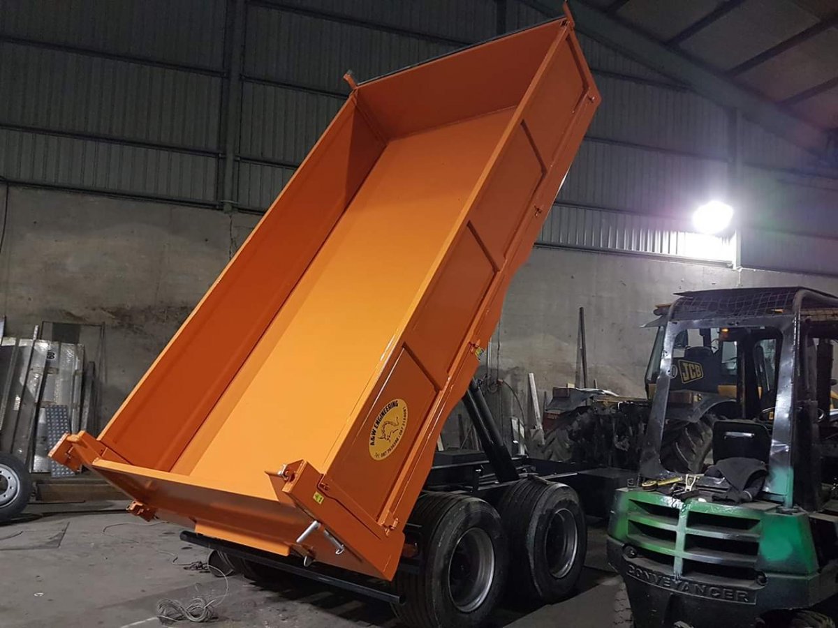

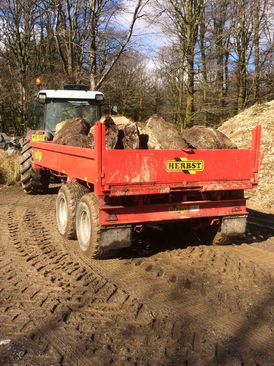

's a lovely trailer Frank ....... but tell the man what it cost![]()
can I clean out your trouser pockets, next time it's laundry day please FrankIt's just a little pocket fluff
$ 15937 USD

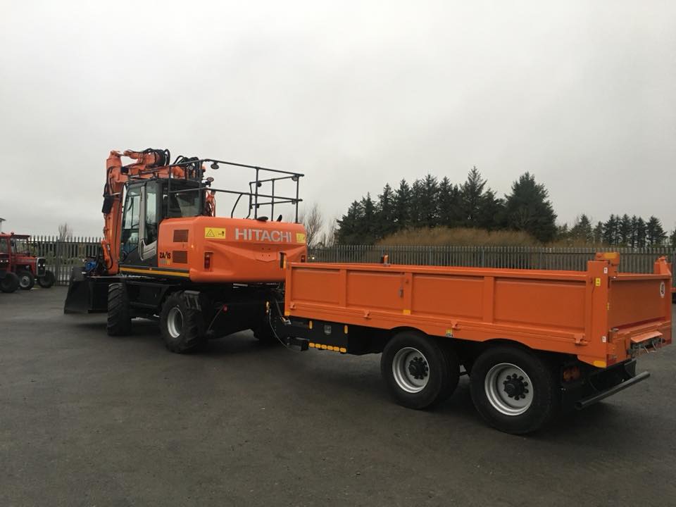

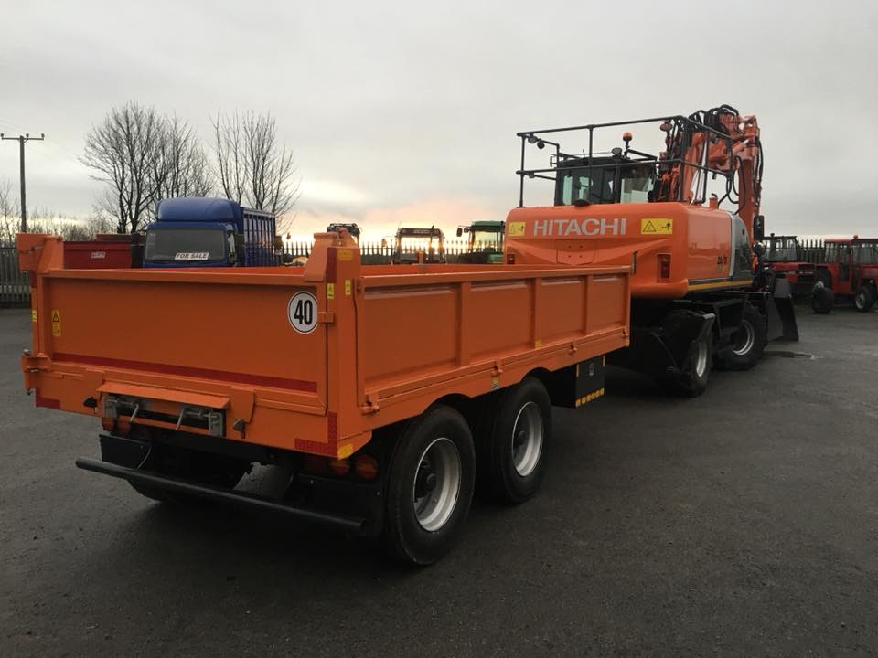

and the recipe is Aiden?We also have a very simple way of working a single acting tipping circuit of the blade or leg circuit![]()

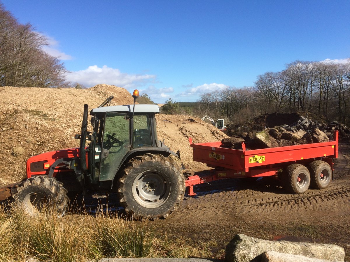

I think you should get me price on one of those mate! Looks bloody brilliant to pull with a huddigYou want one like thisif you want more info let me know
wont be hard to get one to the states
