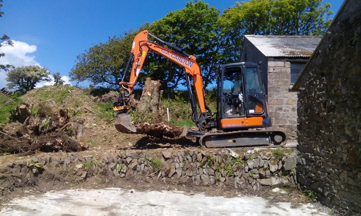

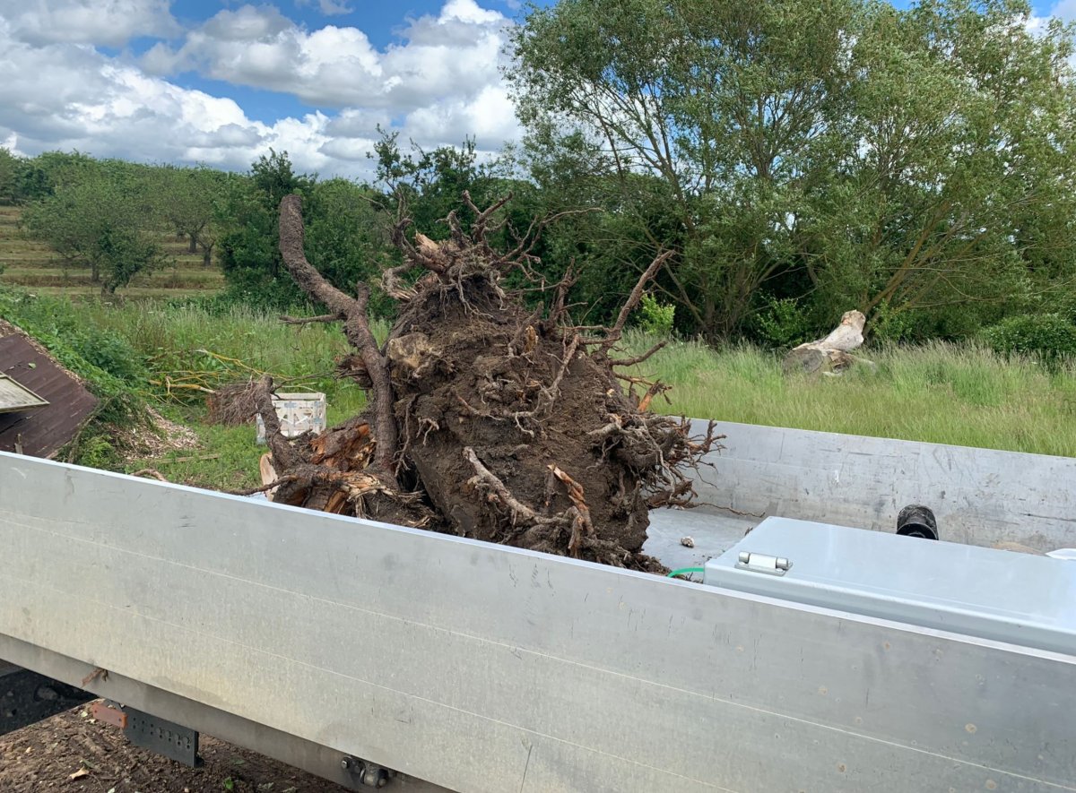

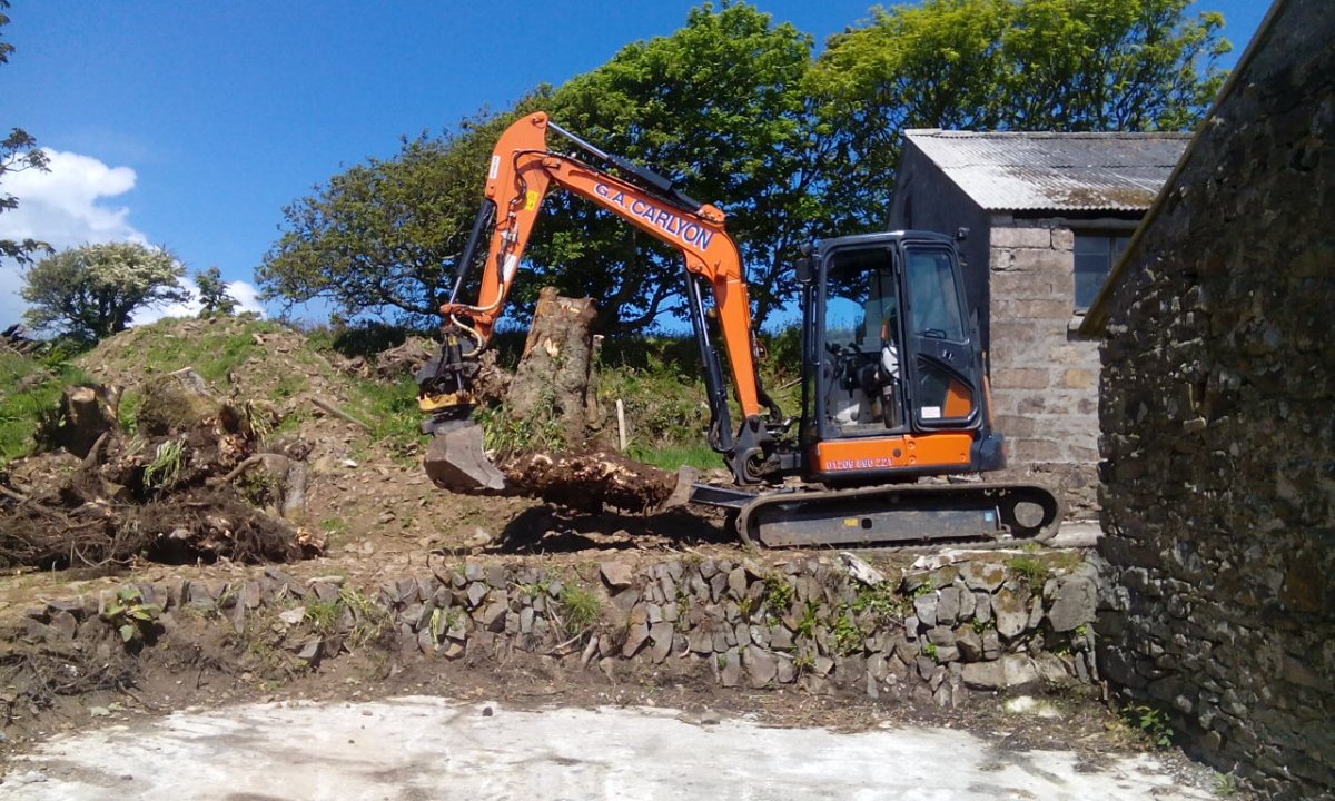

Had a ceder stump to fetch out, real pig with 12" roots.
good half a ton and the engy grab on the 3 tonner kubota lifter it sweet as.
One of those times when I could have got it on the wagon with a strap and couple planks but instead done in a couple mins while sitting down.
I use that grab all the time now and when on site without the machine faffing about with straps to lift on our 5 tonner seems to annoy the piss out of me....
