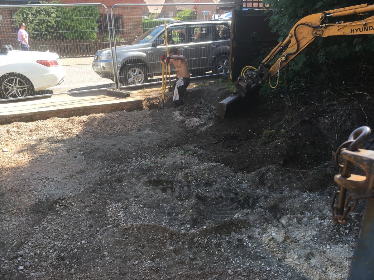

Not on a 1.7t I wouldn't. But I bloody love my tilt hitch. Used it today for just five minutes, but it saved making so much mess otherwise. Glad its on a proportional rocker though, would never go back to a pedal.
If I was running a tiltrotator on a 2.7t machine, I'd spec the machine from the factory with double proportional rocker auxillaries. Not expensive, and I can't see that you'd be running much else under a 2.7t that would require full setup?
