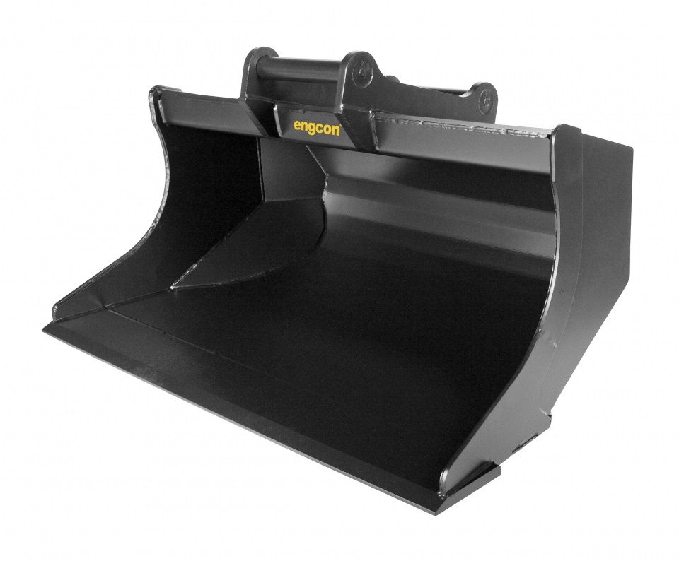

Then there is the grading bucket
Chamfered corners from the bottom up to the ceiling to avoid “colliding” with house walls and other objects that can potentially be damaged by the rotating bucket. Conical form for easier filling and an adapted angle of 16 degrees between mounting and bottom to more easily rotate the bucket without losing the material being moved. Don't buy a tilty without one.

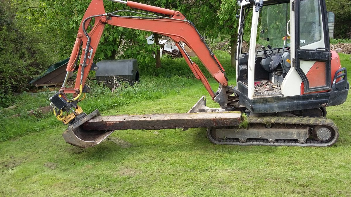

Have to give a big thumbs up to what Robert has said. The grading bucket is an amazing piece of work. What has not been mentioned is also the way the deep throat helps in picking up things like timber in the throat.
