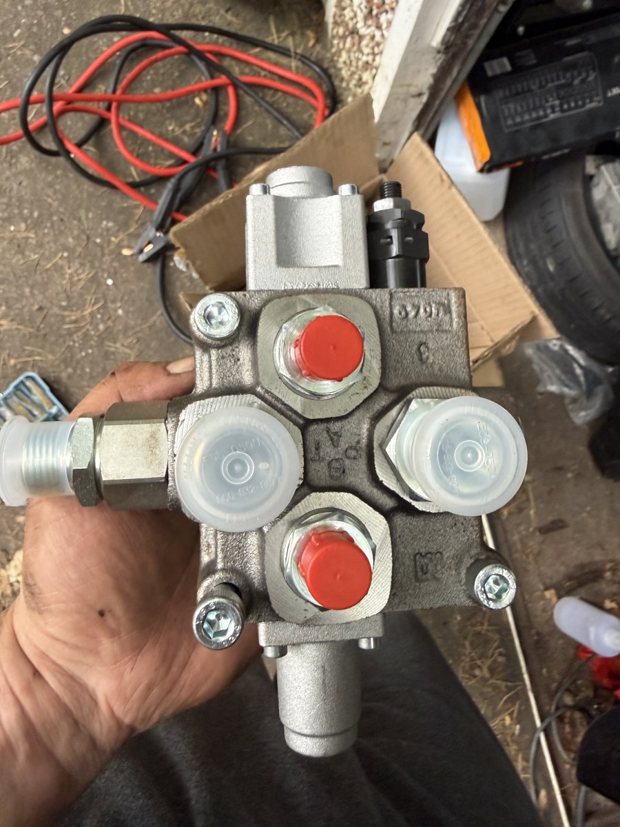

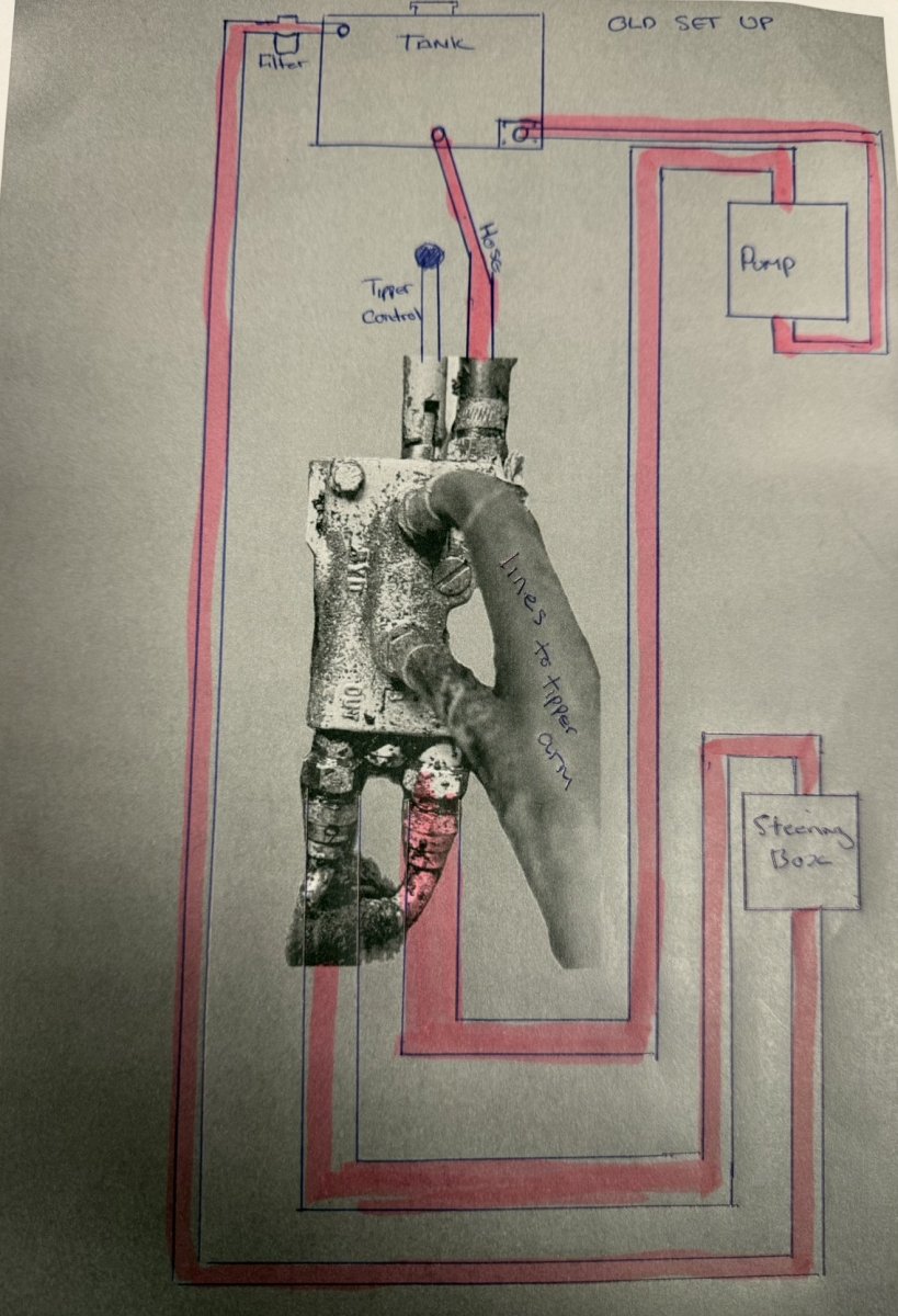

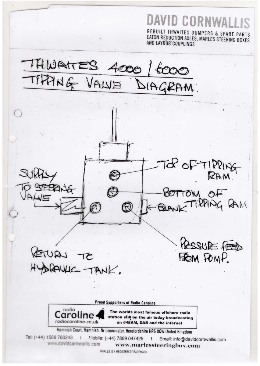

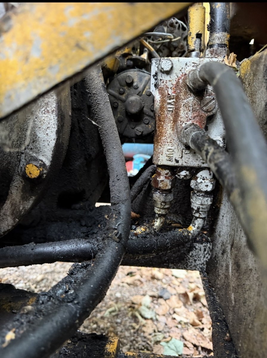

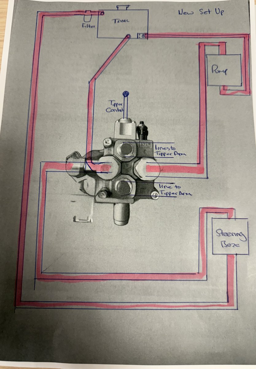

Some hydraulics help, had leaking valve on Thwaites all drive 4000 so bought a new one, has extra connection on the body that the old one doesn’t, I believe the top pipe near the tipper control arm is relief pipe, I’ve attached a sketch of the old setup, trying to figure out if it should be blank on the valve return to tank as the old setup the return is via the steering box.
All help welcome thanks in advance.
