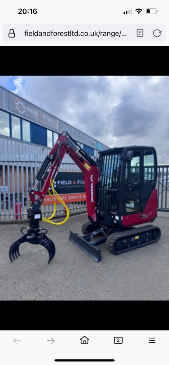

Thinking about getting a rotating grab for impending Wacker. Id want a thumb too but happy to take it off if I was doing dedicated grab work. Here's the thing- my experience with rotating grabs on small machines isn't great- I used a local tree surgeons which was on site (bobcat E26) and found the grab really quite frustrating due to having to have it quite far out to actually get any lift height on it. Fine for small stuff but trying to wrestle a big boulder was hopeless as could only lift it close it but there just wasn't any scope to lift it because of the stack height. Anyone else running one on a circa 2 ton machine- I like the idea of it for walling but not sure I will actually like it in practice.
No, it will be especially hopeless on a 2t with ‘uk standard’ stupidly long dipper for the reasons you mention. Mine is bearable on the e19 because I specced short dipper and made sure to optimise the s30 hitch and top bracket.

Thanks Doobin. I've studied that same picture too and deduced that it wouldnt be suitable for me in that guise. I did think Wacker ET20 with VDS (adds 3 inch lift height) an S30 hitch etc but still reckon it won't be that far off the ground lift wise. Wacker have a non VDS with twin aux and shorter dipper which they say is standard European spec assumedly as many will be running powertilts or tilties. Trouble is I won't be so the short dipper is going to be a pig for grading envelope- at least the 2 ton Volvo I tried was with the short dipper.
