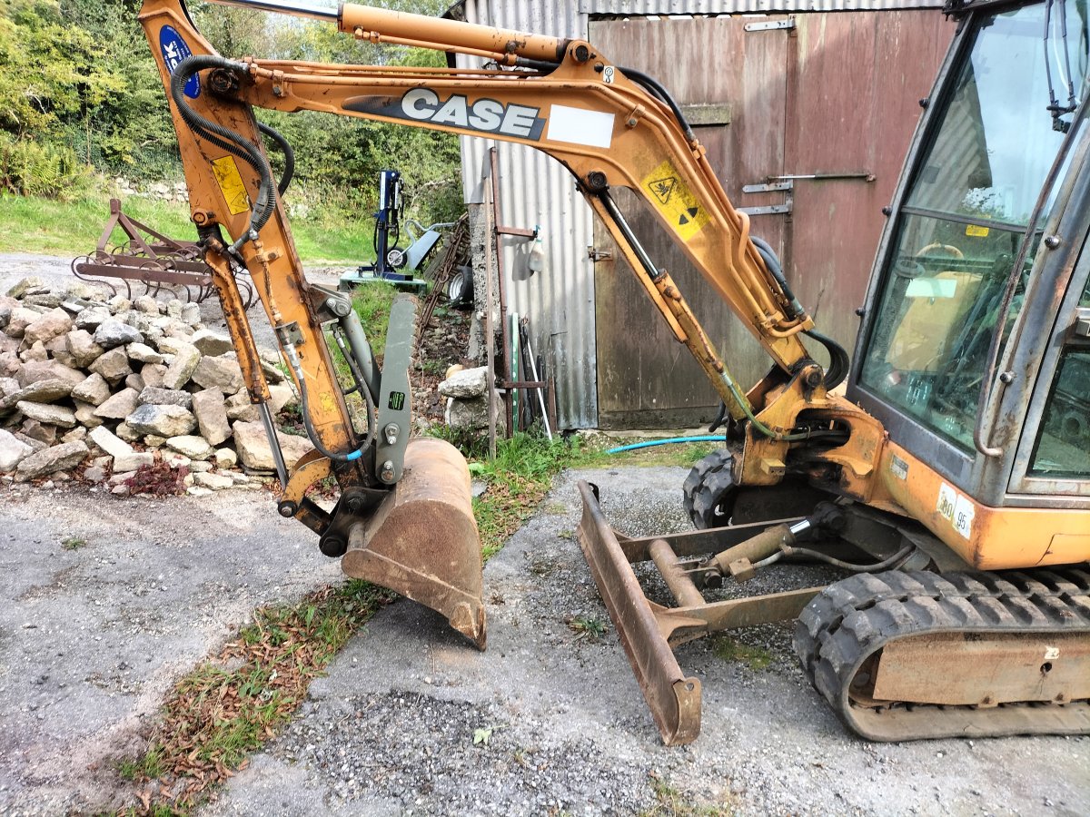

Must be a tiny dipper though. Just looking at my 1.8t thumb which my dad put on his old case. Surprised that won't fit on almost any small digger really

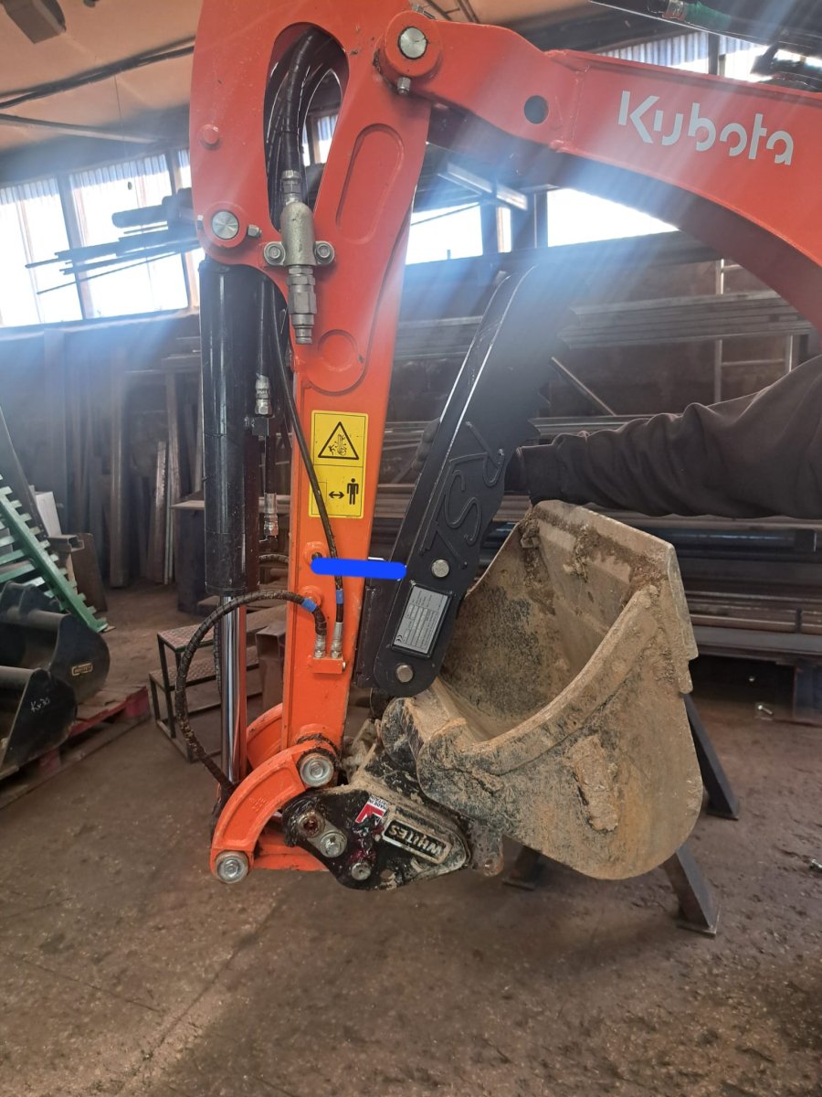

Steve Blackdog

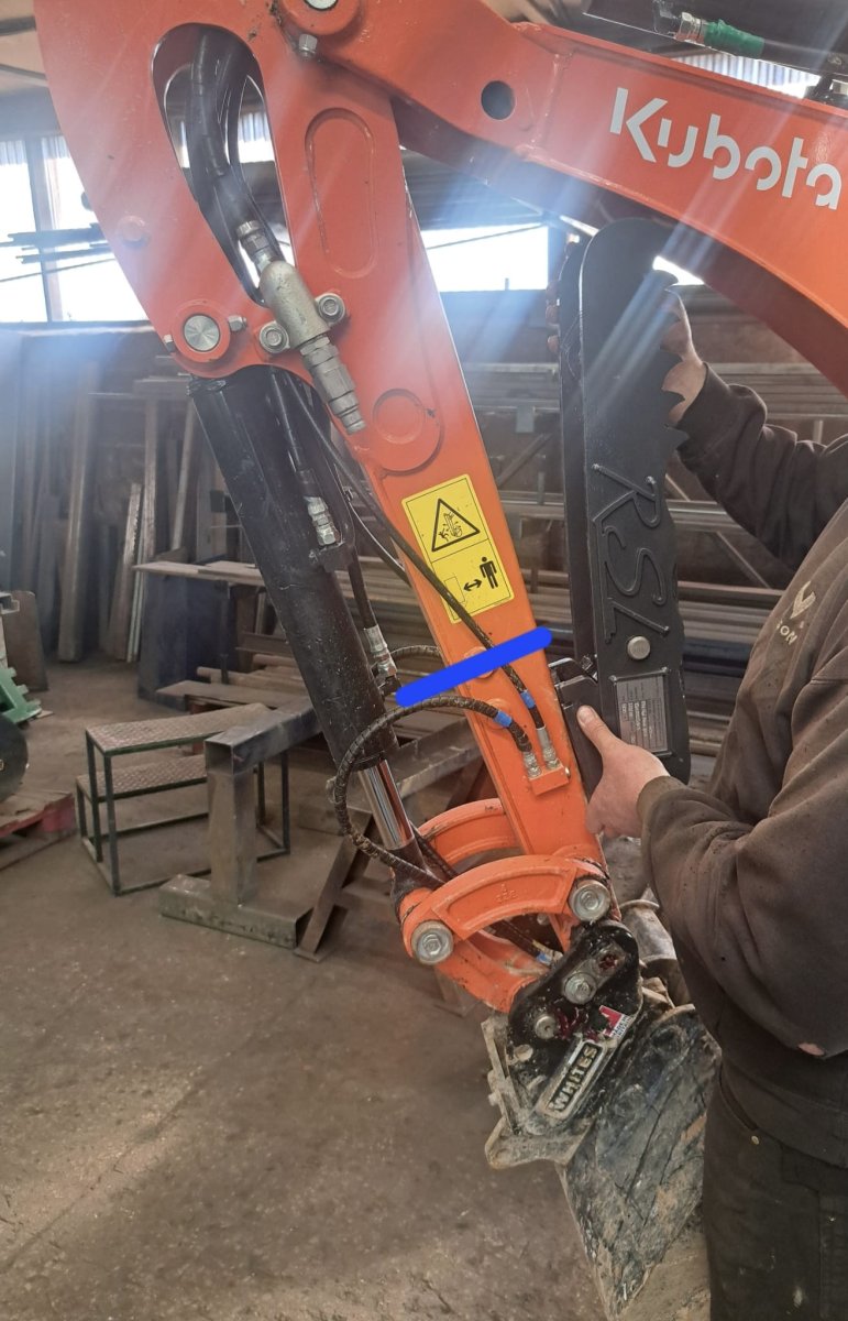

You’ve only got 670mm between the hitch and the boom. Add the bucket, when crowned, you don’t have much room at all. The thumb is 600.
