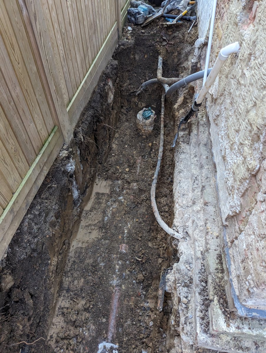

Spent most of the day battling this poxy old clay pipe surrounded by concrete with gas, water and electric right next to it...
...finally got it all done then realised I need the chamber further forward so got to take it all apart tomorrow. Twat

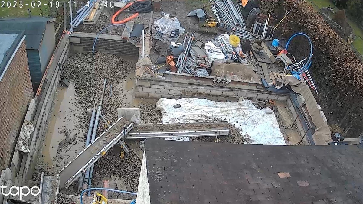

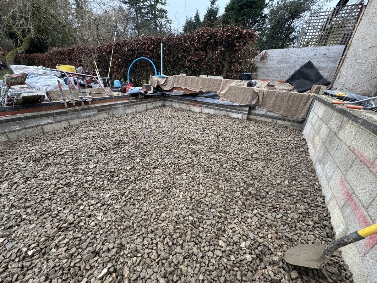

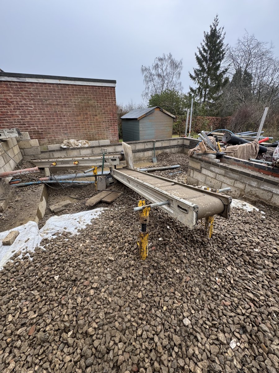

Playing with conveyors getting 16 ton of some recycled free draining fill in to start filling to slab level.
Cable drum supports working well, makes moving it across levels etc on your own easy but at 67kg a conveyor they’re not fun on your own wrestling them into position
CCTV on phone handy to monitor the pile at end I couldn’t see lol
How’s your mate getting on with the roofing? Has he asked for his job back yet?!
Definitely... people don't realise groundworks is easy work by comparison to some trades
Yeah and we aren’t really full time site bashing Groundworkers, we do a fair bit of building and stone work etc interesting mix of stuff bore me to death doing same stuff everyday
Also invest in stuff like conveyors to make tasks easier and quicker than ferrying it with dumper tipping it over level change then messing around moving it again etc
Surprised you haven’t gone beam and block with that build up? Not my favourite way of doing it mind!
