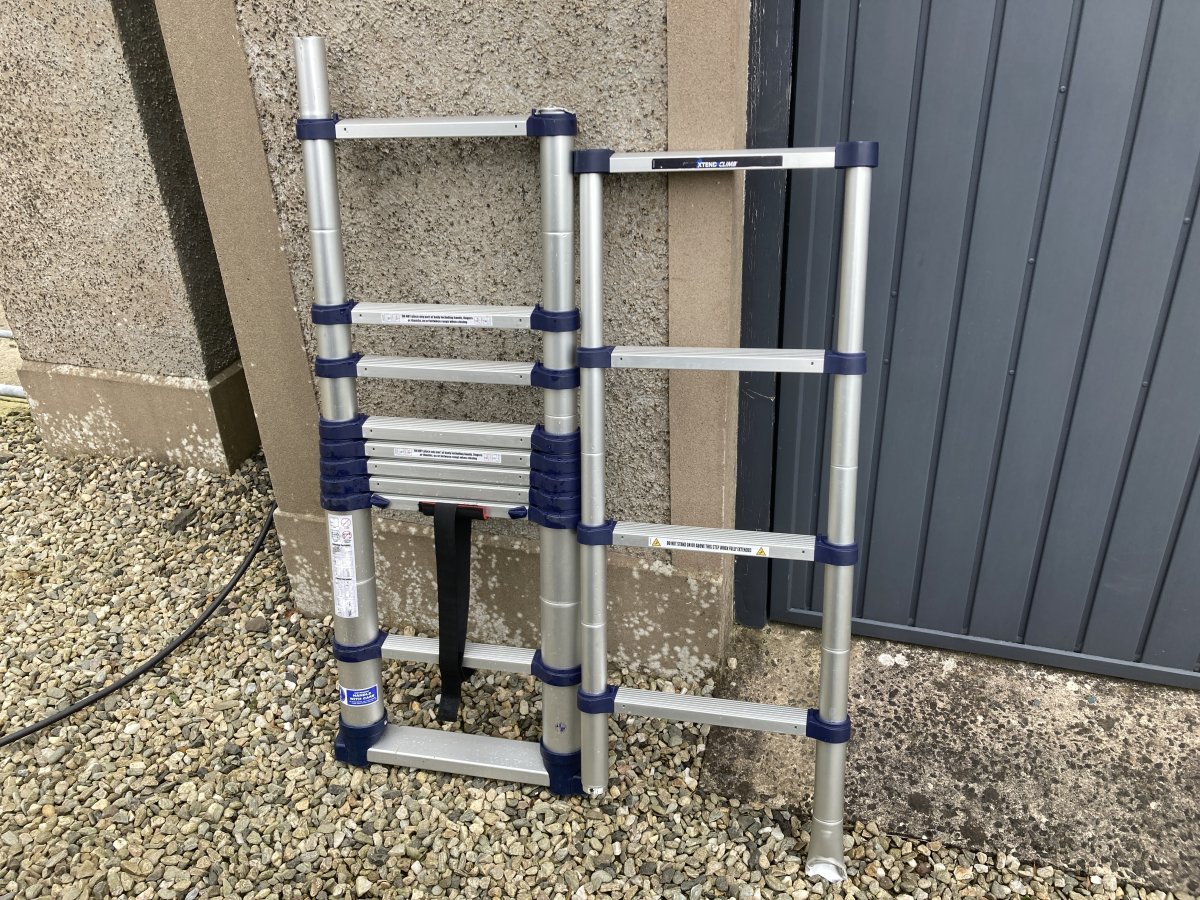

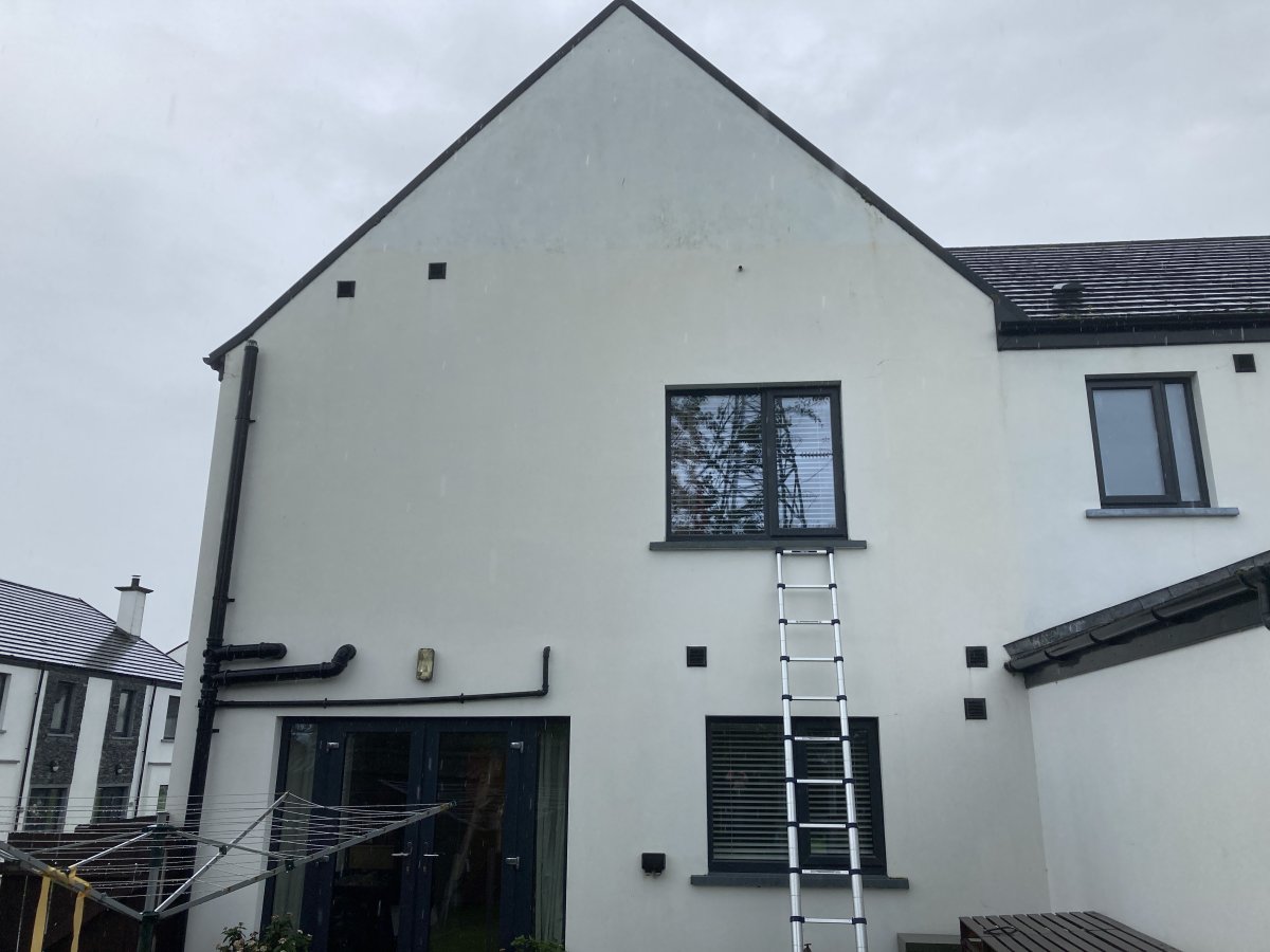

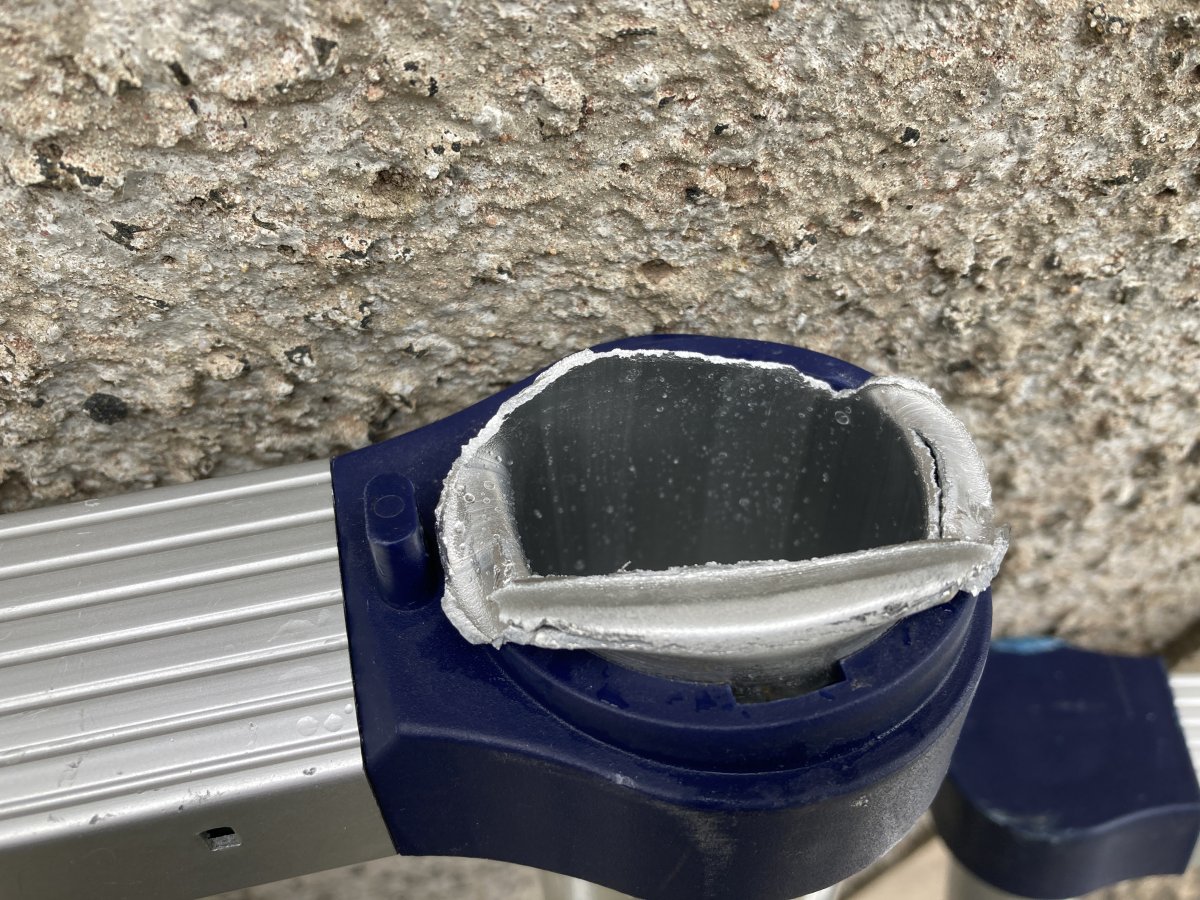

I'm up and down ladders for surveying almost every other day. Usually like a rat up a drainpipe, but I've become a bit more circumspect since I nearly came a cropper last September.
This is the last picture taken just before the incident. I was tap testing for debonded render and after this pic moved the ladder to the left over the patio doors.

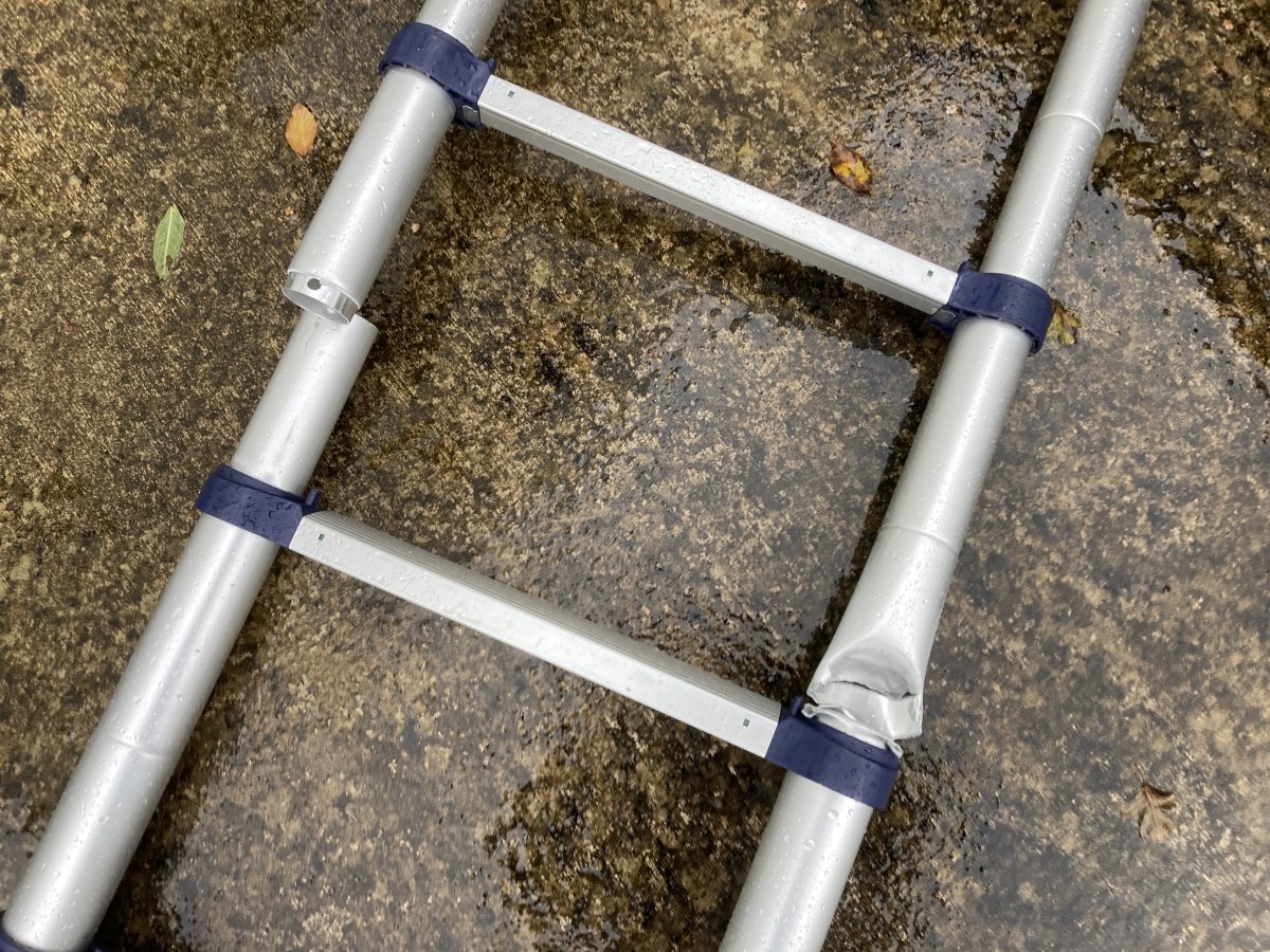

I was three rungs off the top and just starting on my way down. Happened to look down (which I don't usually do), just to see the left stile shear on a compression ring. All weight now transferred onto the right hand stile, it buckled like a bean tin and all of a sudden I was a passenger sliding down the wall on a now hinged ladder. Rode it down and landed hard on my right ankle, but managed to roll off it and get back upright.
The lady in the house got a right eyeful watching me drop out of the sky in front of her patio doors.

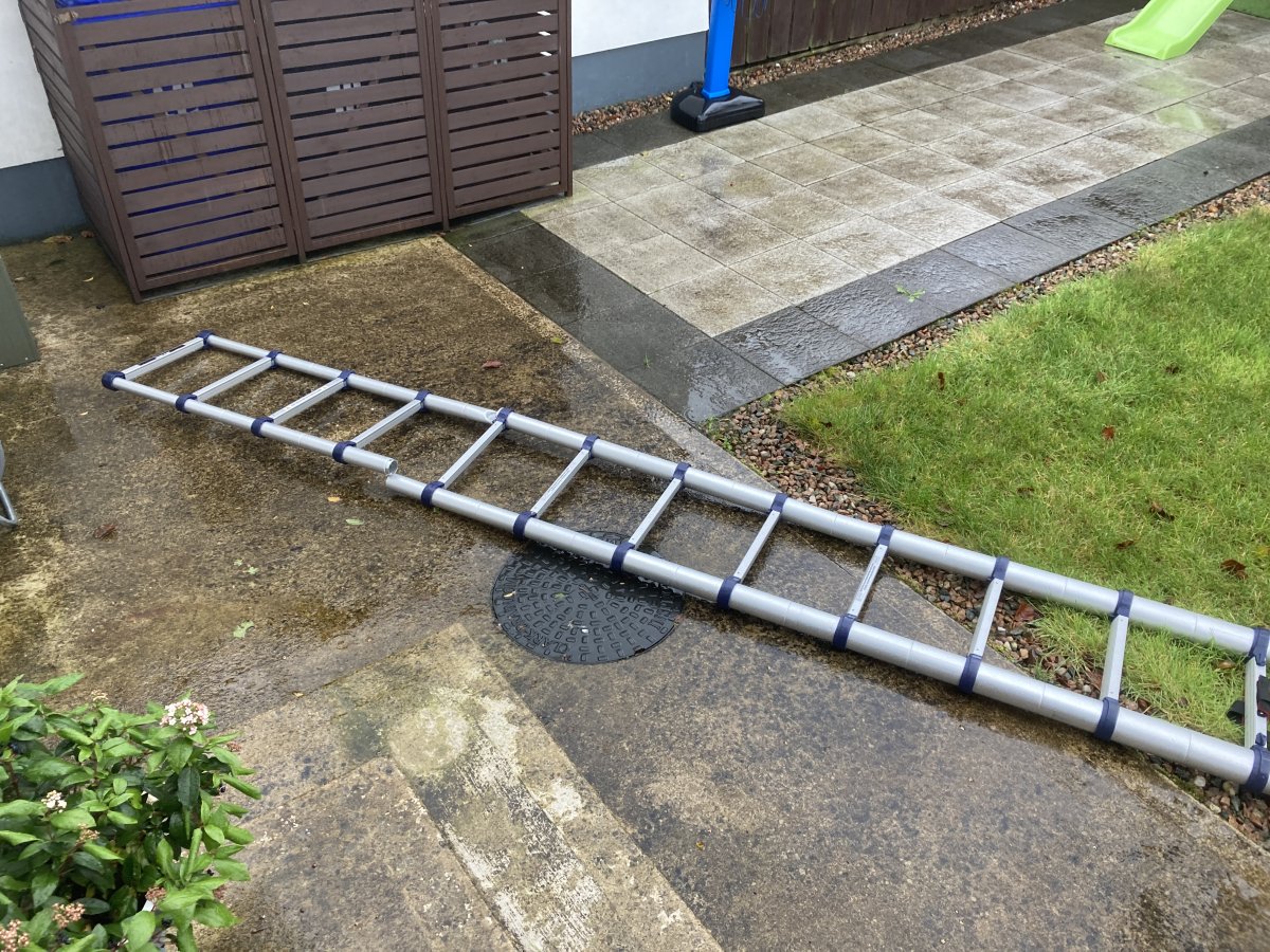

This was the state of the ladder in the immediate aftermath.
You can see the sheared left hand stile and the collapsed right hand
And this is the sorry state when I got it home.

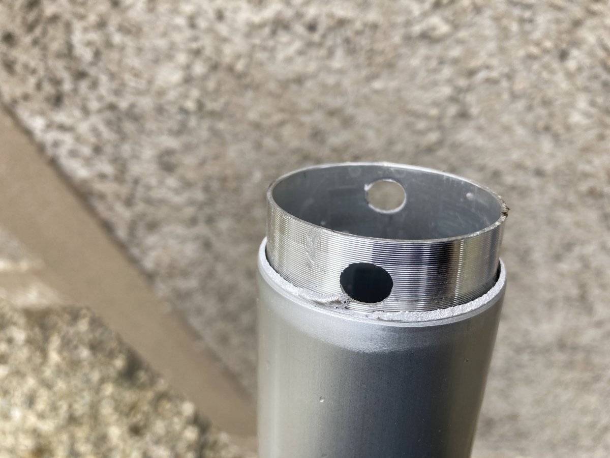

Strangest place for a shear. It has this internal ring for the telescopic mechanism which is located by a ring rolled lip on the outer wall.
The aluminium has stress failed on this rolled ring. Ladder had just had its annual assessment the month before and clean bill of health. Absolutely no evidence of a problem before it occurred.
The right hand side just couldn't cope with 96kgs and just buckled.
7mths on, I'm still getting twinges in my lower back, it locks up when I rise in the morning, or get out of a chair, but I'm just grateful to have walked away with nothing worse.
very lucky Boyo ... have been considering one of those telescopy efforts for our loft access,s, but having seen that I might just stick to what I use - small ex GPO triple extender .... zero room in the loft for conventional swing downs, but did discover these last week, so might try one ... not up there very often
Interesting...I'd never buy a cheap pair of telescopics again...mines have failed at least twice.
Mates just got a pair of the actual telesteps Swedish ...about 400 quid iirc. Feel way better built.

I used to be on ladders all the time - dodgy towers - dodgy scaffolding - dodgy homemade scaffolding - dodgy roofs - all of it. Got a set of triple 17s we used to use often. Take an effort to erect though. These days I don’t like ladders AT ALL. We use telescopic ladders daily at work (loft hatches mainly) and after my apprentice (20 stone) snapped mine we have upgraded to much better ones with pop out stabiliser beams at the bottom. Still don’t trust them though. We have tool box talks just for telescopic ladders. You have to really keep them clean and look after them.
