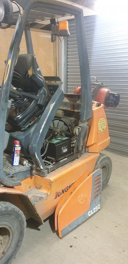

Out old 1999 FLT had some issues flagged on the annual test. New Aux hoses needed. Ignored it, then one split yesterday so did them in the afternoon. LPG pipe is a 3/8" hyd hose that needs changing, but its got weird fittings (JIC 7/8" ?) that have all the local places stumped. Might have to remake the whole section from Bottle to engine as its BSP at the engine end and I can understand that. Odd fitting on the bulkhead that I dont understand - and I am an LPG engineer as well!
IIRC although the LPG supply lines appear to be crimped hyd lines, I'm pretty sure they're teflon lined?? ... got a few LPG lines here and'd need to eyeball their 'markings', but seem to recall straight rubber lines don't 'like' LPG ... and yeh they have some fairly weird fittings - deffo JIC on some parts (IIRC all the Impco regulator/vaporiser/gas carb. bits're JIC) can't recall what's on the bottle valve end - again would need to look
This one deffo has 3/8 hyd hose on it.. but not original. Off to forklift place in a bit..
Rubber is OK once it's back to vaporised state, but as a liquid it's pretty aggressive on rubber, from memory - been a while since I read the COP for LPG installations on vehicles - every liquid line on those had to be 1mm wall copper
5/8" JIC fittings.. only had 9/16" and 3/4" in stock so will need to wait till Tuesday for delivery. The hose in the engine bay is proper LPG and probably original 1999 by appearances.
