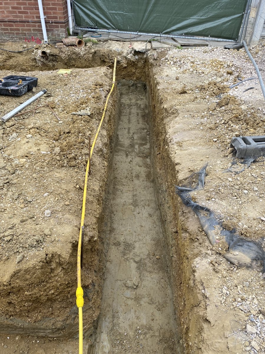

So say 4” would been acceptable over the 30’ long side?
Nowhere near 30’ long!
Are you talking falls for paving? Unless it’s monster patio you don’t worry about that on the dig- you do it on the sub base to an extent and get it right using the screed rails.

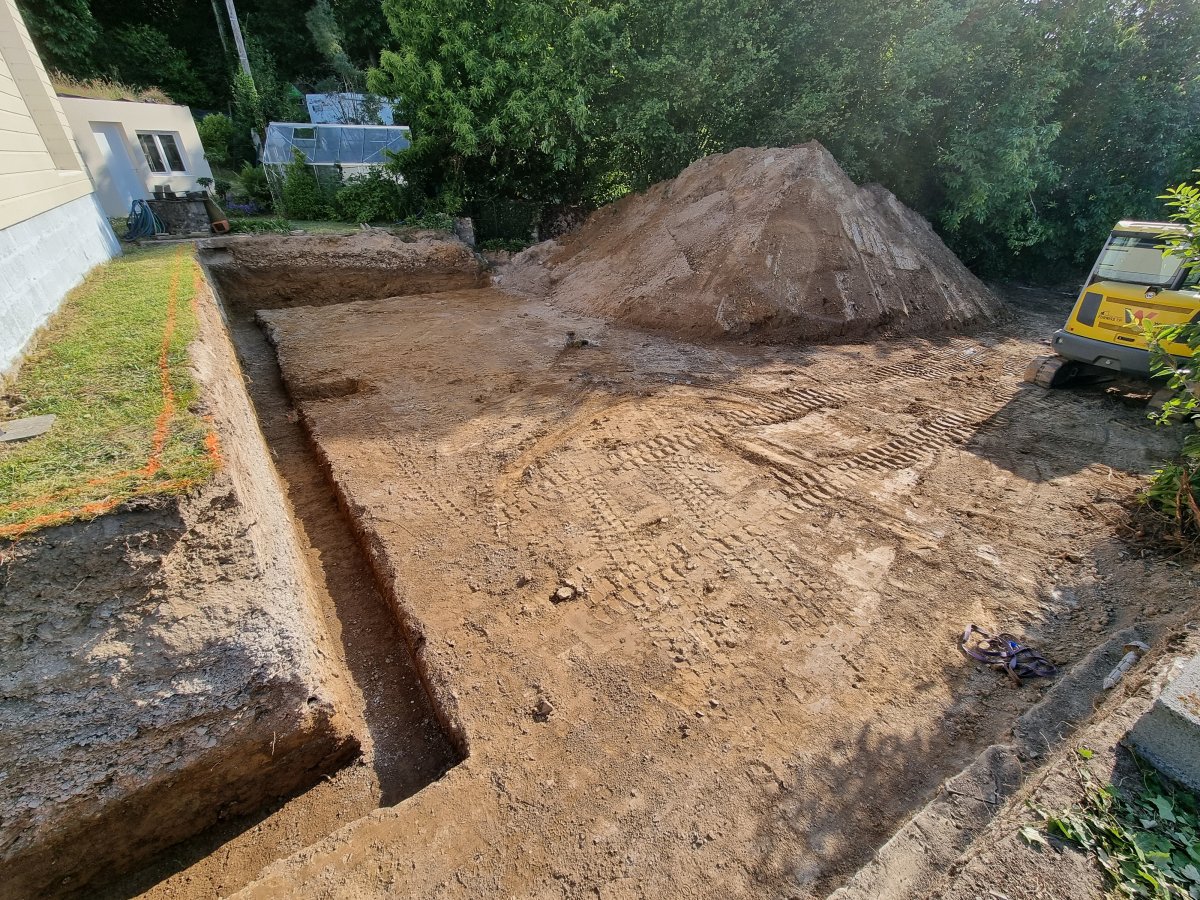

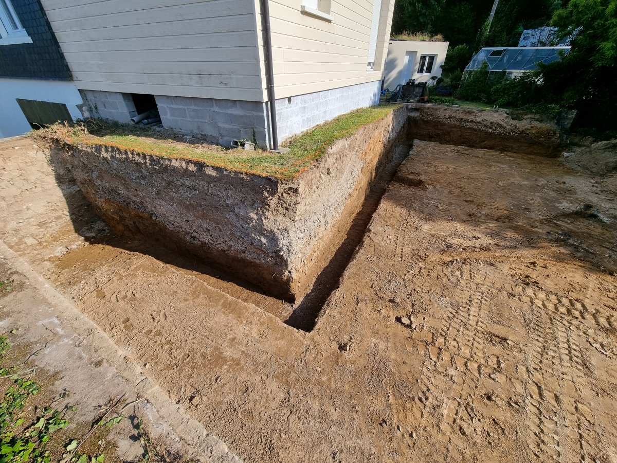

Not too shabby for five hours work on my own and five hundred quid in my pocket. leaving me time for a cheeky 170 quid dig out and muck away on the drive home.
Perfect job for the loader, especially when I had to claw it all down to the end. View attachment 48117View attachment 48118View attachment 48119View attachment 48120View attachment 48121View attachment 48122
Nice Doob :love: ... assume they're putting a retainer right around it all ? :unsure: Neighbour's fences are all gonna be in their gardy if it pees down anytime soon though :oops:
hell of a pile for the grab trucks :LOL:

Well it's three fence bays that now you mention it are probably 8'.
I don't know exactly what I mean besides some measure of flatness. Like a perfect xy plane that sits on the highest point would have no more than 4" drop to the lowest point. I follow the logic of spending time making the earth flat or spending money stoning it back up to flat. Just curious where people usually strike the balance.
Every job is different . A lot depends on the quality of material I am digging out . If it’s good stuff so I only need bare minimum type1 cover I will regulate the bearing ground to accomodate the finished level fall . Then your thin layer of type 1 is regular all the way across. If I’m digging soft ground out so I need to infill in layers to get back up to the type 1 layer then I get less fussy as I know I can get it regulated in the layers while in filling .

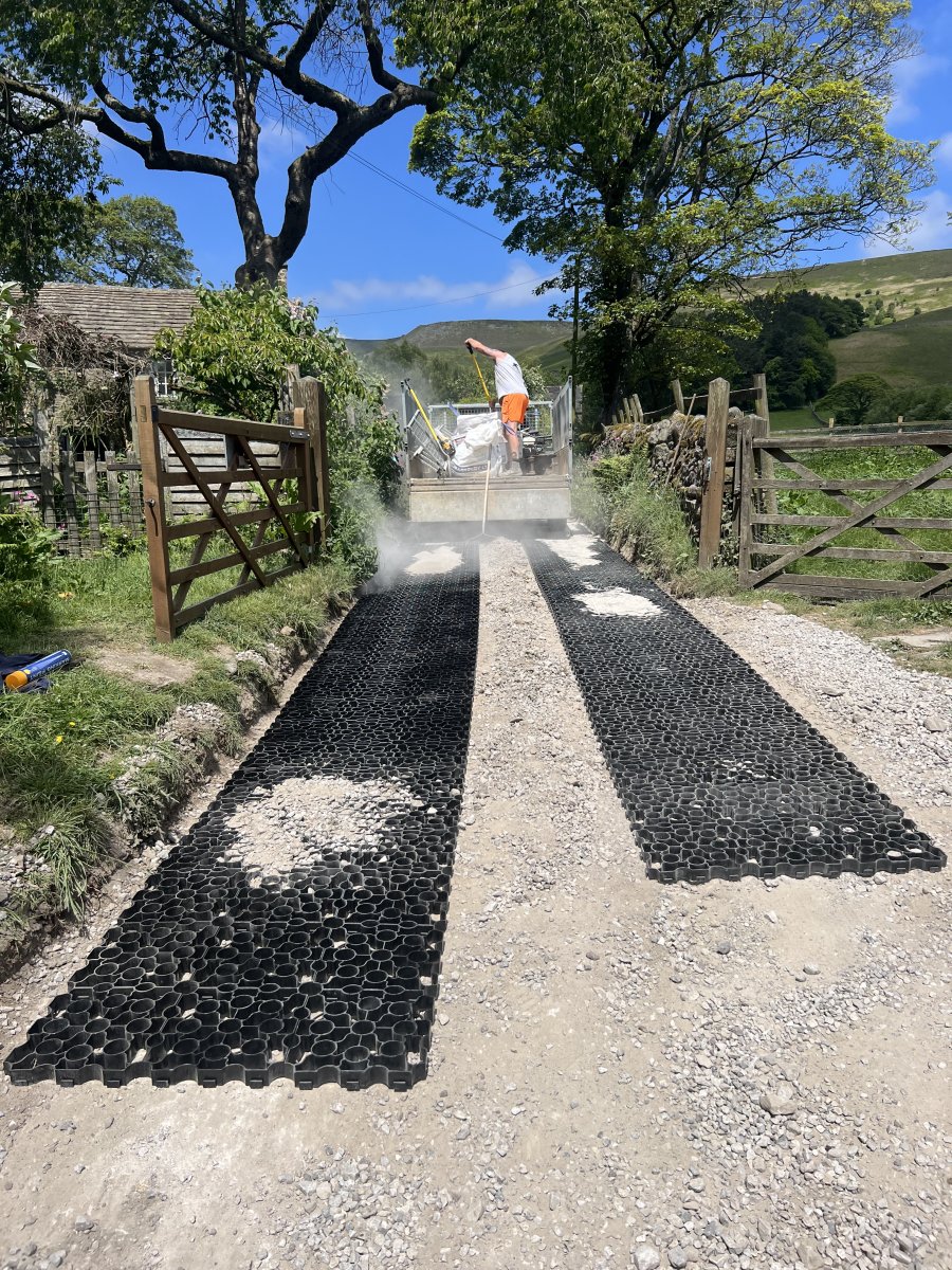

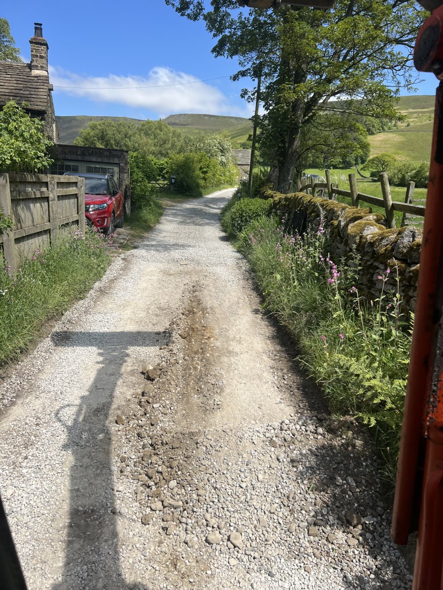

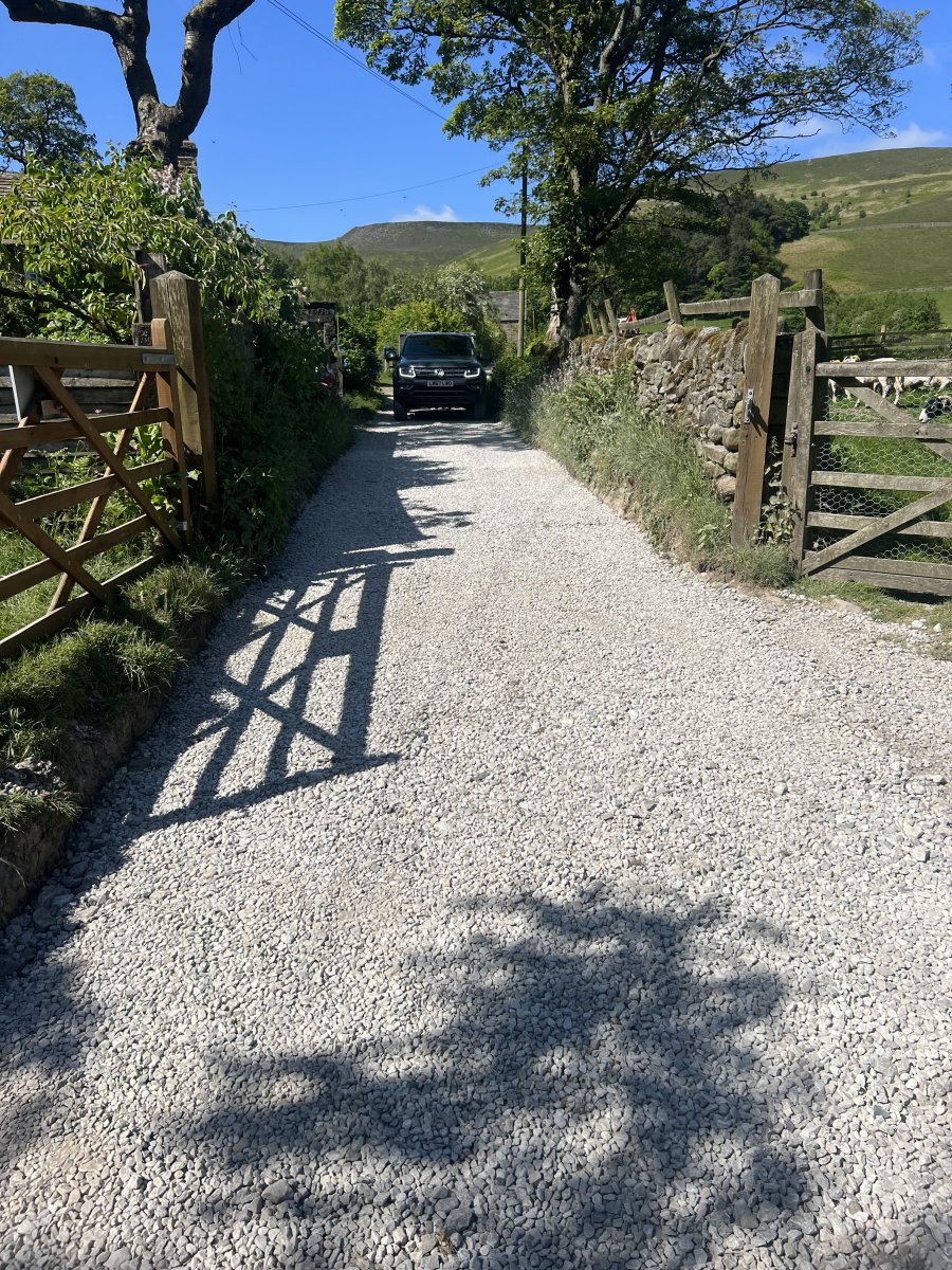

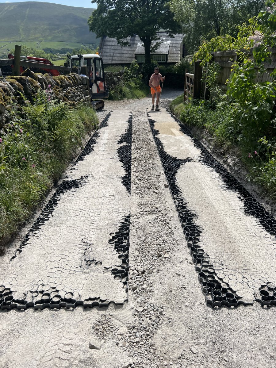

Some gravel grids after some one put 20 mm clean limestone onto existing limestone track and was moving all over and making deep
Holes cars bottom out getting stuck etc

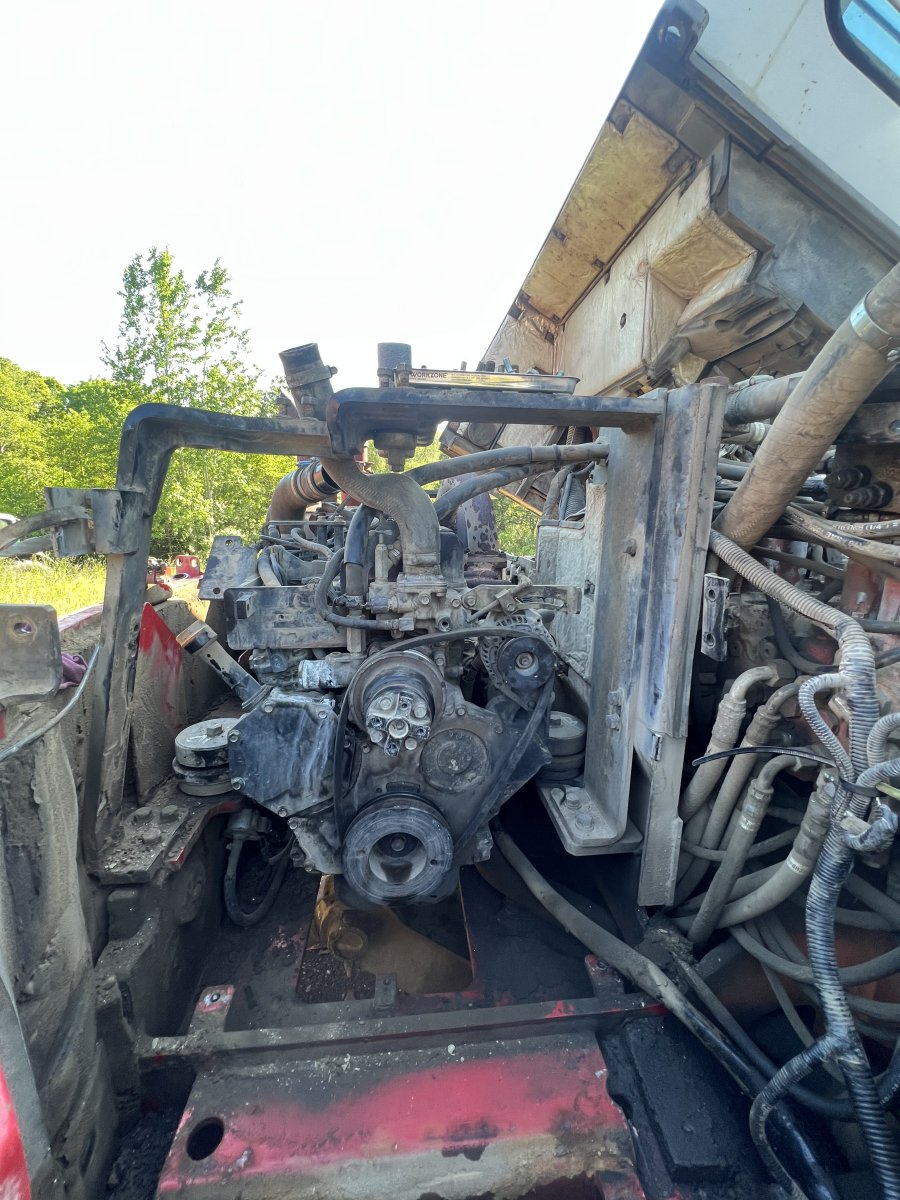

Takeuchi overheating problem getting some attention, radiator off for testing.

I always reduce using same grades as eventual falls, saves on material and muck away , and can make it easier to eye in when your stoning up.
Surely not on a ten foot wide patio where the eventual fall will be 20mm 🤣
Agree on larger areas though. It’s very satisfying looking back when using the machine mount receiver with a dual fall laser and seeing the cross fall in what you’ve dug.
In case folk wonder, I’m not a total cowboy, I do have lasers 🤣 But the niv comp is simply brilliant for pissy little jobs, especially when you want to zero inside on an existing floor level. No line of site required and no need to site the laser tripod anywhere. Come to thing if it- where would I have put it on that job? About the only option would have been a bracket on the fence
