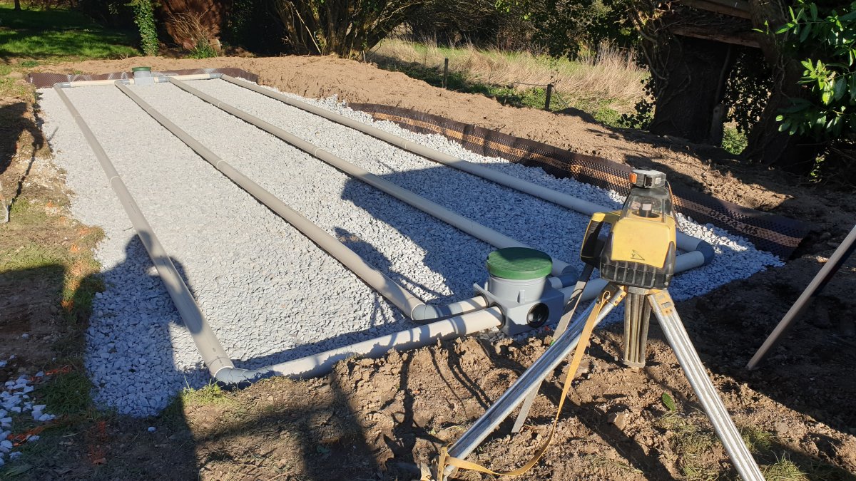

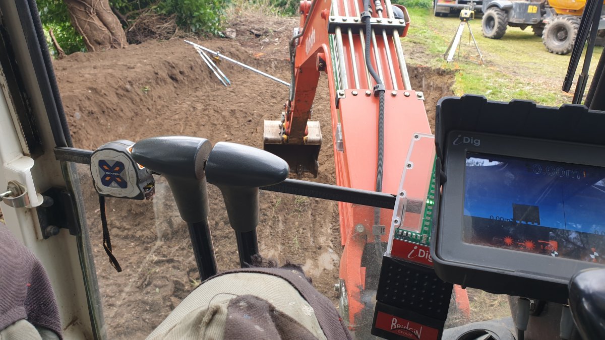

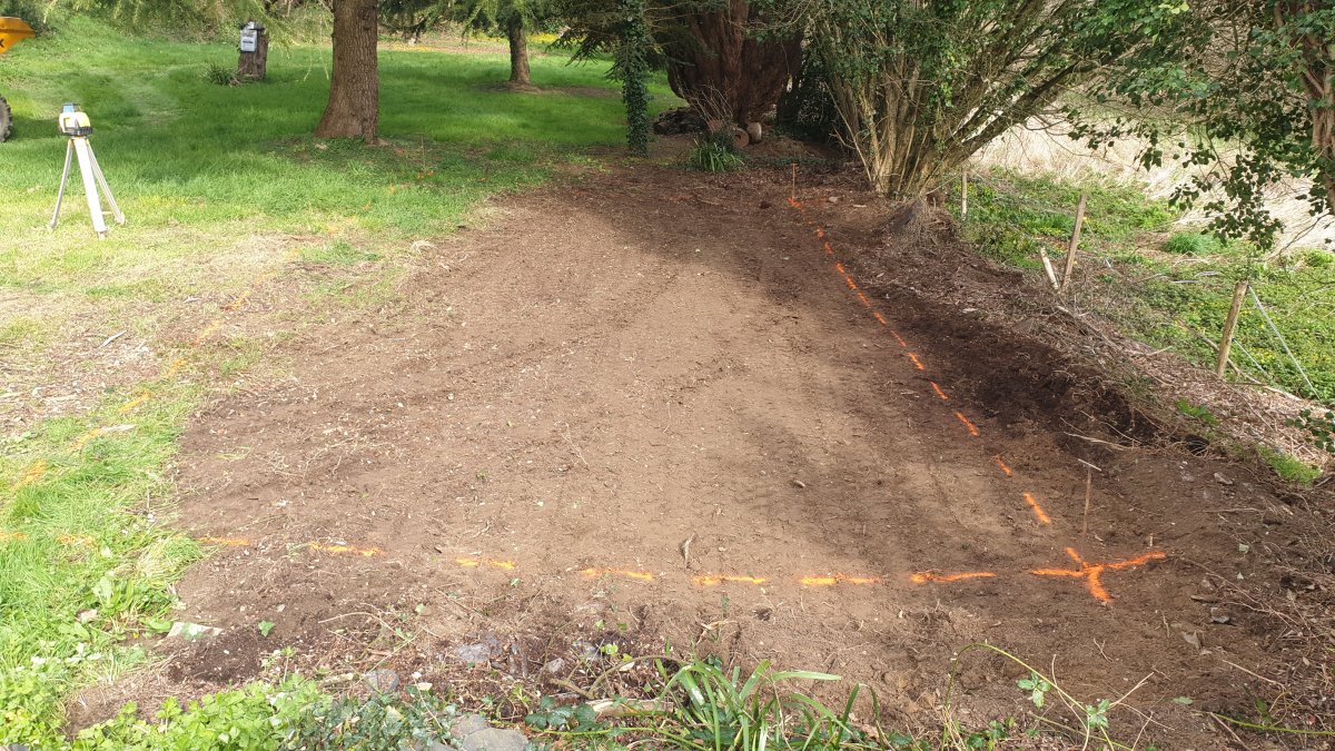

Drainage last friday - brilliant application for idig - 4m x12m drainage bed with 1% fall - put onto a sloping area so 30cm of washed stone below invert and building the surround as I went with 30cm above invert ready to retain soil cover.
All done from cab with no need to check manually
... even using the tape measure feature to make sure I have my width correct as I went.

Tidy...looks so nice n dry..👌 can only dream up here .

Ok . I can see it is a guided laser leveller of some sort.
how does it work ?
will it give you a fixed point that you can program into it ? I’m wondering this as if it can do this then I think I could use it for setting out the pad underbuildings that I am doing . Be good to get more info
how does it work ?
