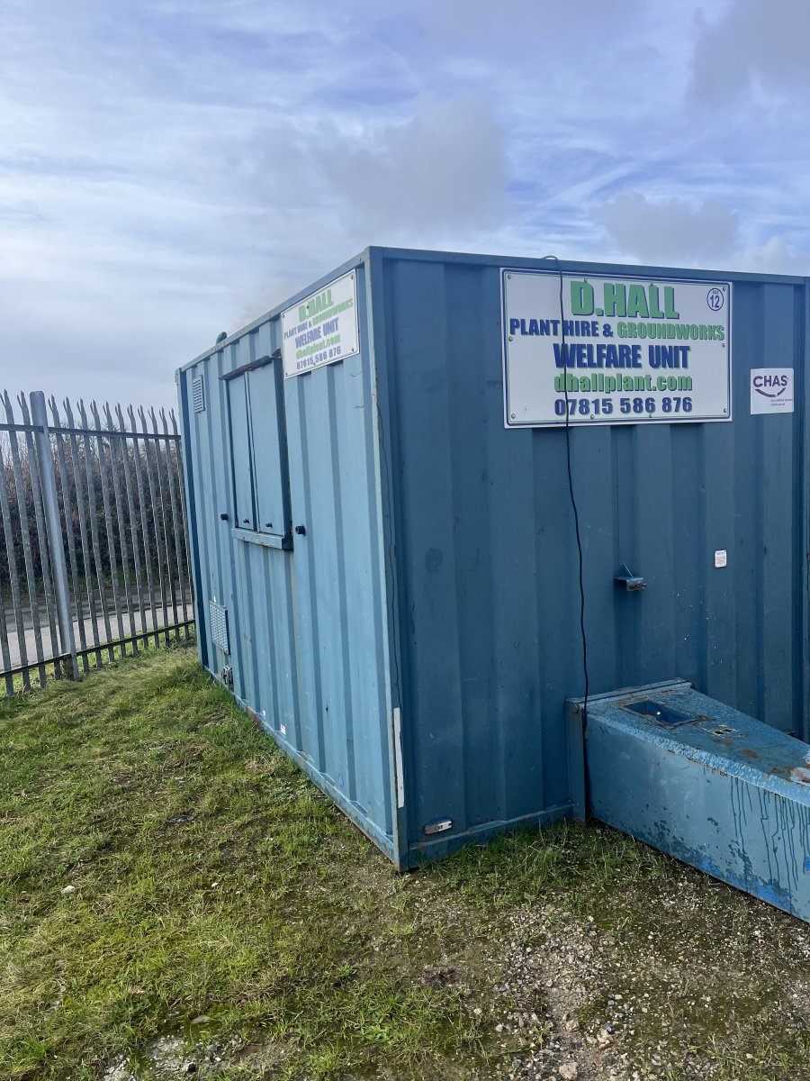

I bought my welfare unit for £5.3k + the vat this time last year and it has been such an asset!! Not the best towing when you've got all your tools etc still in it because you don't want to do x2 trips :ROFLMAO:

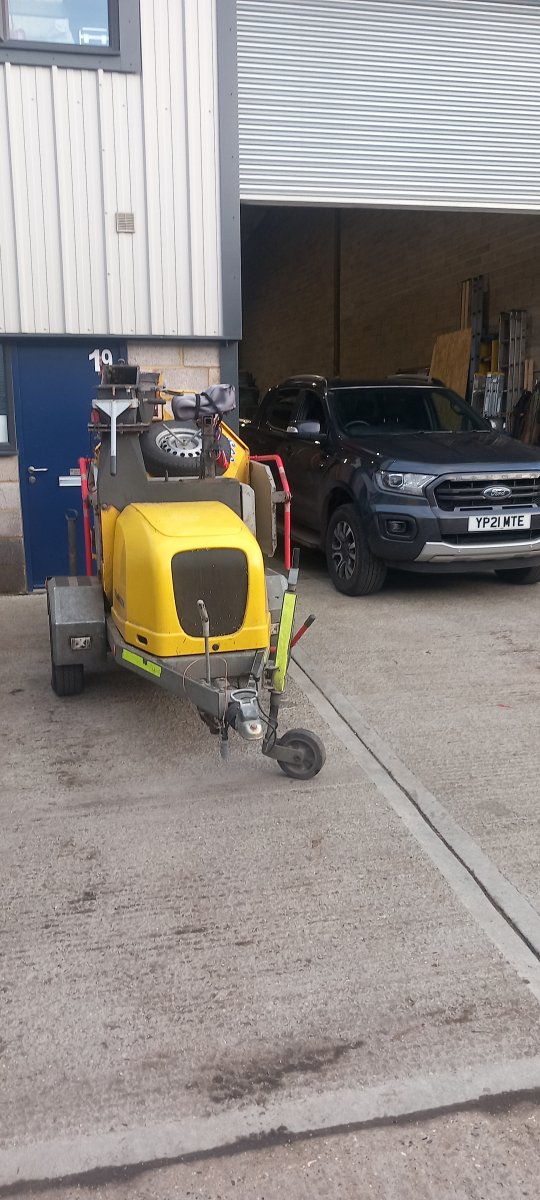

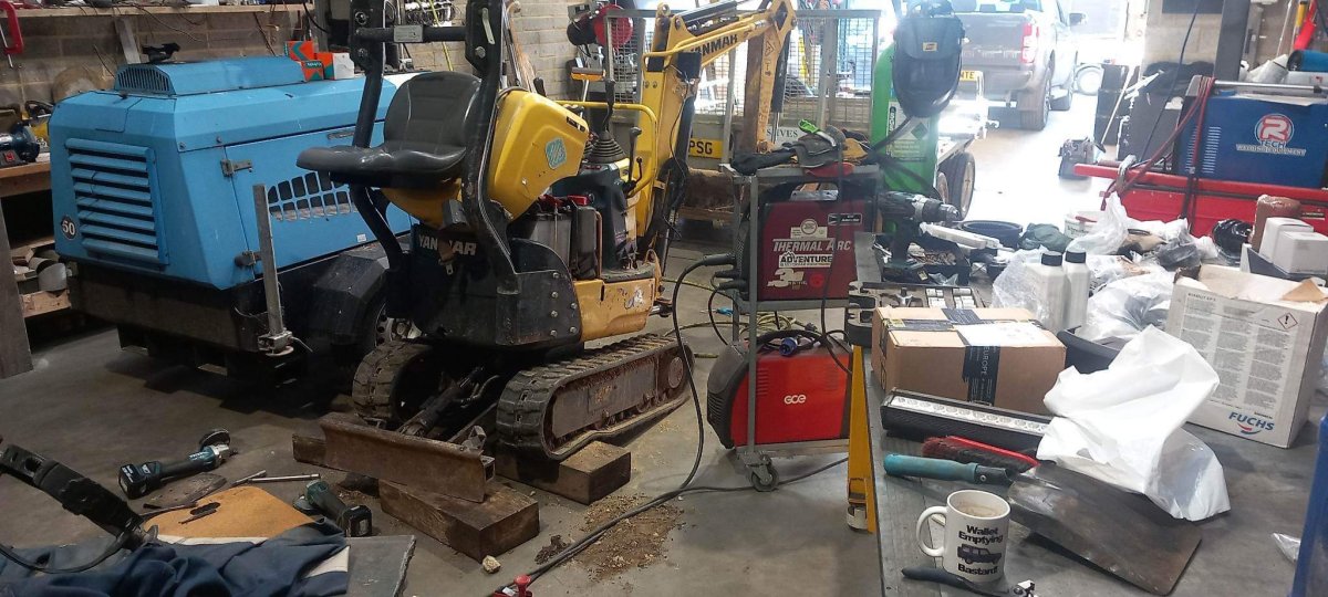

Back in the workshop today, between 2 of us we serviced the chipper and digger, turned the anvil on the chipper and cleared out the debris from 165 Christmas trees, repaired lights on 2 trailers, fitted a few new lights, gas strut, brake away cable, starter solenoid and oil change on the mini chipper, checked brakes and bearings on chipper and trailers and a couple of other bits. A good productive day👌👌

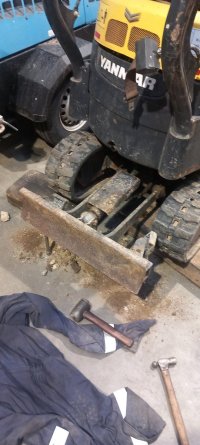

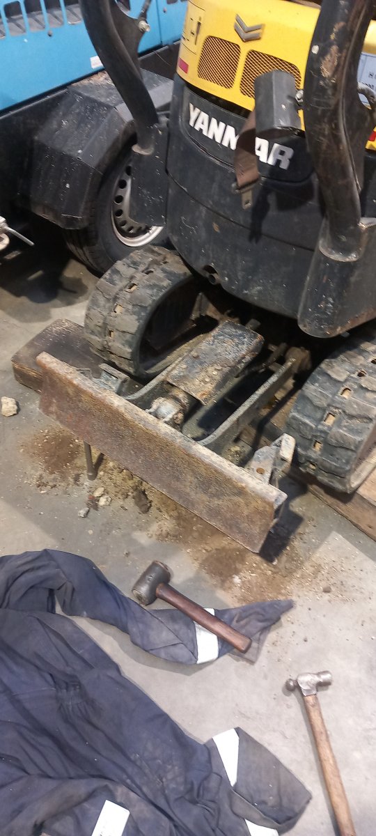

I spent quite a while freeing off the blade extensions on the digger, they've never been usable in the 14 months I've had it- not sure they've ever been used at all! 1 was easy enough, lowered the blade down so the weight was on a drift under the pin and smacked the blade with a hammer, but the other side was having none of it. In the end I cut the 'handle' off the top of the pin and built up a blob of weld on the top of the pin. The heating and cooling freed it off and it hammered straight out 👌👌👌 pretty standard stuff but I was pretty pleased that I remembered it and did it successfully 😆😆

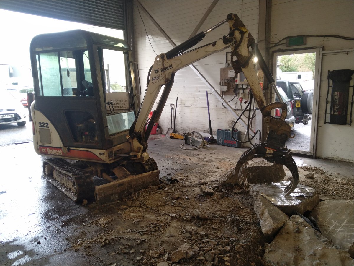

Who needs breakers 🤣💪
Nice grab. If you get a chance of an tg16, you’ll find it has around double the grip force for not a lot of extra weight. When using my tg12 when I’m used to the the tg16 it’s very noticeable- have to lift up slightly when closing around stuff on the ground for example.
