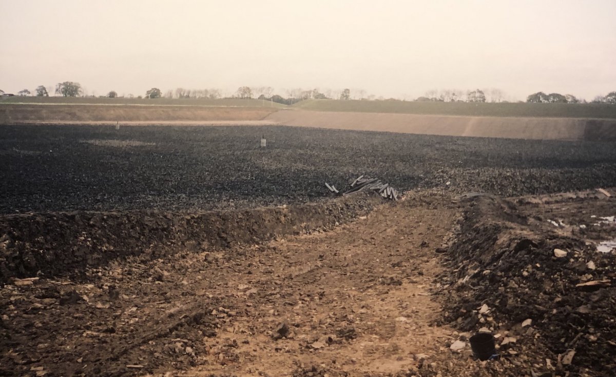

This was the back half of it when finished, as it was “clay on clay” rather than “clay on rock” the liner was the traditional “tyres”, think this cell was done with shredded tyres, rather than how it used to be done where they would all be hand balled into place and stacked in a “herring bone effect” going vertical rather than horizontal, again, this acts as a cushion and allows the leacha ( black liquid that comes out of the tip of all the waste water and de-composting foods etc) to be able to run to the bottom of the cell and then be pumped out and the gas burned off.

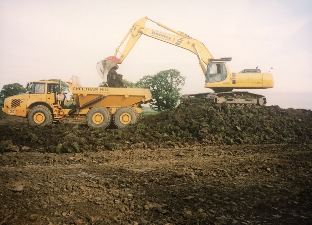

One of the new trucks from Cheetham Hill, and I think that was a new 450 at the time, it was cheap as it was around the time that they were swapping from the -6 model to the -7 model. -6 been the back of the cab slopping and the -7 been the ones we see now a days with the square cab.

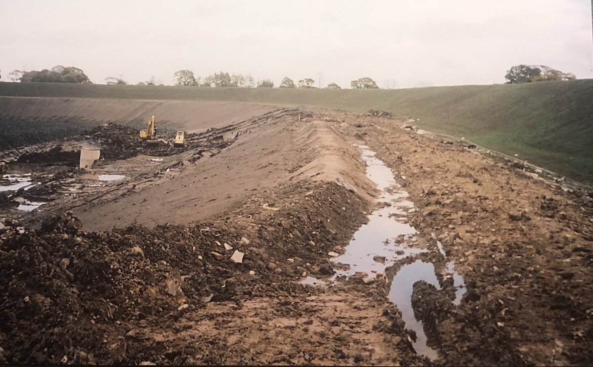

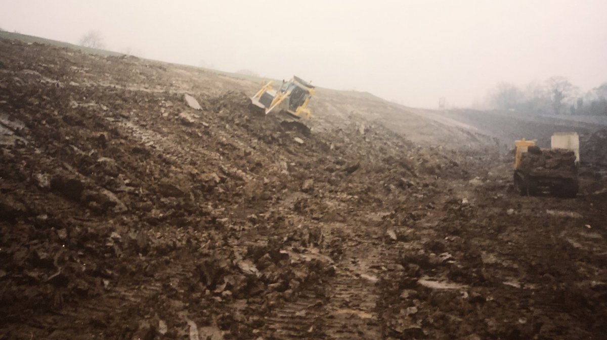

Hopefully will give it a bit of scale, the waste would get taken to approximately a metre below ground level. It would then be covered, making what is the “top of the batter” in the picture, the “toe of the batter” if that makes sense.

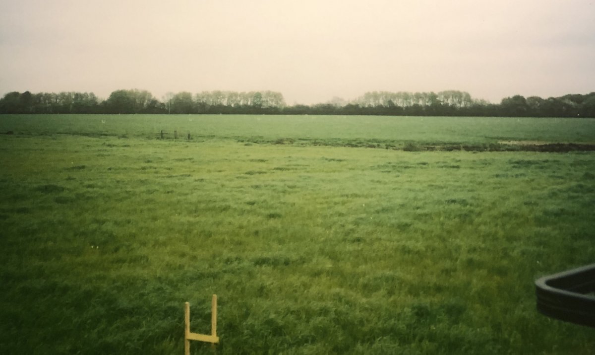

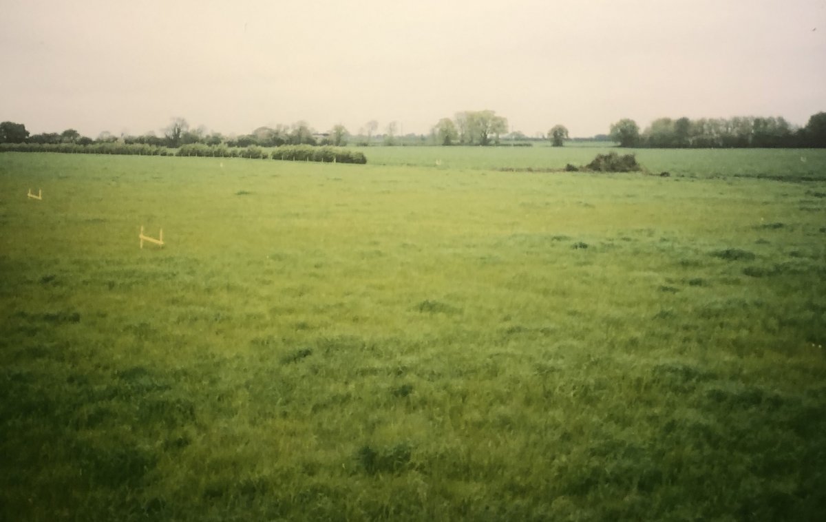

As you can see it was a fresh site😎 and a big one at that, we took out to the trees in the distance

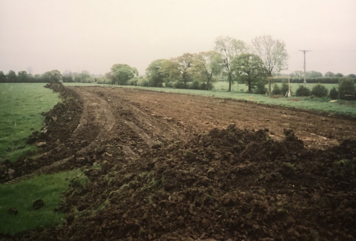

And this is was the first cut and where the bund started at the entrance, there was also a new ditch to divert and go in which went round the whole site and went in to the right of the picture.
yeh great pix ....... terrible waste of what looked to be a perfectly productive green field site though ... surely there'd have been suitable brownfield sites/old quarries/whatever that would have been better used ??:unsure:

It was an extension to the existing tip Gra and no quarries or brown field sites would be big enough to cope with the amount of waste that gets bought in from York and the surrounding areas. Going back about 18 or so years now, and things have changed in a big way. At the time it was only one of a handful of tips that were given the green light to proceed on a fresh site down to the fazing out of landfills.
