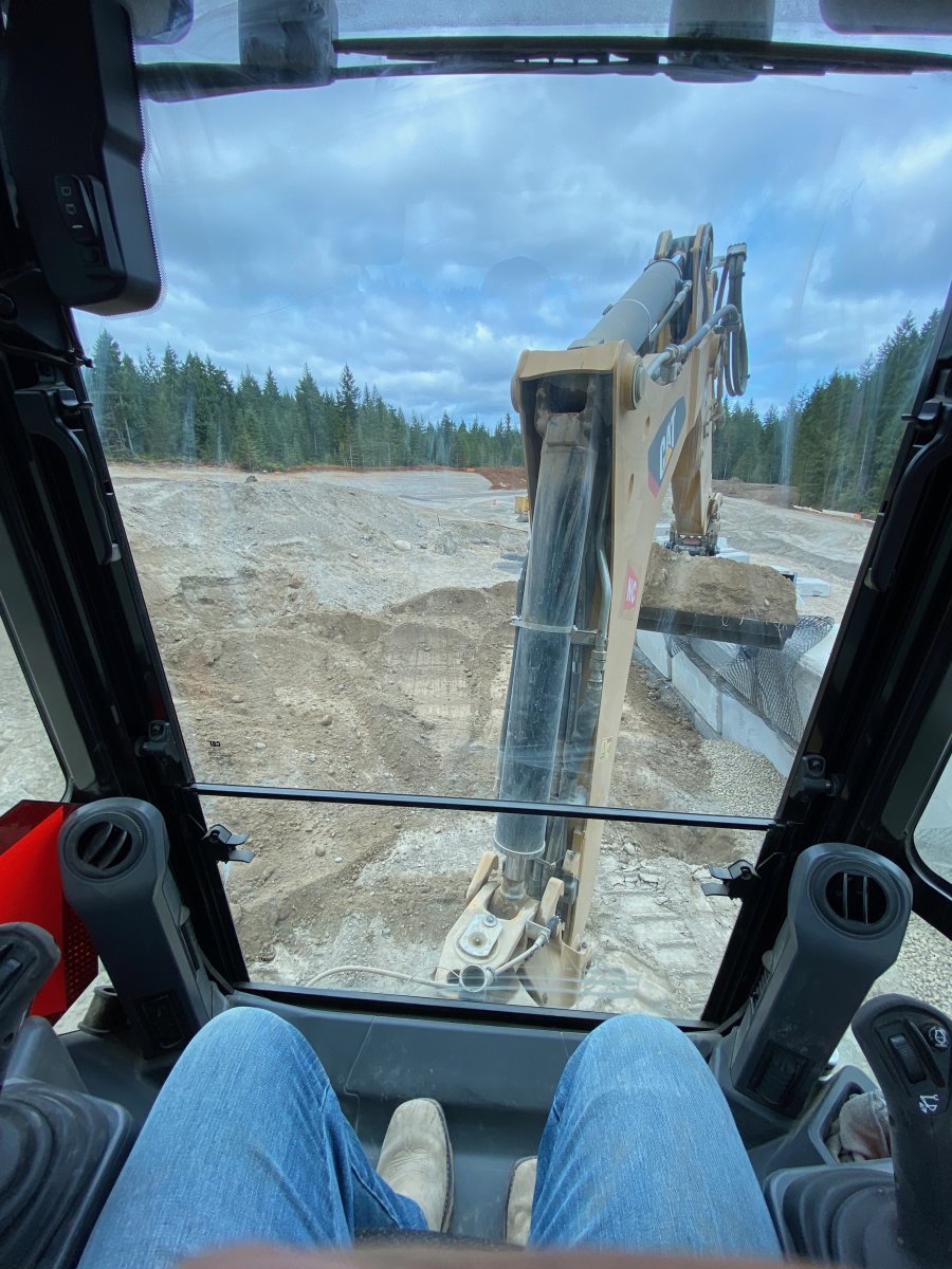

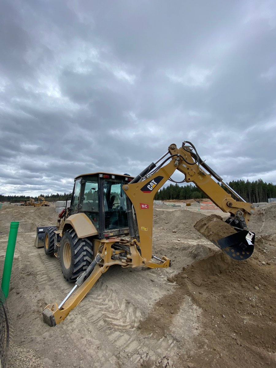

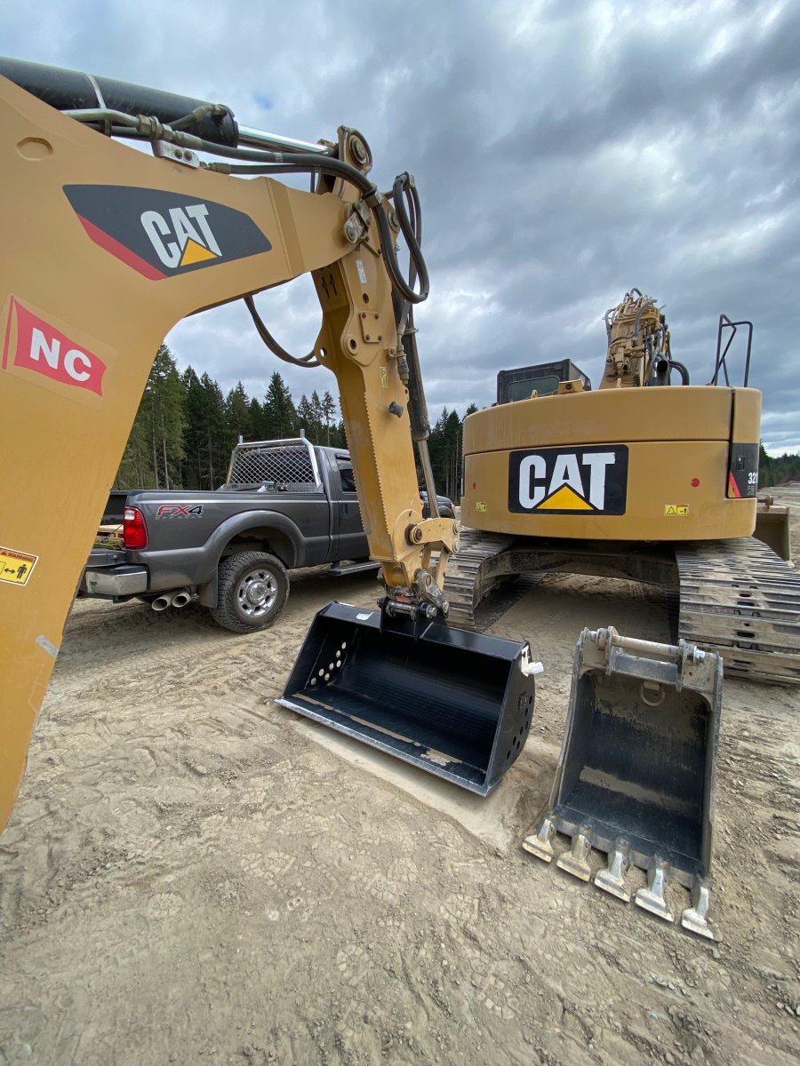

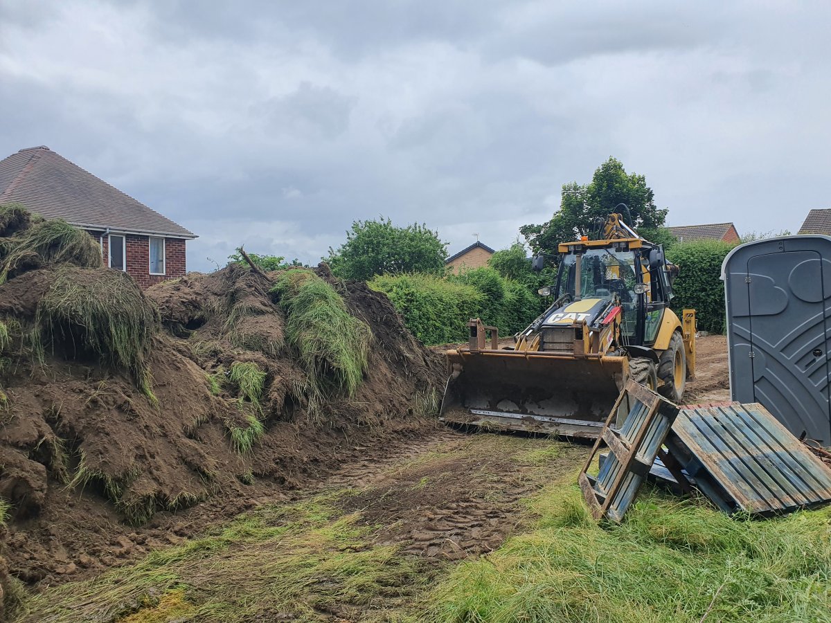

Dig the ground off level first then dig foundation to a set depth on your bucket/side of boom. Still need a lazer at somepoint.
Digging a foundation out with my trusty Cat 420. Any tips for doing it without a grade man?View attachment 39221View attachment 39222View attachment 39223
bullseye bubble on your king post pin top ;) ... where ever you point the boom it'll be level .. a good eye is no match for a bullseye

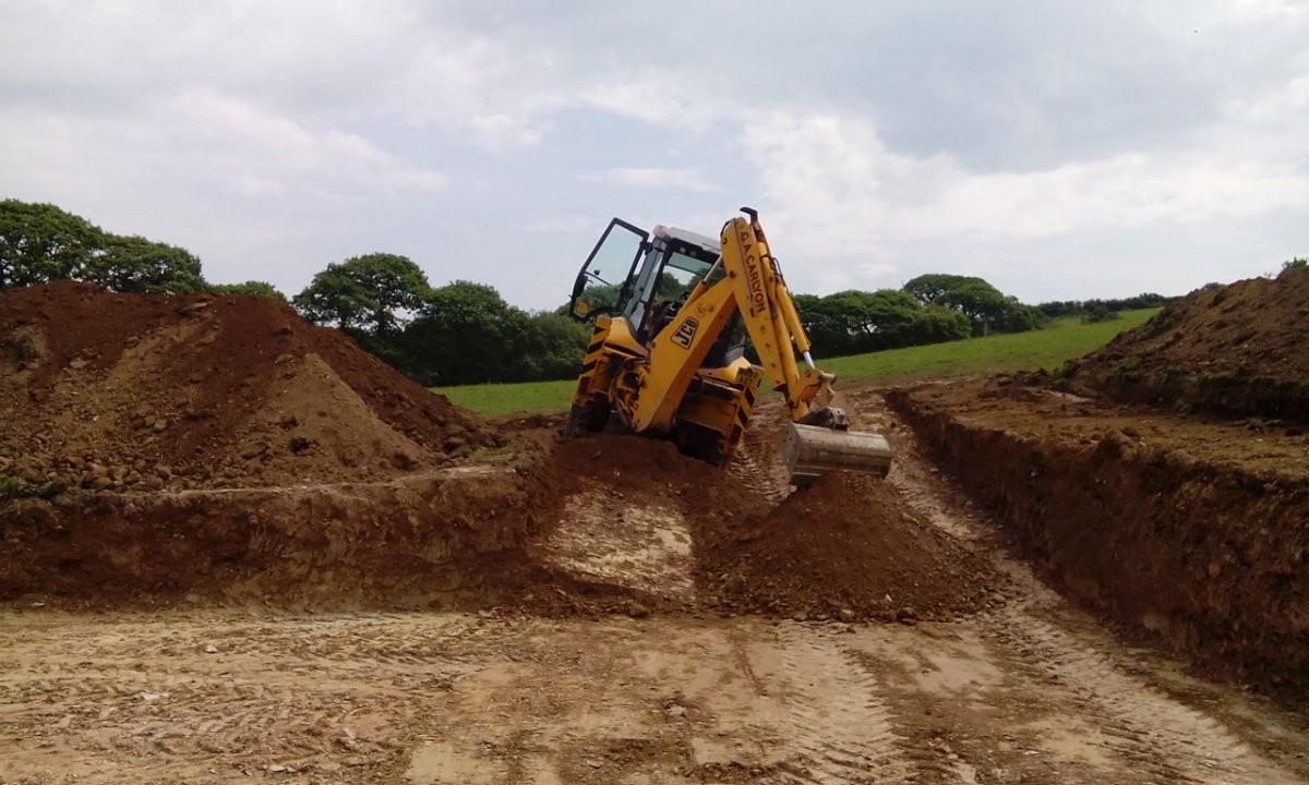

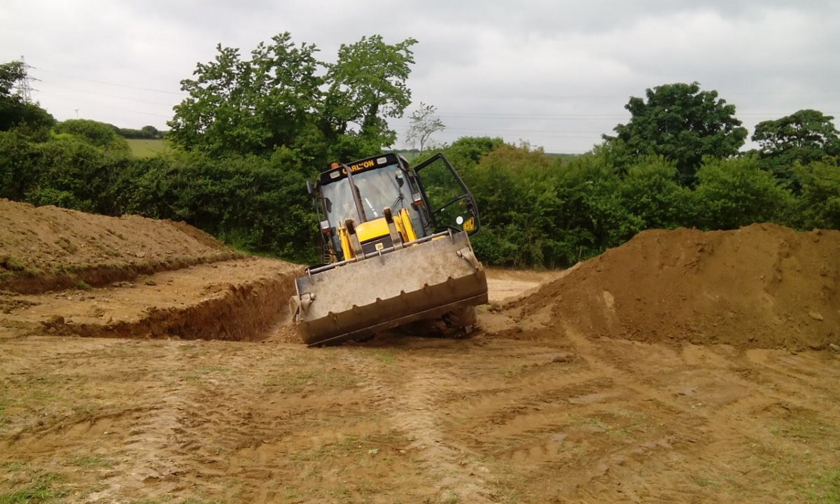

Foundation for billy is a big flat area that they then shutter for strip foundations then pour concrete. We dig ours into the ground then pour concrete into them.
What I do is level it check it etc get it to where it needs to be for grade then follow it through try keep it on grade little high if I can then check with laser and clean up.
Magnetic mount is handy though for roughing it out
As a beginner, I thought I was cheating with a level - I feel better now!
This one is magnetic and the lip on one edge keeps it perfectly aligned on the window frame.
Oh I get it, it's just my skills aren't yet good enough for the for-aft axis to make any difference :ROFLMAO:
get it level, N to S and E to West and it's a lot easier to improve ... frustrating when the pull from off the centre line is never as good as on centre ;)
The ones your dig are bloody fun looking! i think our foundations are the same, but we have to form ours, as you say! even a big underground foundation must be completely excavated out, formed, poured, than backfilled. I don't mind the extra excavating work though!
Have you got gripper on huddig build a base station type thing heavy bottomed plate with pole for laser that you can easily grab then it’s like having a grade man with a staff but you just move it with gripper give you and idea if high or low etc
Funny you should say that, my little doosans cab frame, centre bar in the split screen and centre pin all read different on the bubble
the cab is not necessarily mounted on exactly the same plane as the ring gear/king pin's axis ... as I say the top of the king pin is what needs to be leveled to ensure that that is perfectly upright

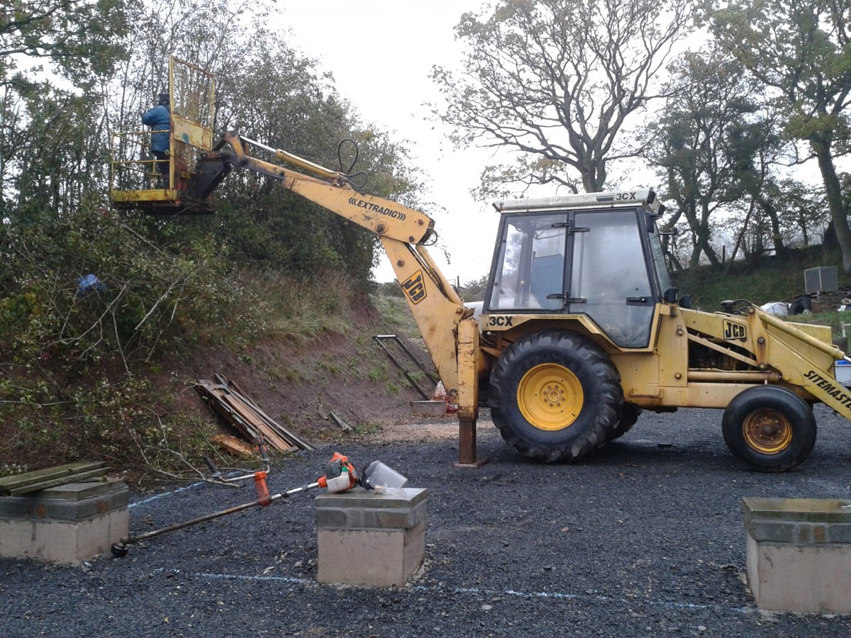

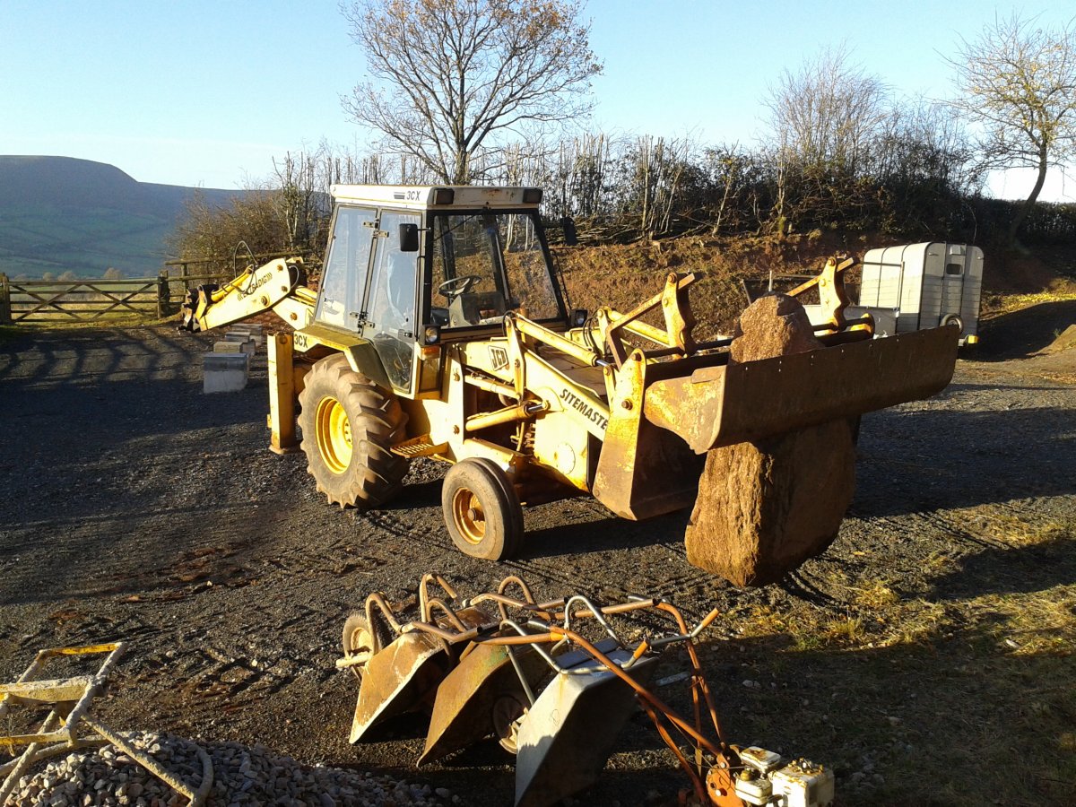

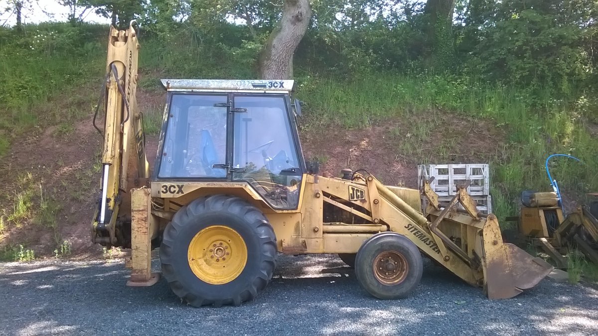

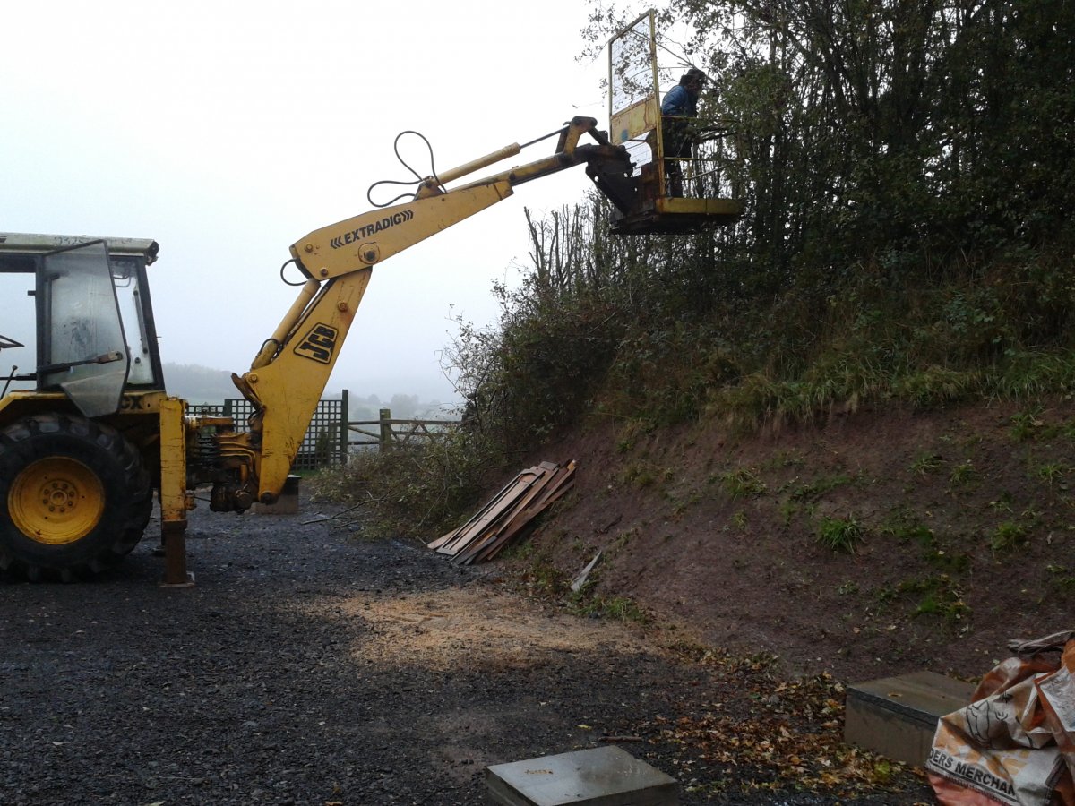

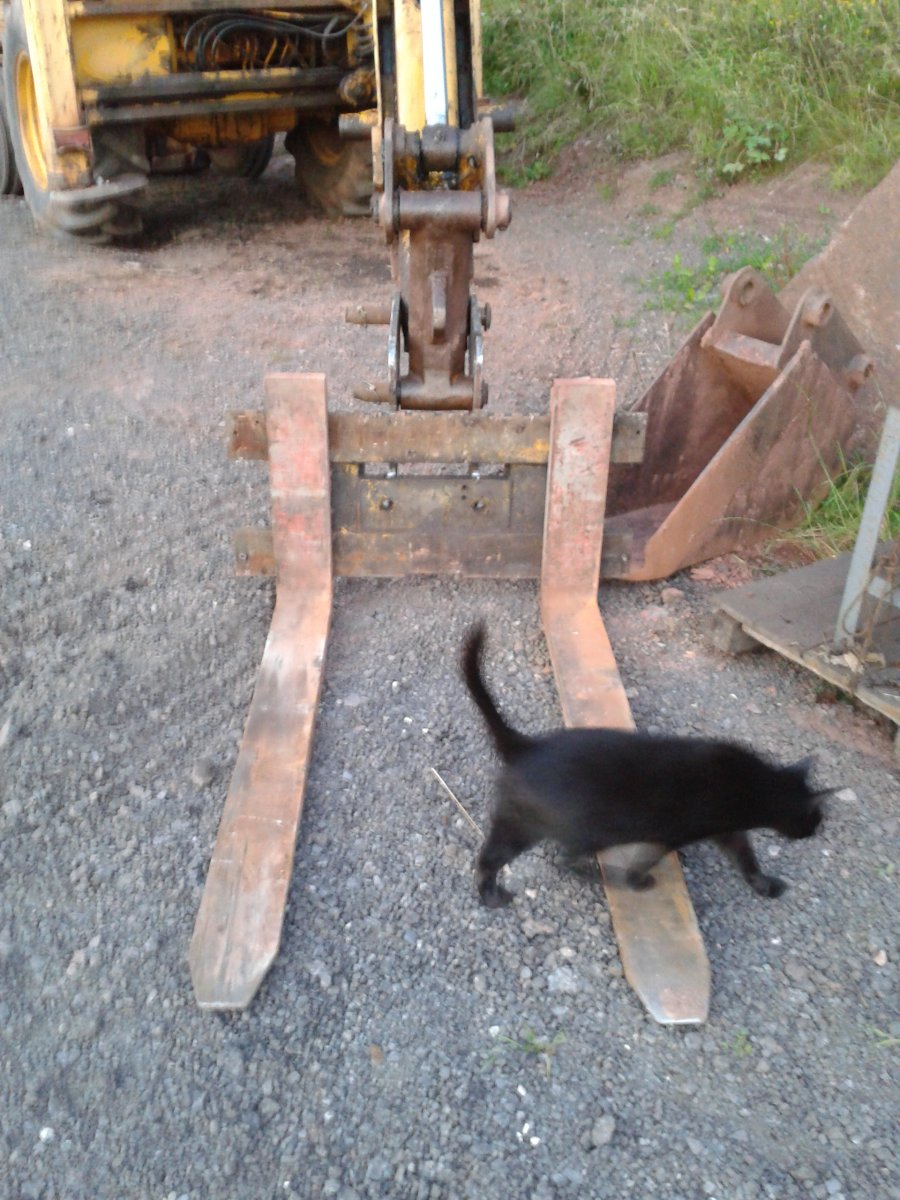

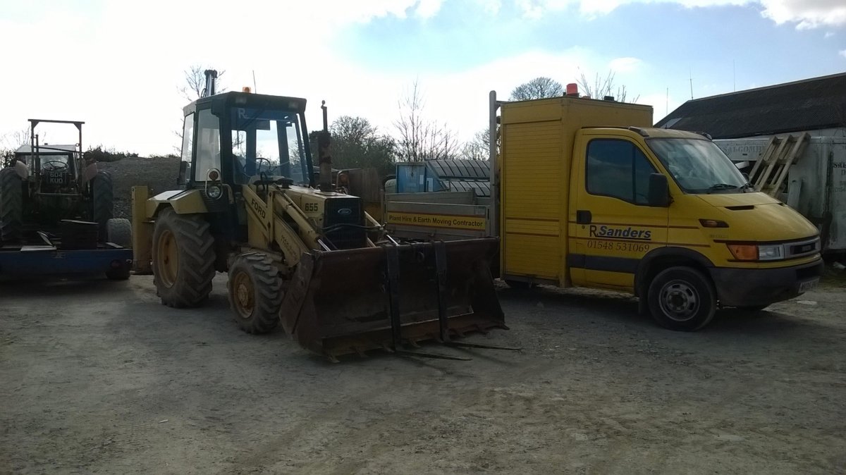

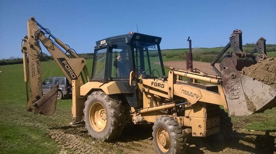

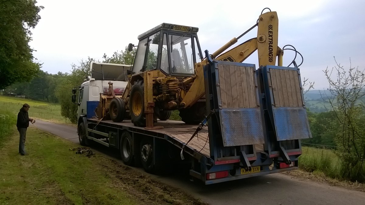

Why did ya sell it? All those attachments look bloody good, I’ll have some ideas now, especially the forks and man basket.
just wasn't getting used, since buying the duck ... and missus was adamant .. one out, one in .. wanted a smaller tracked 360 for some things.
sad to see it go though .. has done some work for me and'd take some replacing, condition-wise for the money.
