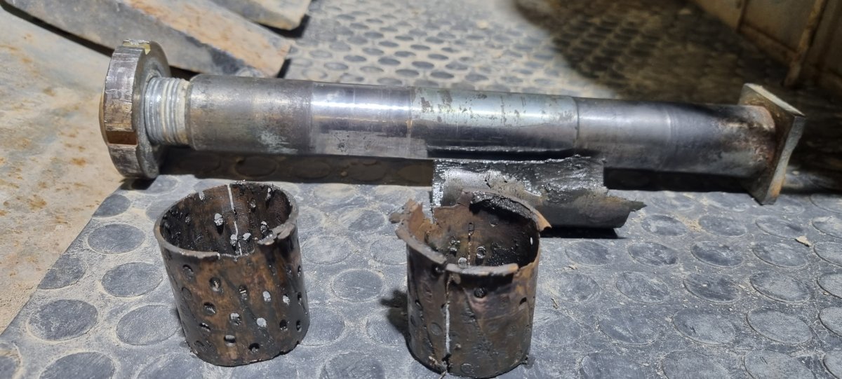

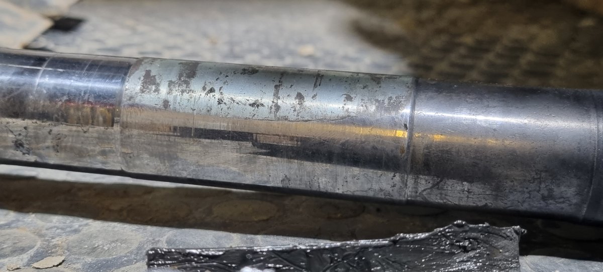

Hi Guys,
Does anyone know where I can get position 2 bushes and pin/bolt and position 8 and 9 bushes and pins please?
Late HR12 owner..
Thanks in advance.

Hi. I have one of those machines and bought all new pins and bushes from kellands. Genuine parts. Not the cheapest but knew they would fit and would be correct for the job
Thank you.. any rough guess on price?? Before I call them tomorrow.
Diggerdavey
I can’t remember off the top of my head as I bought new pins and bushes through out including ram eye bushes. It was 3/4 years back and I seem to think the whole lot was £1000 approx. The last parts I bought I was in contact with Scott Martin there. If he’s still there I’d recommend speaking to him, he was very helpful. At the time I bought several odd parts like fuel filler neck and fuel tank level sender and all were available next day from germany. Goodness knows what covid will have done to that level of service

We can make you some hardened pins to pattern if you send us some measurements

Thanks All - I have the position 2 pins and bushes sorted, but I will probably need to ream position 9 and have inserts made - so I will keep CPS in mind.
