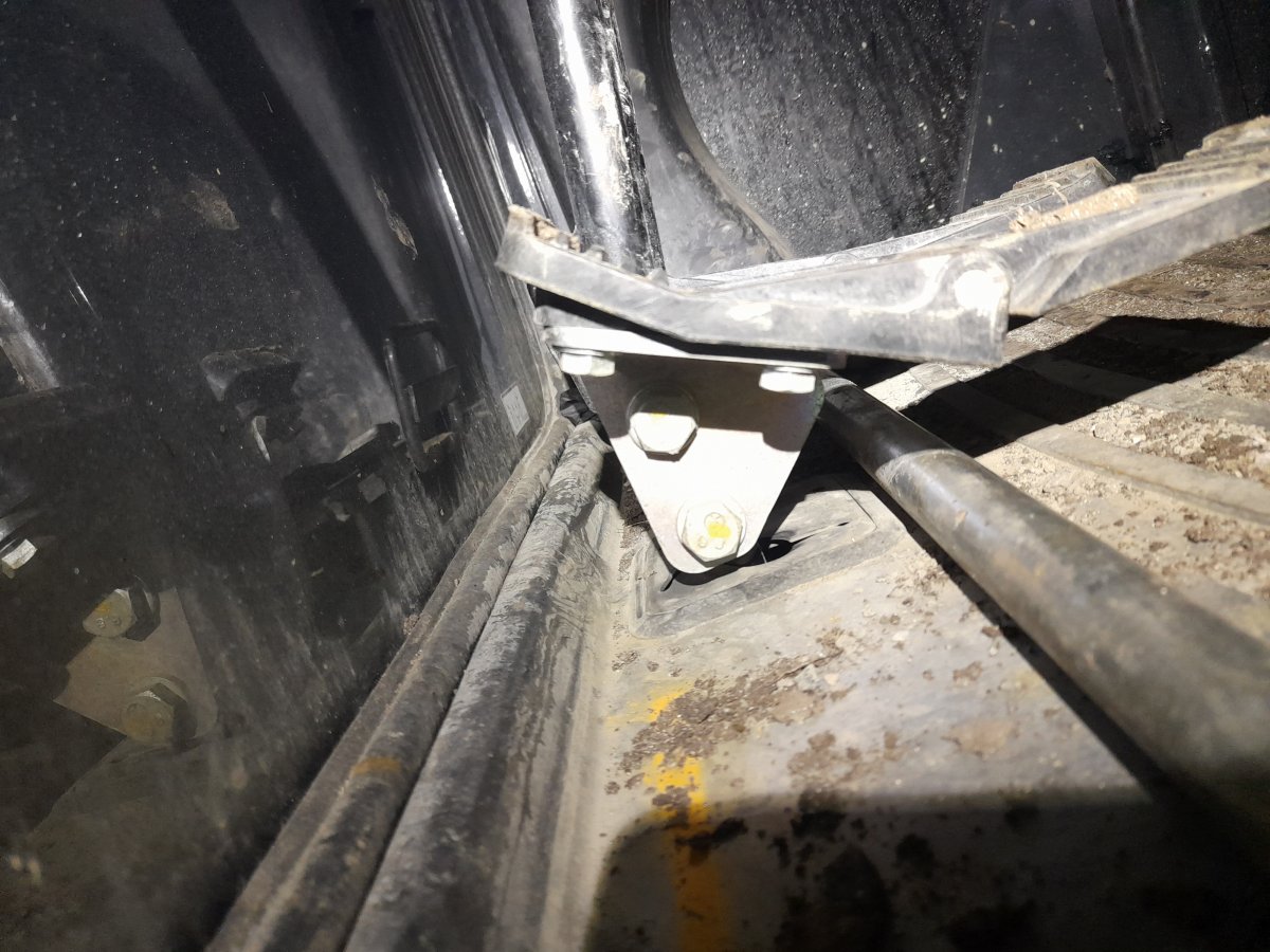

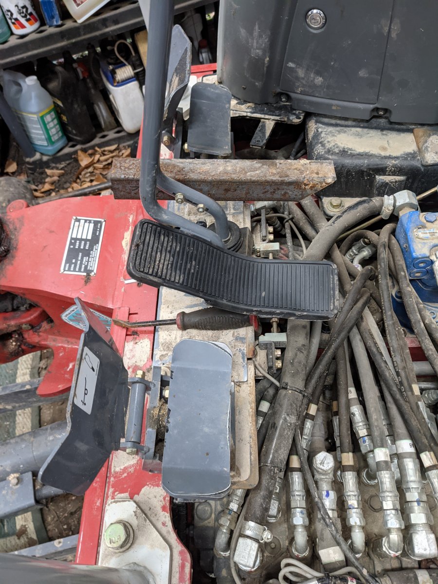

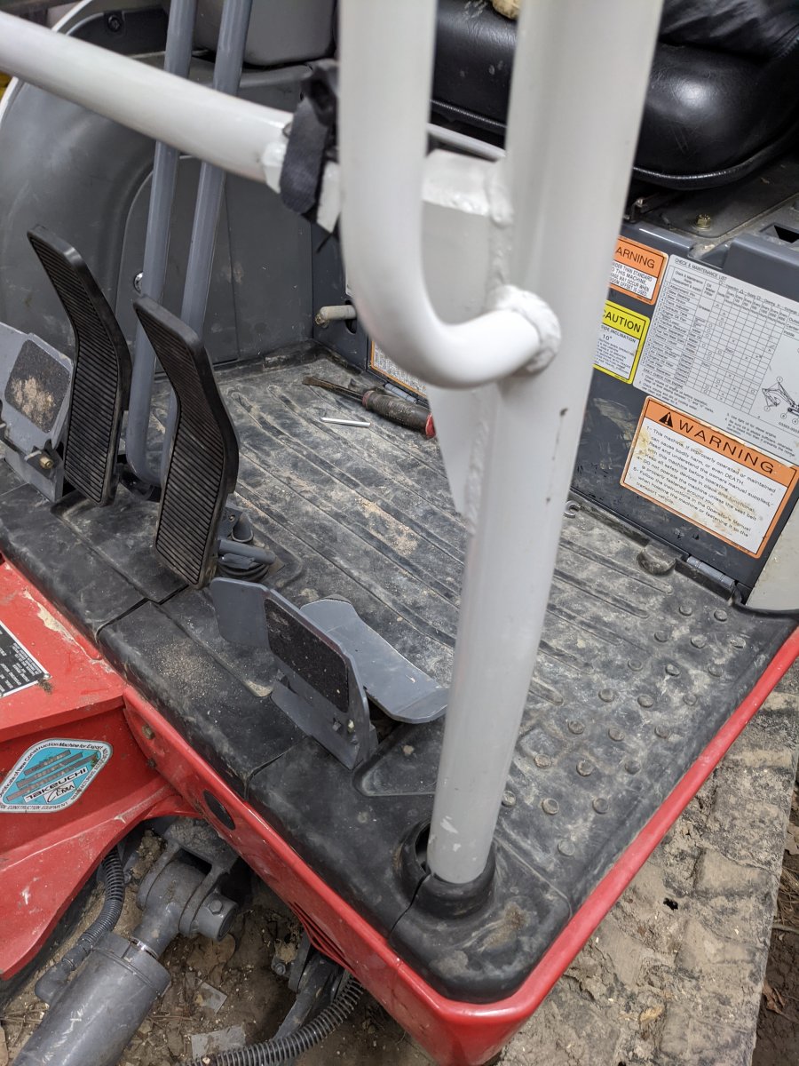

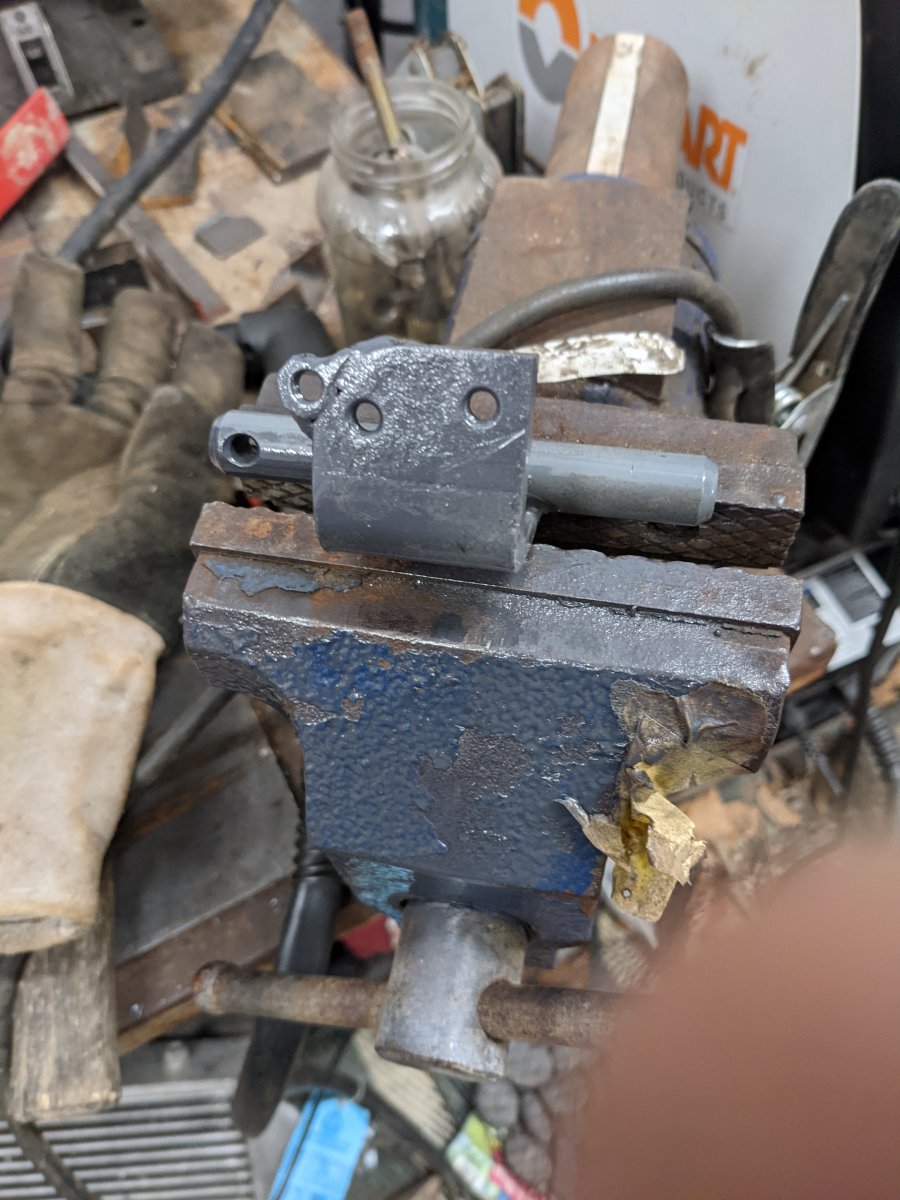

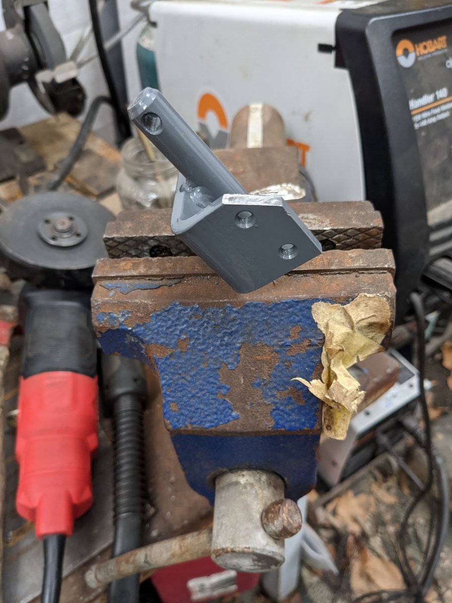

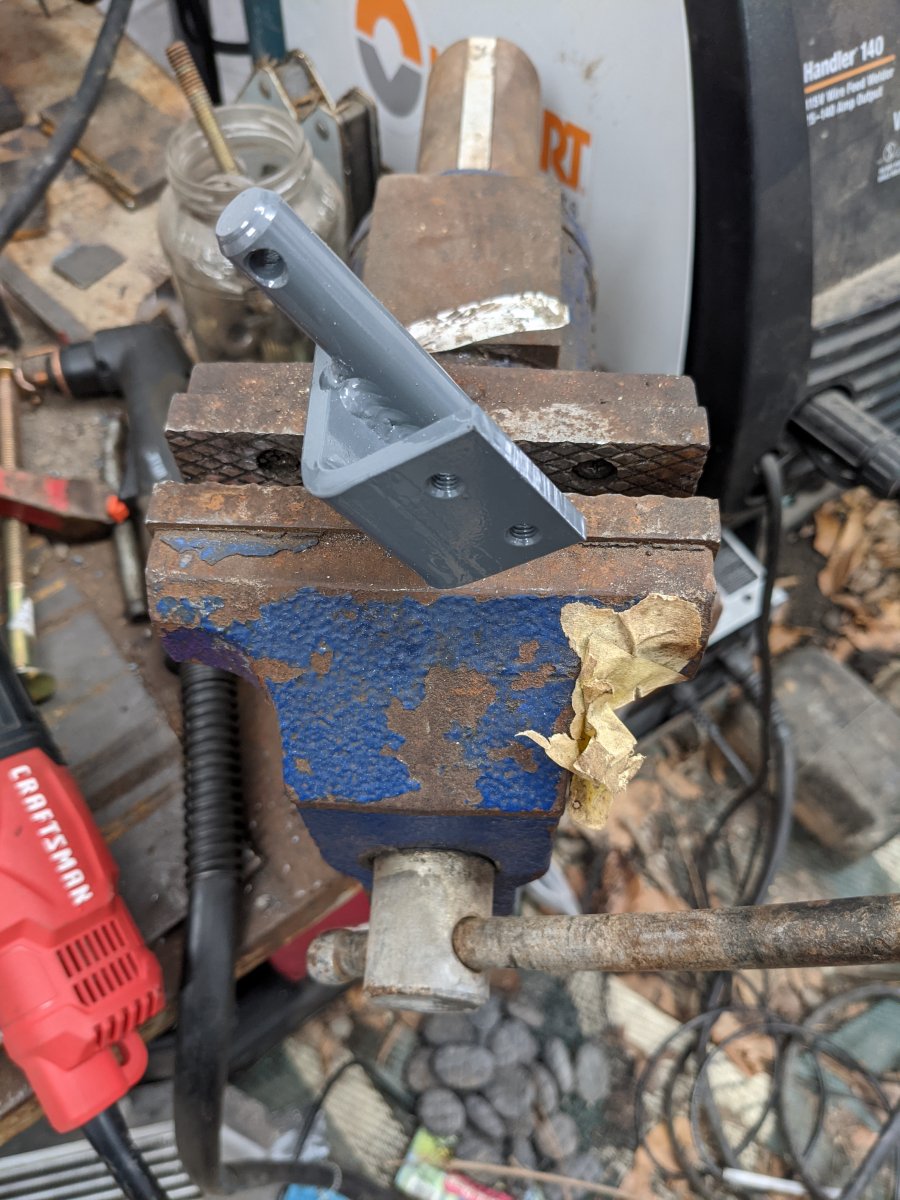

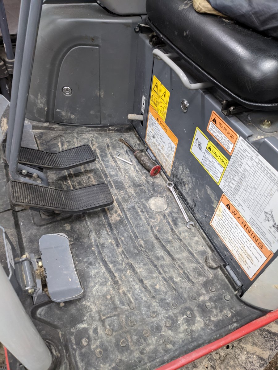

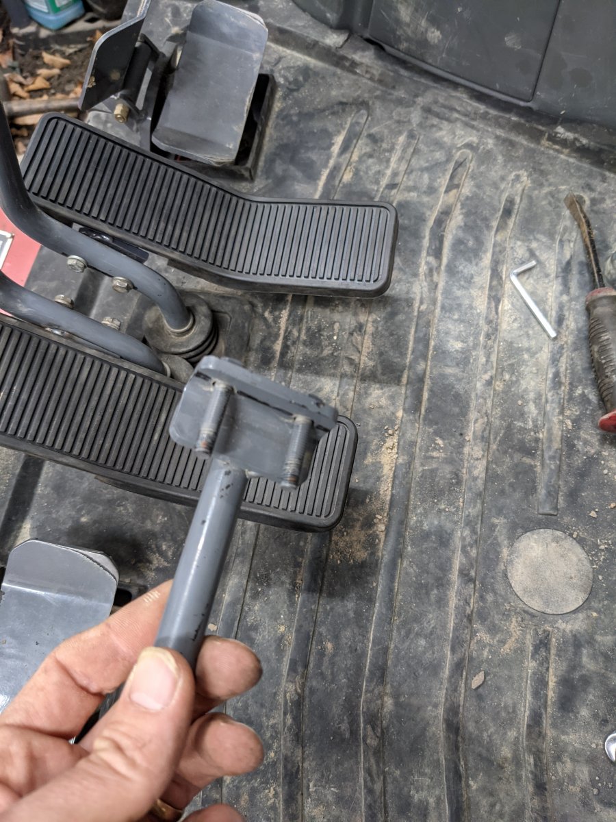

The factory Takeuchi travel pedal is just a peg and it's crap. After scouring parts manuals and pictures a TB135 set up looked pretty darn close and I was correct. I made it work this way but a person could drill a new hole in the travel arm as an alternate method.
Not pretty, oh well.
Factory pedal next to my stop gap "test pedals" set up.
Peg vs pedals.
I'm happy.
