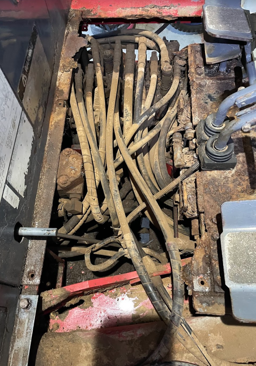

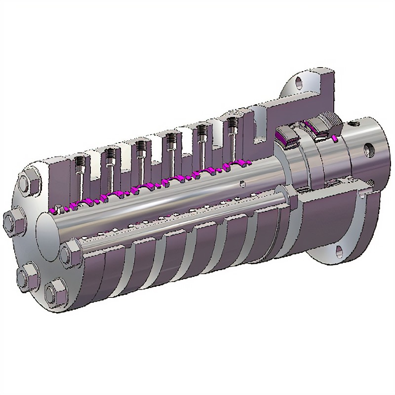

Might be your rotating valve block that allows rotation can’t think of the proper name but seals go in them that allows the upper structure to rotate.

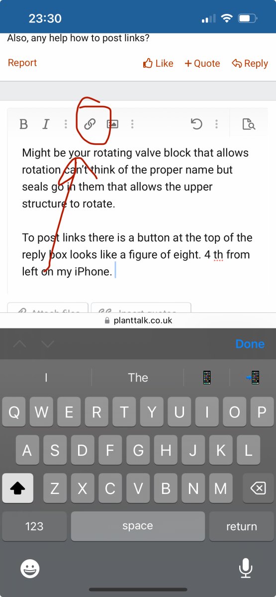

To post links there is a button at the top of the reply box looks like a figure of eight. 4 th from left on my iPhone.

rotary coupling Giles -- senior moment :LOL: - have loads of them :ROFLMAO::ROFLMAO:
links are the chain symbol above the post box ☝️
@benshudson ..pix are attach files below the box 👇 ;)

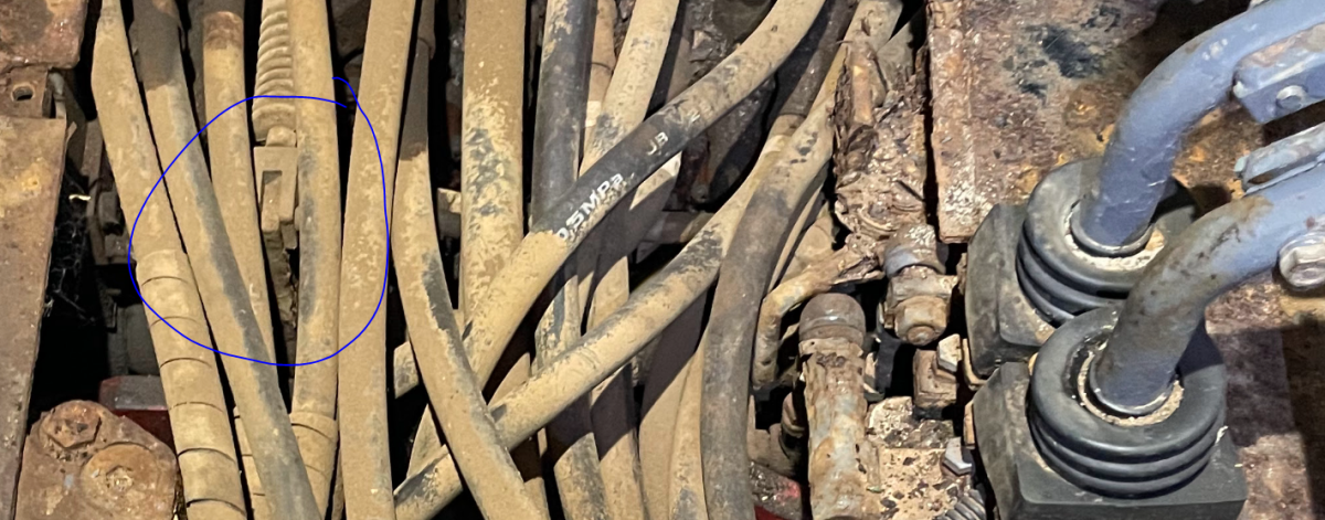

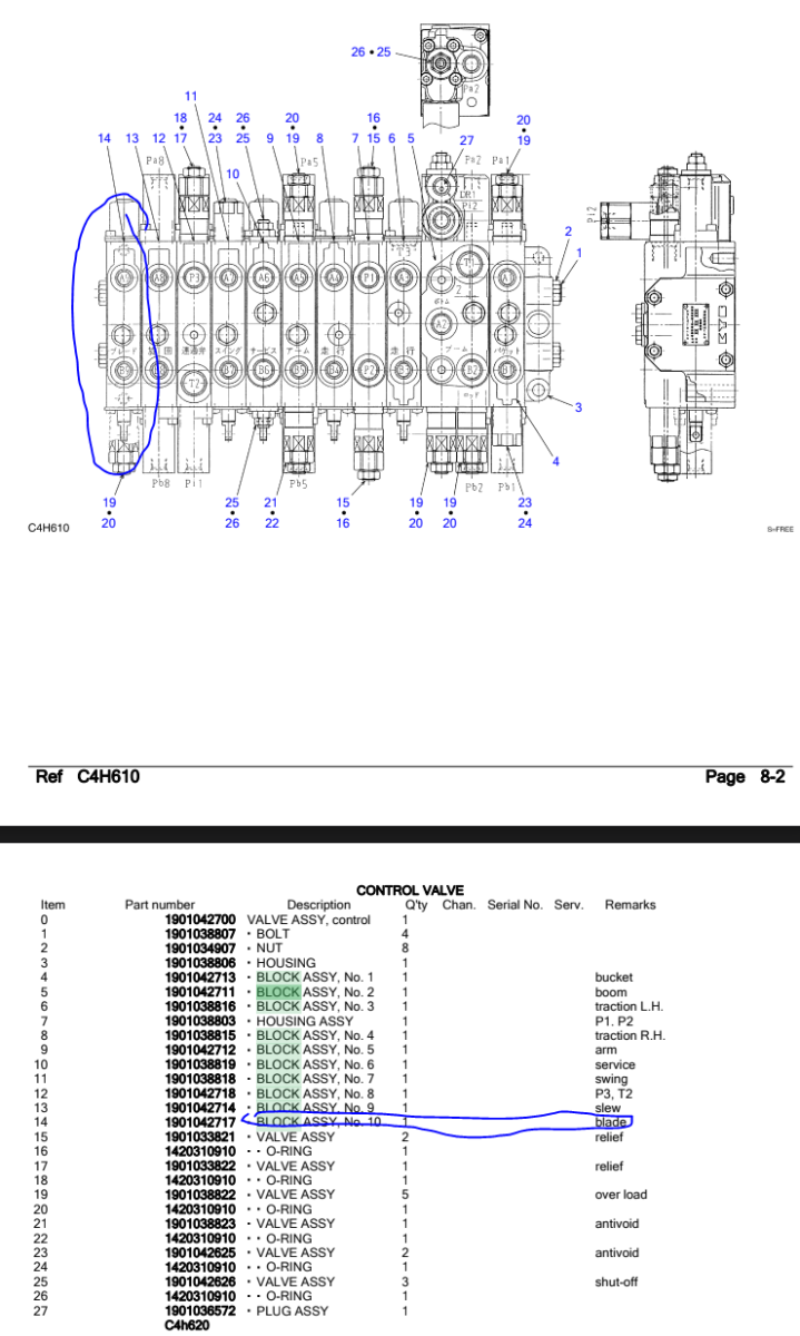

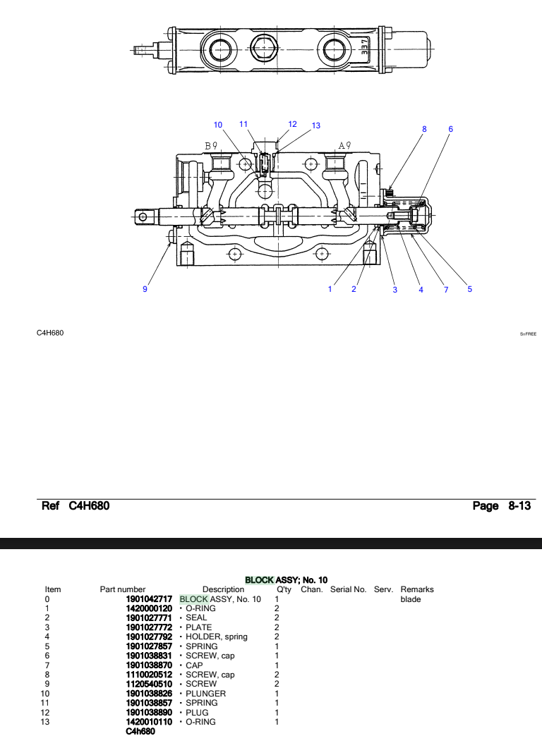

hmm OK thanks - the rotary coupling is under the circled blue area in the attached?
I assume to replace this need to drain the hydraulic tank and unbolt those hoses covering?
is it the block assembly as shown in the block assembly attachments? Is that something different?

The rotary coupling is accessed from under the track frame by removing a plate.

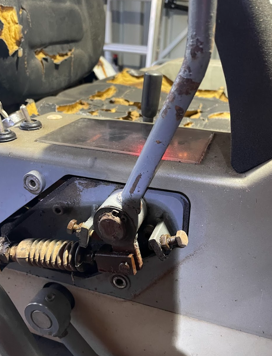

On my digger the lever for the blade also operates the expanding tracks.
To switch between the functions there is a different lever by the driver's right knee.
The blade wouldn't move on my machine, it turned out that this lever wasn't being depressed fully (to switch the valve to blade operation) because of a load of crap built up underneath the cab floor.
Once I cleared this out I could use the blade again.
Your digger may be the same.

hey all, I'm all good. It was the lever for the blade/expanding tracks as suspected above. It was jammed with gunk and oily residue so, once I removed all that, it freed up the level and voila!
