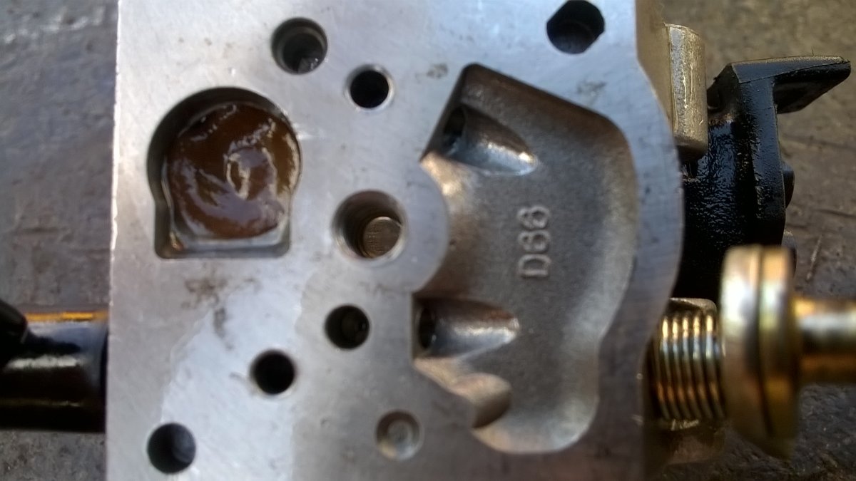

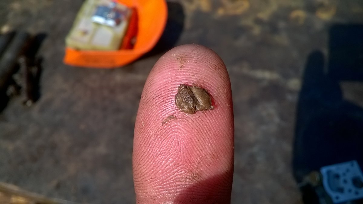

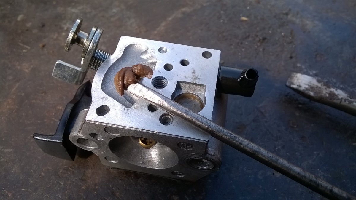

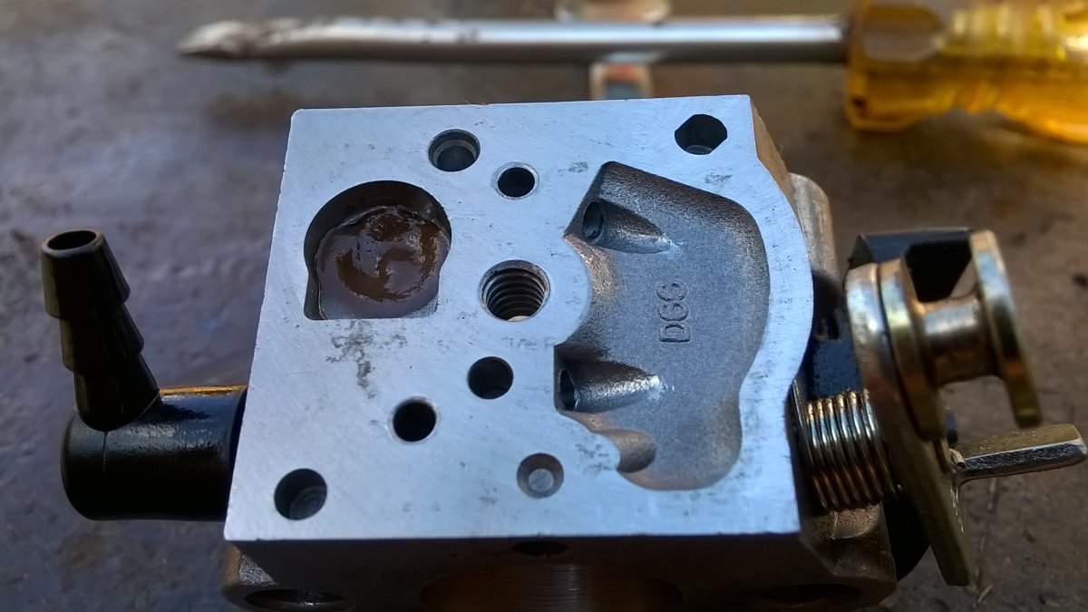

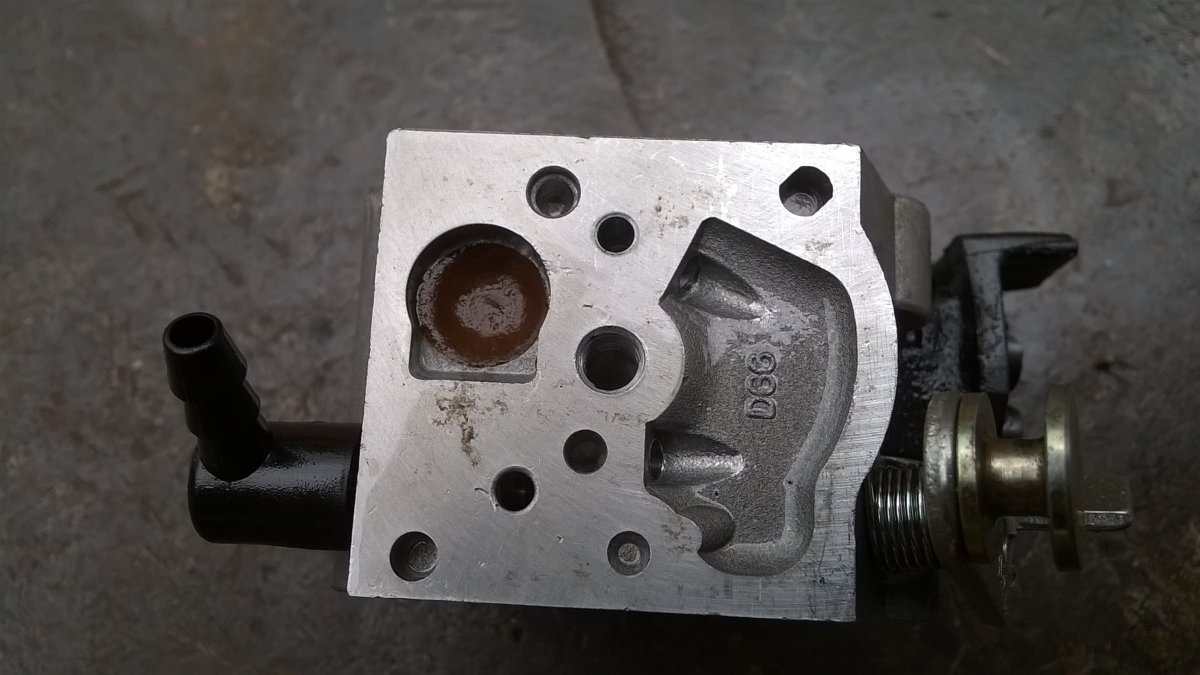

Just stripped it again after a light workout and this seems to be the sort of stuff that’s causing the problem, it’s all in the carb as well

Sure looks like the air filter isn't doing its job.
I know the MS170 is built to a price, but the air filter pad really looks like a weak spot.
Apparently the 171 and 181 use a flock filter similar to the bigger saws.
Totally agree with regard to the air filter, just not stopping the fine stuff going into the carb.
Might try buying a genuine filter to see if that helps.
Other than that it means a good clean after use to keep it ticking over nicely, and I’m getting pretty good at it now🙈😂👍

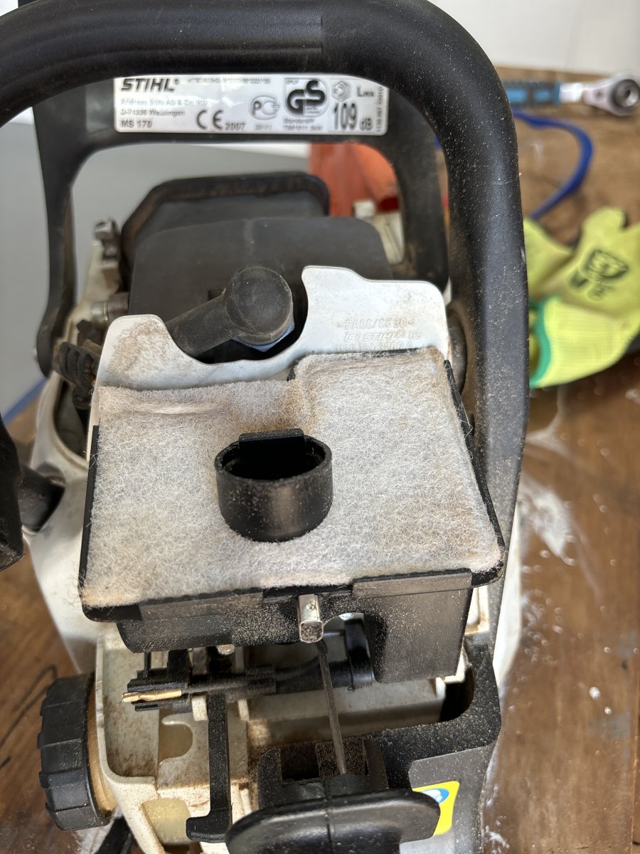

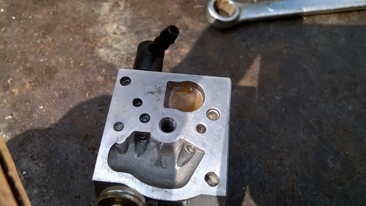

know that feeling well -- but usually mid use with that bloody gauze that keeps blocking in my 028

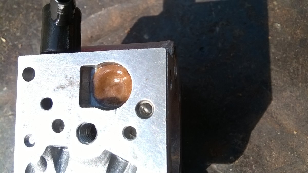

So, it lasted longer than before but ended up full of very fine dust again resulting in bogging down under load.
Stripped cleaned and running as it should.
Surely it shouldn’t block up this quick?
Am I missing something from the air filter area that’s allowing all the dust in?
Should there be 2 parts to the filter?
I think you might have the wrong filter looking at the witness marks on the fabric - LS Engineers show 2 different versions, and they are only very cheap. I’d personally buy both and see which fits best.

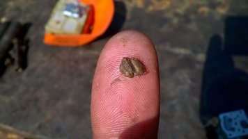

New genuine filter arrived today and straight away I can see a difference.
Just waiting for the new oil pump and then I can see if it’s a keeper or not.

Just thought I’d see how much difference there is between a genuine and aftermarket filter.
