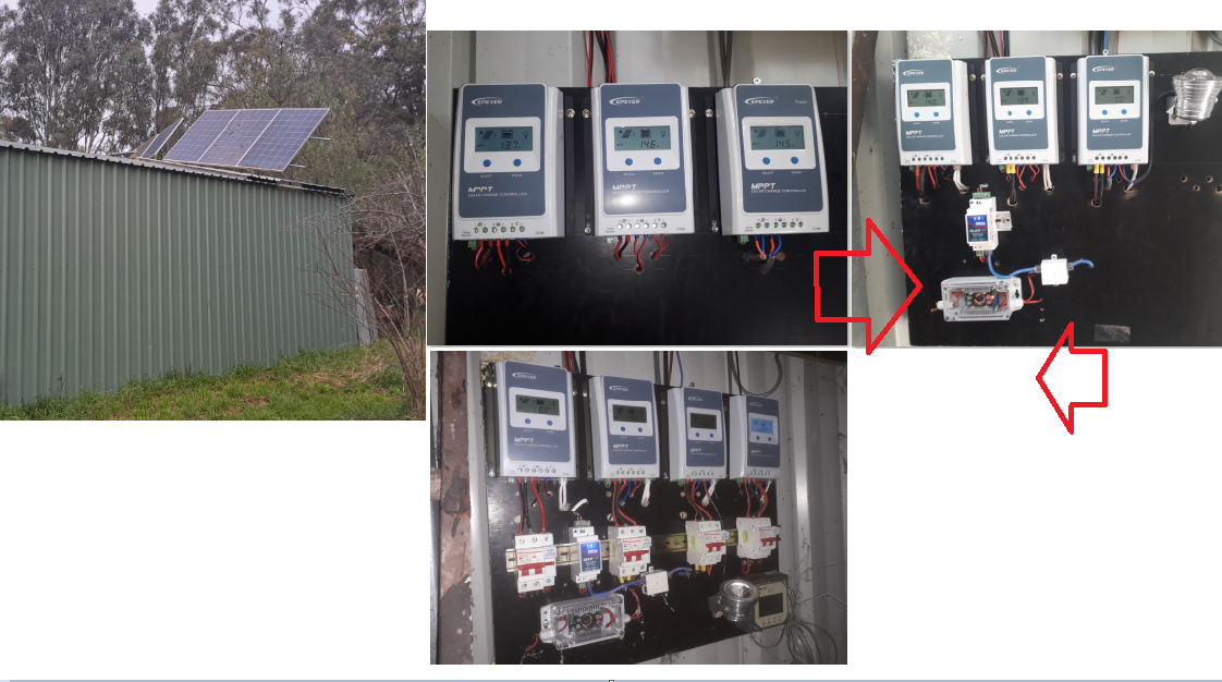

Mine has been a "Work in Progress".
One problem I found as a fixed install is that the regs don't like having full sun and then the battery gets disconnected. Since the last pic, I've added a capacitor to each that acts as a "fake battery" and suppresses any transients when a battery is disconnected.
