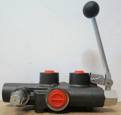

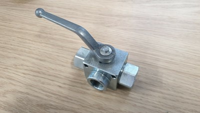

I was thinking maybe some kind of diverter valve in the main feed from the pump and then completely separate system with maybe a control valve clamped on the handle bar of the e10? I would like to leave the dumper controls as they are.

Maybe one of these to control it
And something like this in the feed line from pump
both links're the same @Russell
