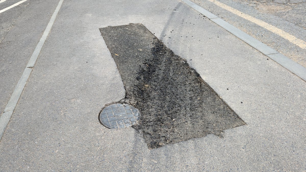

On a dropped kerb entrance to industrial unit.
Vigin media ...wtf. about 2 weeks old

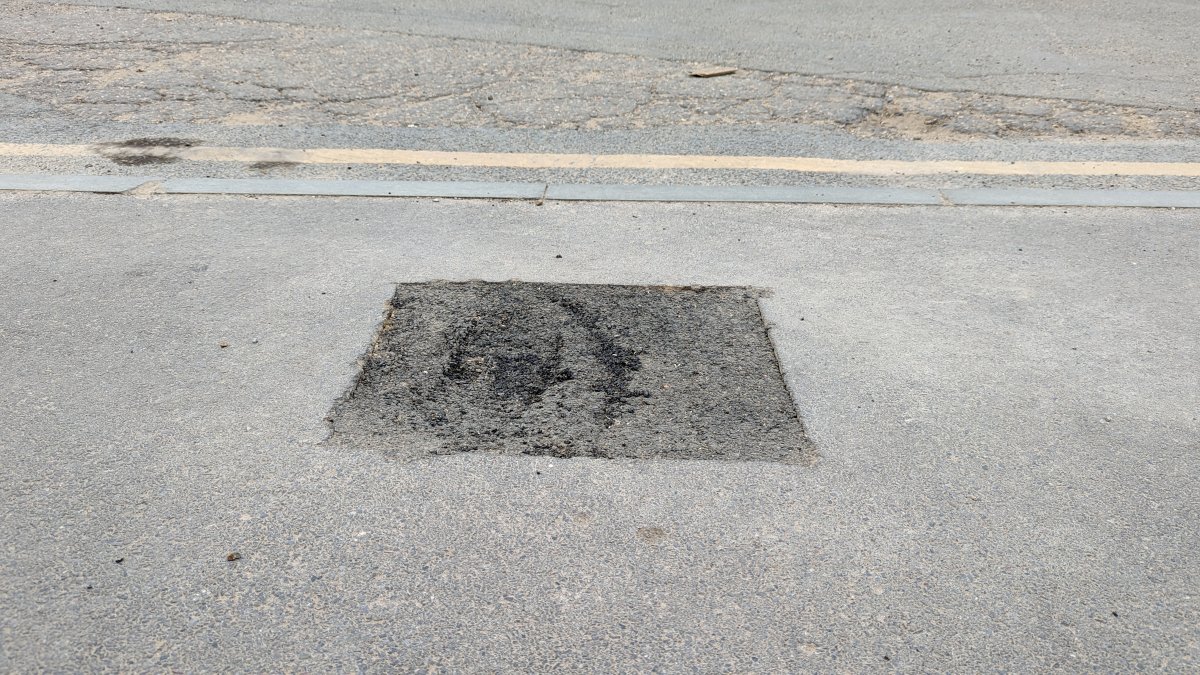

Got worse after picture

No idea but it's doing my nut in.Temp tar?
It can still be laid an awful lot better than that. It’s not cheap compared to normal tarmac.That's cold lay the real cheap stuff in bags

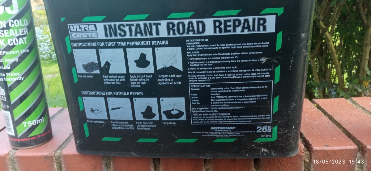

Maybe I’m not buying the cheap stuff? I’ve done plenty of repairs on shagged private drives and ten years later my squares are still as square and flat as they were laid and the drive around them has crumbled.The cheap stuff will always be like that it never sets can run over it a million times with the Wacker and leave it years and still it's no different to how it comes out the bag it should not be used for anything more than a small patch in straight trafficked areas , not a turning area Ultra Crete tubs are slightly better but the best stuff is viafix comes in an air sealed tub once the seals popped it sets like concrete and is stronger than the surrounding tarmac.
The worrying thing is the council's have started buying the real cheap stuff by the arctic load for pothole repairs
Granted forklift traffic is a different issue, there are finer grained and stronger resins available for this as you mention.
Maybe the cheap stuff is genuinely temporary- to be easy to remove in a weeks time once they do the proper fill. The stuff I buy is around £12 a bag and sets on contact with air- it’s some kind of resin I think.I would think so. The cheap stuff really is awfully stuff and never sets.

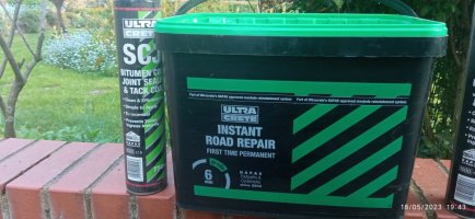

Or 85€ + vat a 25kg tub down here !!Yeah exactly. The cheap stuff is something like £4 a bag. The really good stuff is £30 per 20kg tub
Handy to know thanks might need some soon for our own yardThis stuff in the tub option is what we use to use at £45 a tub but it is the best stuff going. I did a speed bump repair on an entrance that has had 32t tippers and volumetric mixers screw round on it and it hasn't moved at all. I wouldn't even have expected hot lay to last this long
