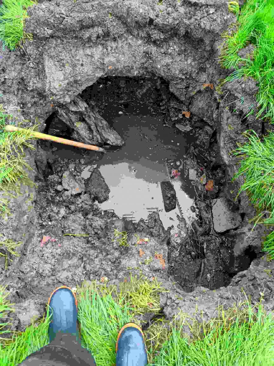

This is about 200t of rubble as a 'soakaway' but I think it's really a storage pit that's now full it was no tarram on the sides and only on top
