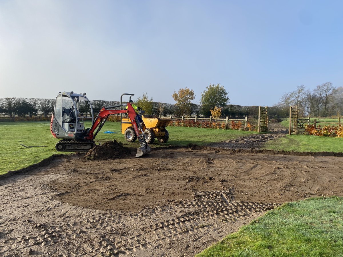

So rocked up with the Neuson and Terex and just started digging where Martin had marked out with the blue cord.
That's Martin in the dumper - he's very practical and a handy guy ;)

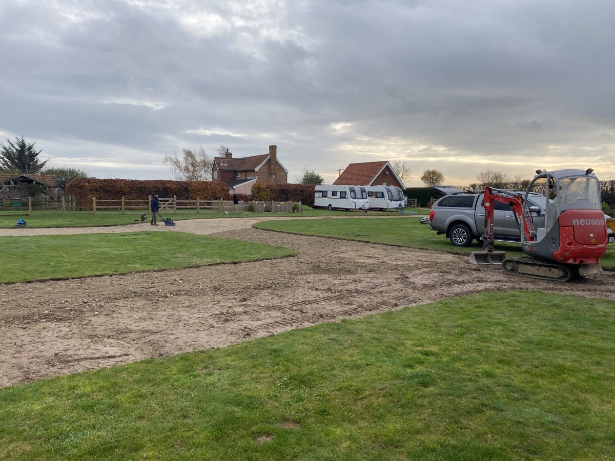

As the 'road' progress simply dug out the 'hardstandings'
Very basic 6" dig including turf ready for sub base materials and gravel top dressing

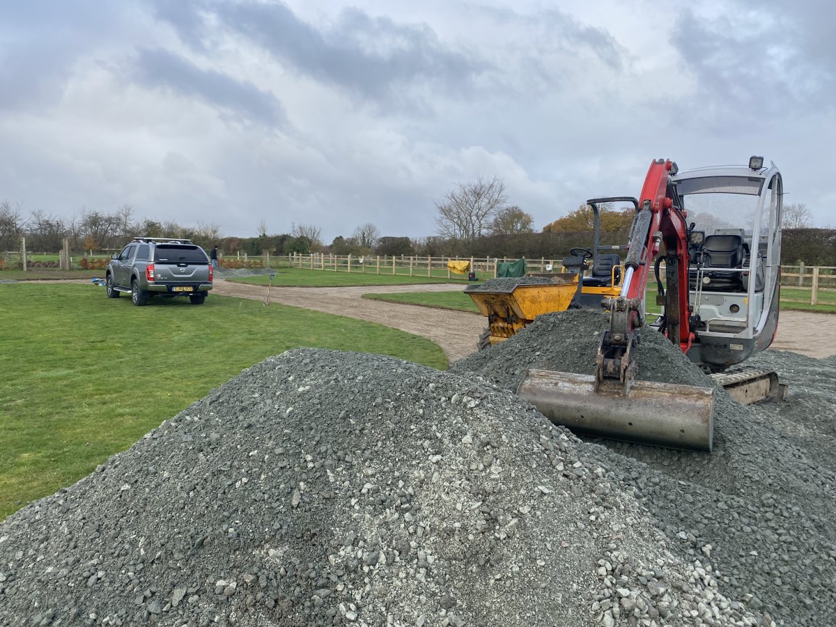

Martin got in at least 3 wagons of crushed for the bottom 3" or so....
So as we progress, Neuson spread the crushed, the boys fettled it with my big rakes and a Martin gave it a basic wack....

All the spoil had to go through the gate to the end field for sorting out later....
Trouble is that we had loads of fcuking rain to make mud pies :(
Chucked two loads of crushed in the gateway which soon disappeared.....
Spoil tipped in low spots and in areas to make 'artistic features' :p

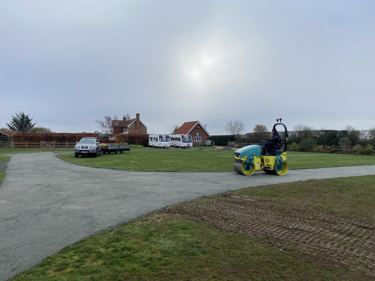

This is the stuff that I like. We had 4 wagons of grey Type 1 from Ipswich. Came in on the boat from Norway :love:
Martin hired a very nice 1200 roller from Toddy Tool Hire
When Steve Toddy delivered it we got talking about machines - what a great bloke.
Gonna visit his teapot at the workshops soon :)
Berm by the Blackthorn hedge and raised area.....
.....which will be 're-wilded' with a seating area in a "Wide Snug" :cool:
Job jobbed for me. Martin will go round the edges with his Wacker plate.:cool:
