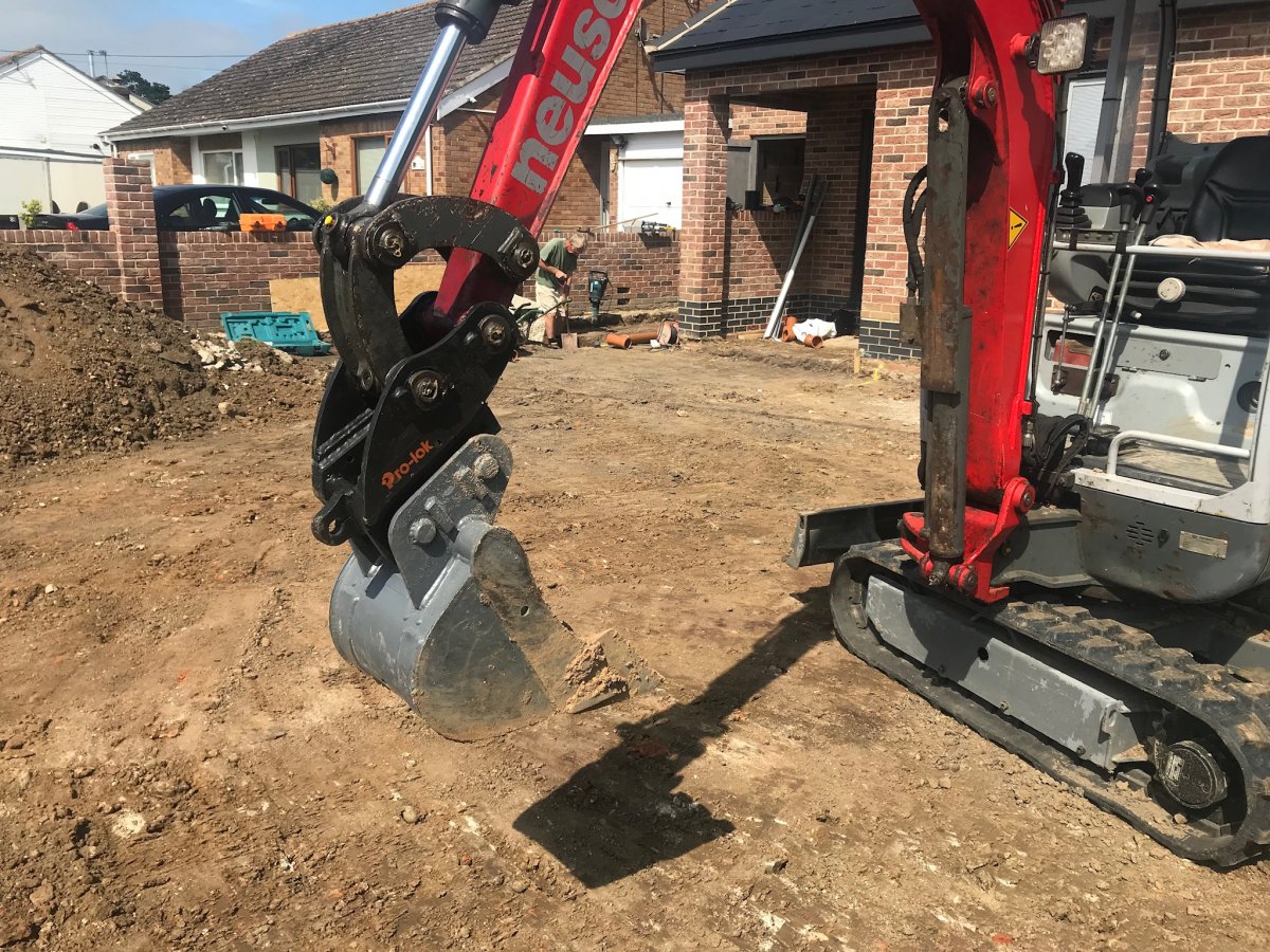

Day 3 - Can you just dig a few trenches for drainage :ROFLMAO:
So in the last 3 days must have changed buckets about 300 times :rolleyes:
Really pleased that I added the Pro-Lok quick hitch earlier this year (y)
Day 4 tomorrow should see me finish loads of trenches for drainage
Truck already loaded up with my assorted bag of ‘come in handy’ 110 fittings ;)
That Pro Lock looks brilliant mate, bet it tightened the front end up too.
Are you noticing any loss of breakout? I bet you're noticing the extra reach!!

Yes - wish I'd got one years ago :rolleyes: Don't think I'll ever go back to greasy pins in the dirt :eek:
And no haven't noticed any loss of breakout. Mind you it's a powerful little old machine :cool:
The extra reach is very useful for grading off. Just have to be extra careful that I don't catch the dozer blade or tracks :ROFLMAO:

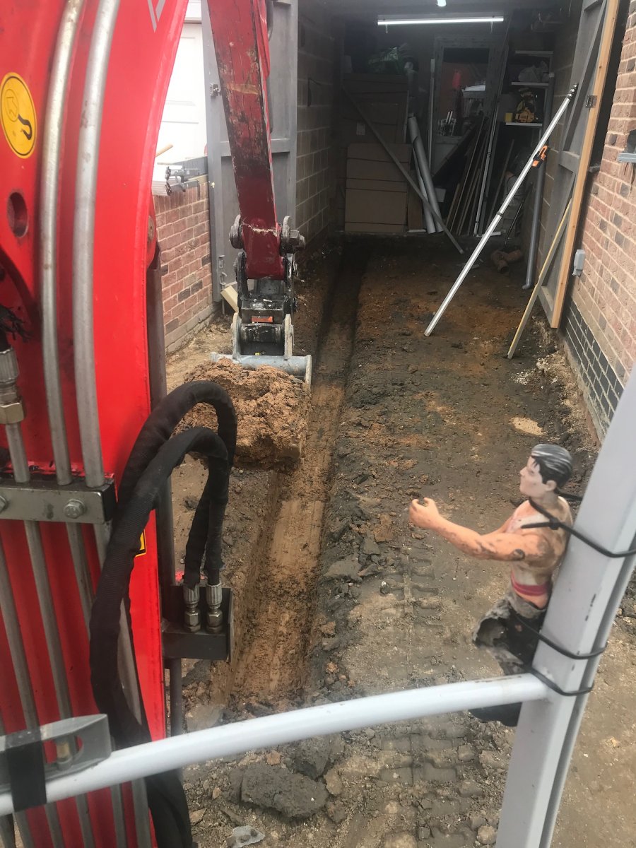

So yesterday should have been the last day for me on site at sunny Point Clear - loads more 'can you just' have popped up during the day :ROFLMAO:

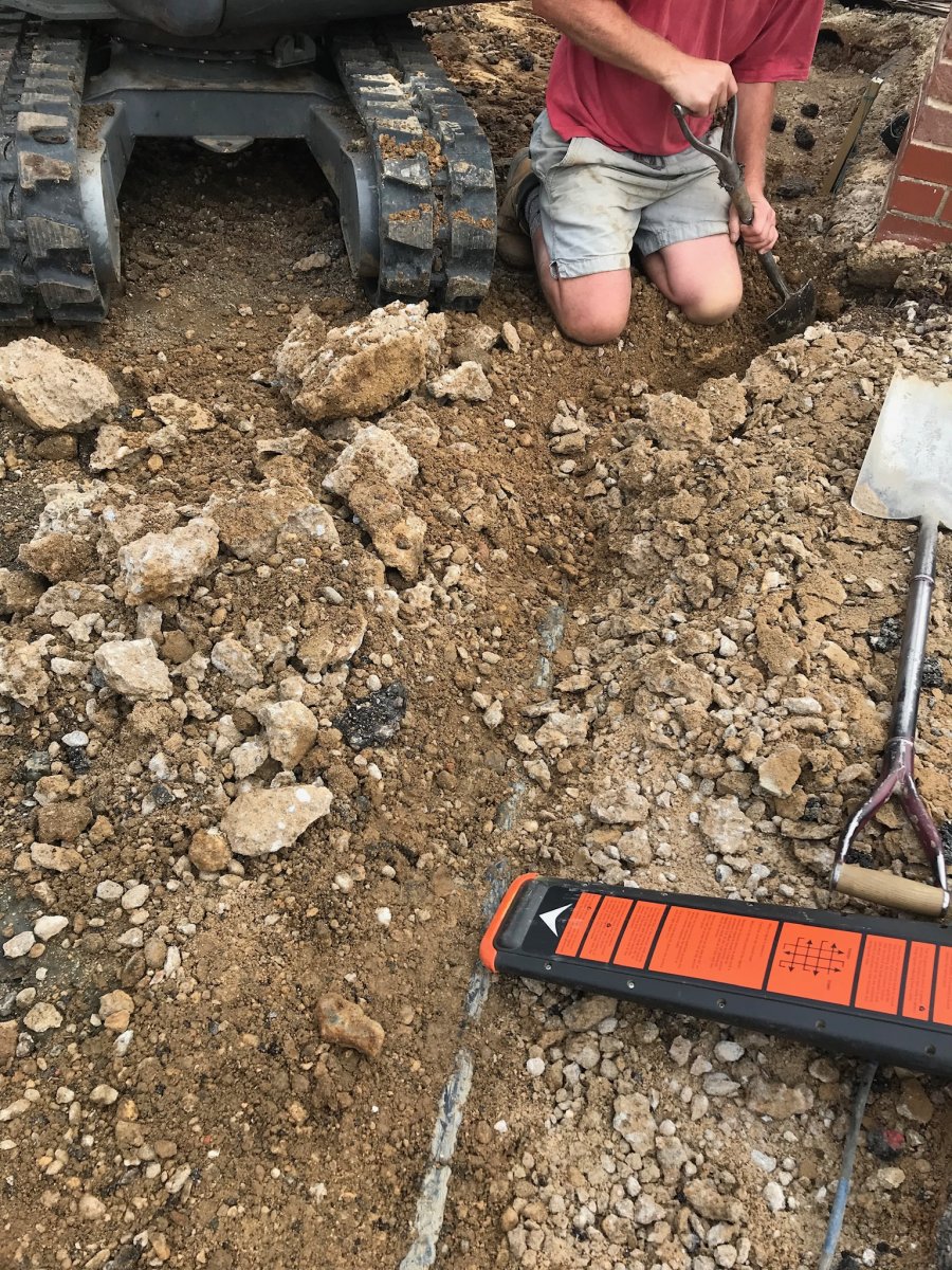

Like this little old trench for surface water - bit of a technical dig with 3 x foul water, 32mm water and 2 x gas pipes going on :unsure:
Got me a bit puckered up pulling the top off before grabbing the Armstrong spade and shovel :ROFLMAO:

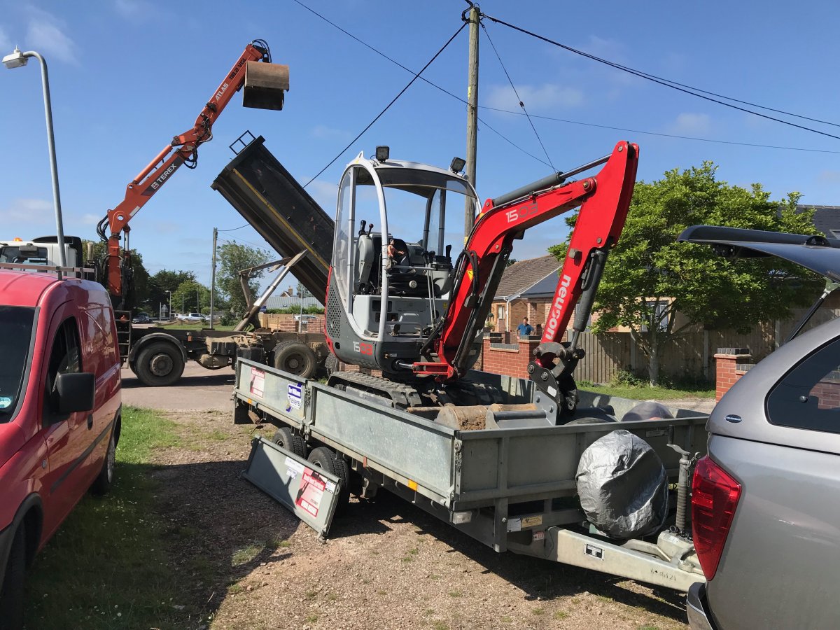

Towards the end of the day got out quick as this lorry arrive with more crushed
He took the 4th load of Muckaway from this dig out ;)

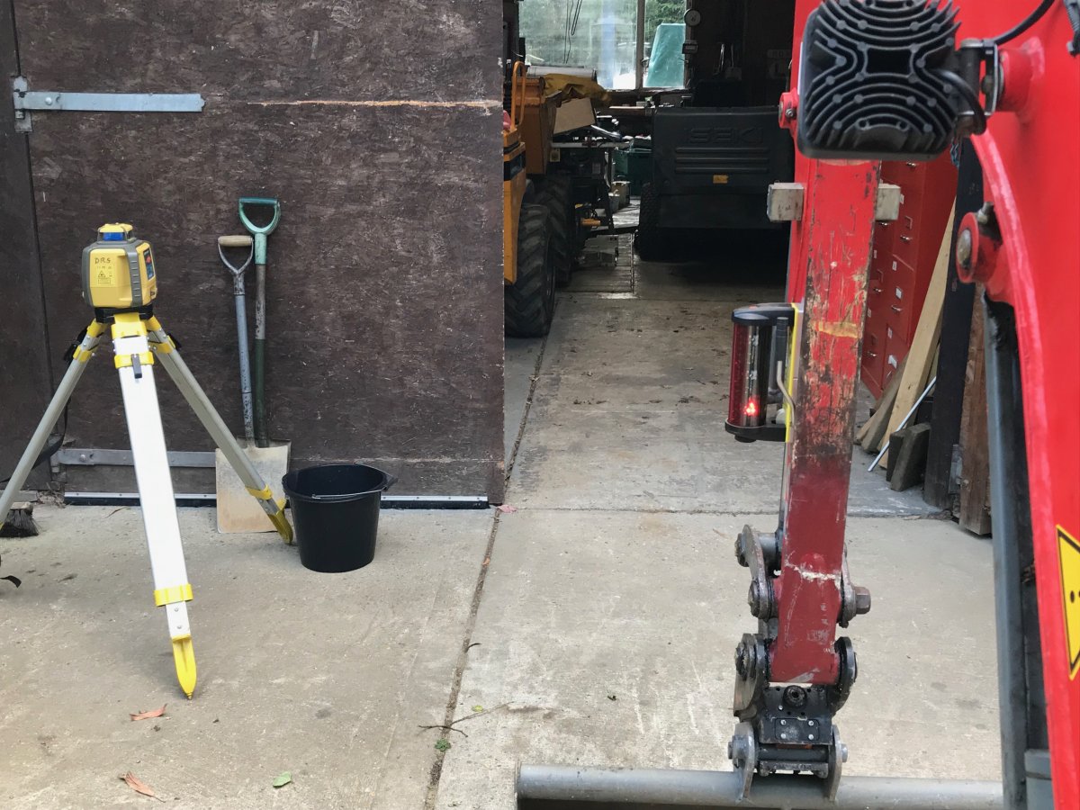

So next week will be back on the Point Clear site to grade off the Type 1.
The Groundworker, will be all over the place and is useless on the Laser staff and hand signals :rolleyes:
So, last night tested the Topcon v Leica LMR240 on the dipper......
Gonna be interested next week grading the Type 1 solo with laser tilt set to grade.
This will be a first for me and another learning curve :p

In all seriousness if you master setting the top con to grade can you make me a video 😂🤣 I get ass about face every time

The first time I did it trying to be a smart arse and show up all the ‘we don’t need a laser’ comments I set the fall up back to front 😂 luckily I noticed and rectified it very quickly before going back to my humble pie

With experience most operators can 'rough out' by eye. Then you get a shock when you fire up the laser t check :eek:

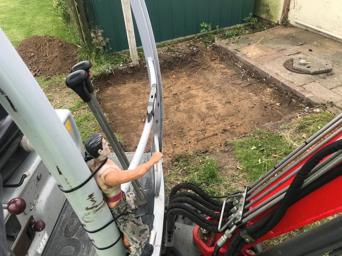

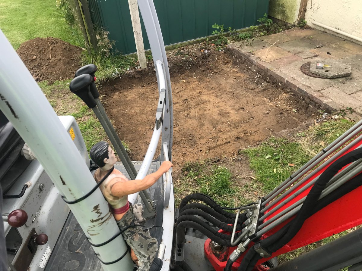

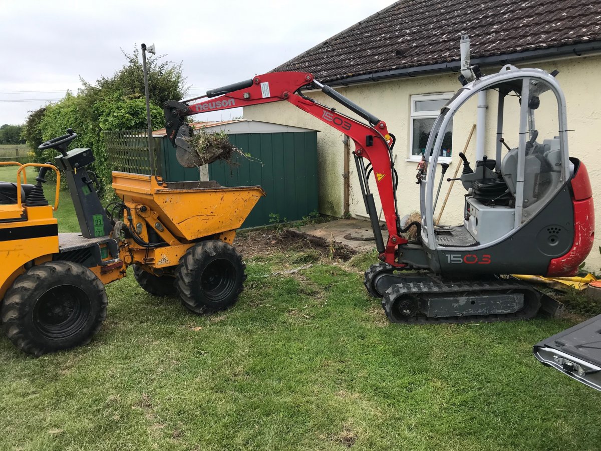

So yesterday saw me helping a neighbour opposite. Poor old boy at 82 has just had a replacement hip. He has been struggling with expensive and ineffective heating systems, storage heater and log fires etc.:( Now he is finally having a decent oil fired boiler and radiators installed :giggle:
He asked 'Can you just' put in a concrete base oil tank - yes I'll do it for cost of material only :LOL:
Oil tank is a BV1360 - a round vertical just under 1.5m diameter. OFTEC regs states 1800mm from building for tank.
Concrete support must be 300mm wider than tank on all sides. I opted for a nice 2100mm square.
Regs also state that ground must have 150mm of 'hardcore', blinded and compacted.
Then finished with 100mm of concrete :geek:
All roughed out and yes I did use my laser - my supervisor doesn't miss a trick :ROFLMAO:
Nice bit of 4x2 all levelled and pegged out ready for blinding and wacking later today.
Why do we do these things in a heat wave:ROFLMAO:

Had a great example last Thursday and last day on site. See photo above showing my digger on the trailer nearly ready to go home.
In the background is the Muckaway lorry delivering more crushed. I darted out the gate before he tipped and had to dig my way out:eek:
Then they realised that he had only gone and tipped the crushed on the pea shingle required for the drains :rolleyes:
Thought that I might have been asked to dig it out as a 'can you just job'.
My sensible plan B of having a couple of baggies delivered was adopted ;)
