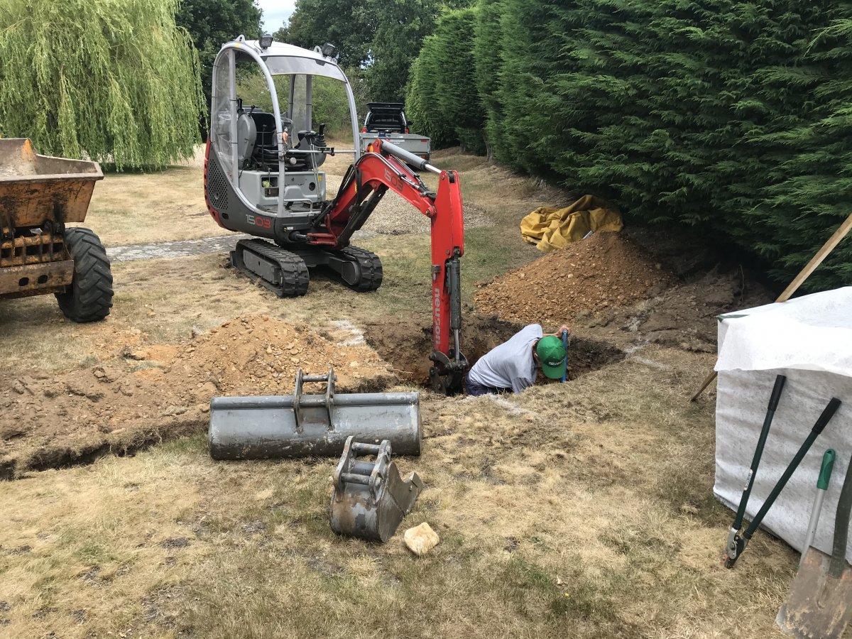

This time last week had no jobs booked for this week. Then a few 'leads' turned into bookings ;)

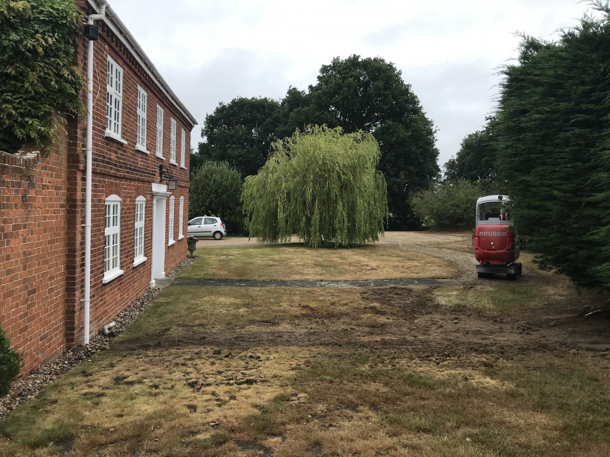

We started on Tuesday and Wednesday with a nice little soakaway jobbie on a superb former Mill House.

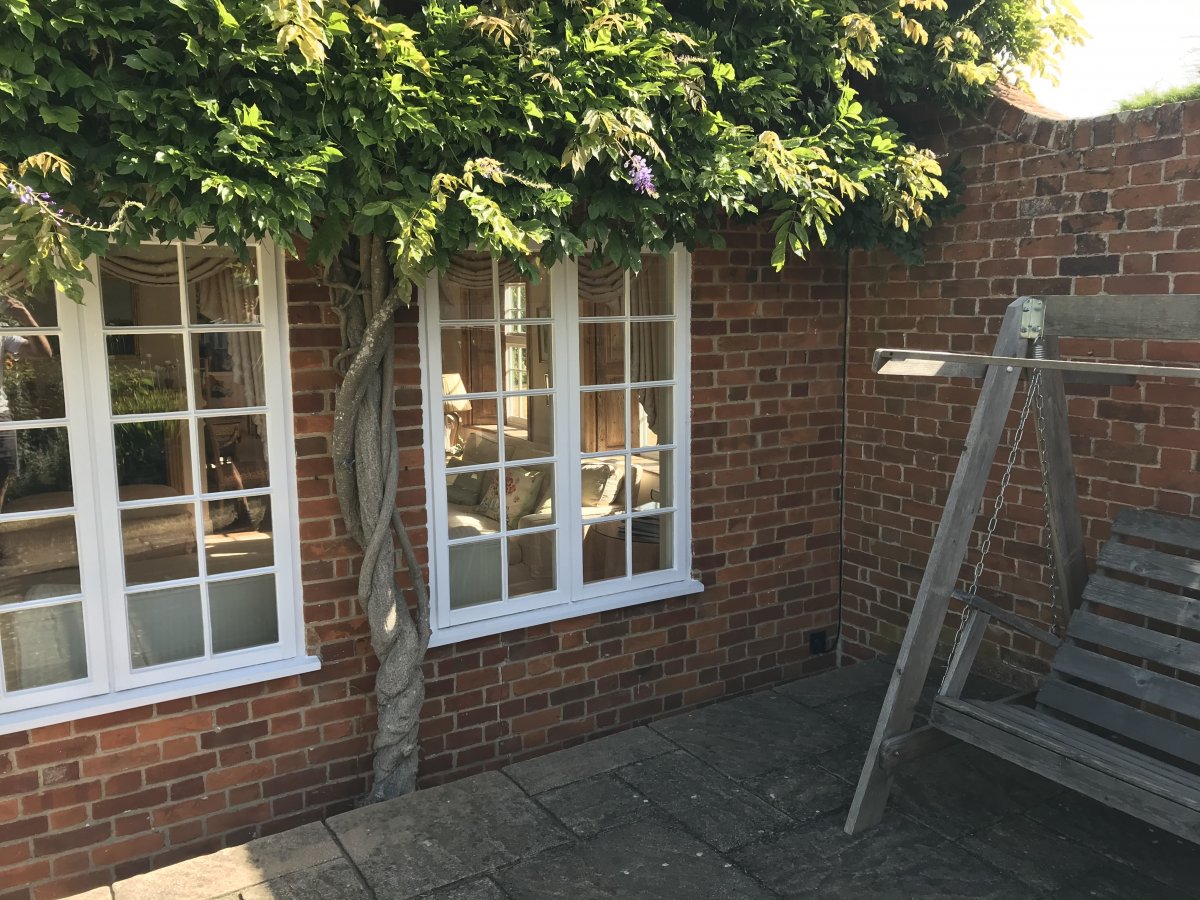

The problem for the retired owners was that the rainwater downpipes at the front was overflowing and not getting away.
An earlier inspection showed a very nice wisteria was the likely culprit :eek:
A 'quote you happy' estimate for works got us the job. Fortunately with so much land we was able to lose the spoil into a low spot.

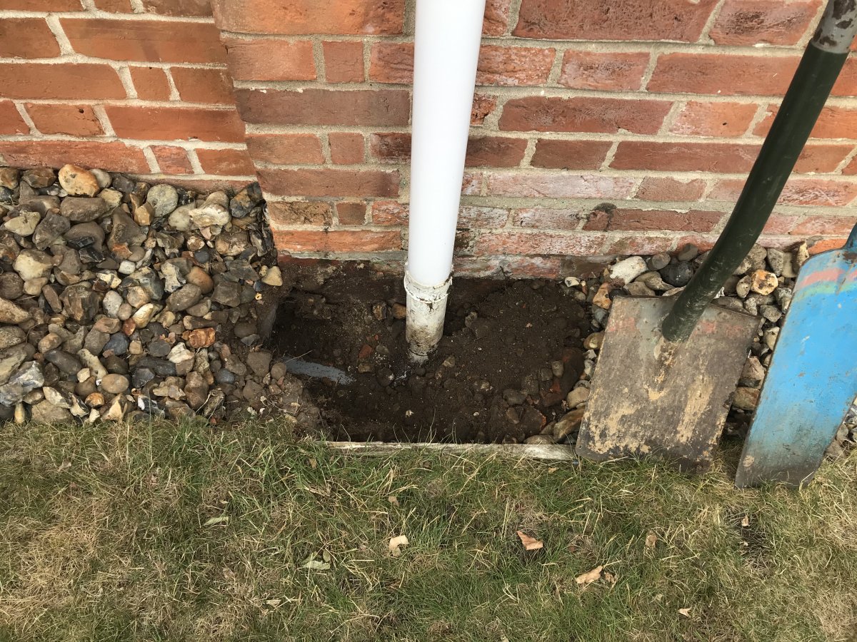

Machines ready for action. Problematic downpipe can be seen on the left.
Quick little 'spud around' revealed that the downpipe was bodged into an old grey pipe which went under the 'newer' wall feeding the wisteria roots :eek:
"Doesn't it look lovely but we have the gardener keeping it trimmed back" to which I replied, "Yes bit look at the damage that it causing to your lovely home"
"Oh yes, we can see what you mean. The decorators have to keep filling cracks on the inside as well!"

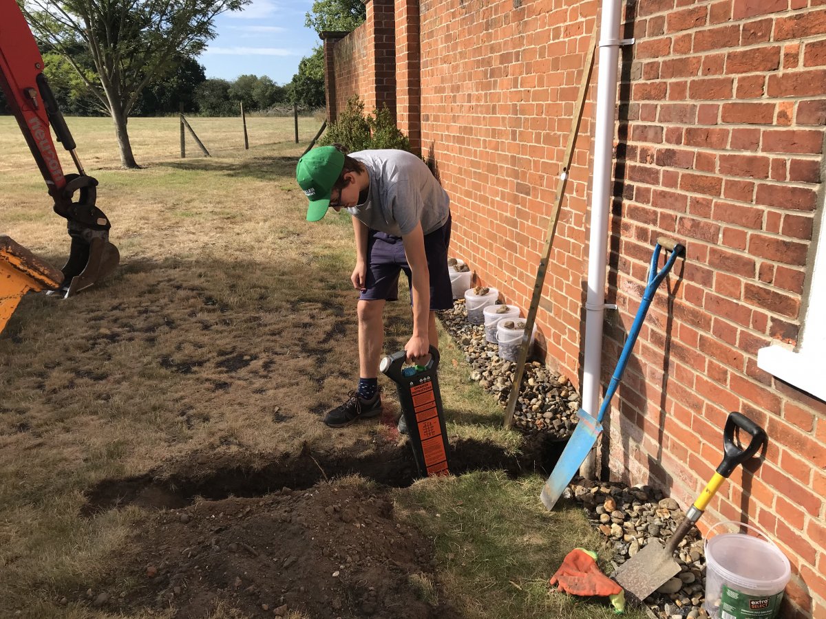

Training Ryan with new skills continues. Here he was introduced to Messers CAT and Genny:geek:
The owners said, "No there shouldn't be anything there"
"What about the power cable coming from that pole to your new coachhouse and flat"
"Oh yes, that must be where they connected it"
Nice juicy UK Power Networks 240v supply found and marked using the trusty old Mark 2
Has it's limitations - should I it upgrade guys :unsure:

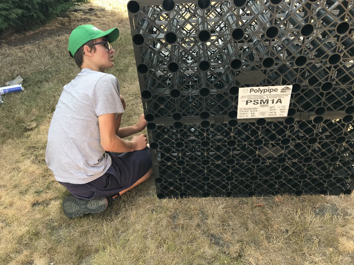

Ryan was then showed how to cube up a set of Polystorm cells
And how to gift wrap them ready to stick in the nice hole..
And how to trim it square and level.....
And give it a generous dose of 'pea shingle'....

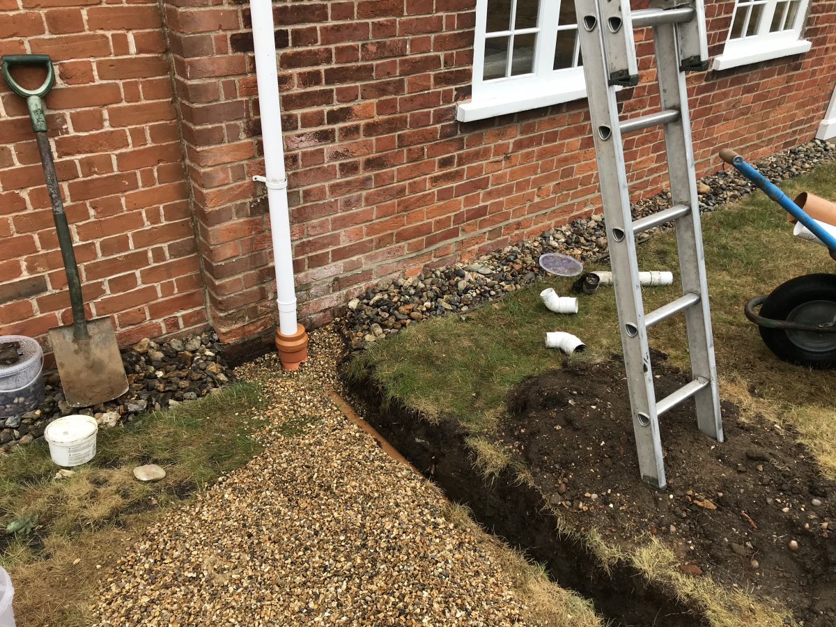

"The most important part of the installation is the spigot" I informed the owners.
"Oh really, why's that?
It covert the 68mm downpipe to 110mm underground pipe. It keeps all the rubbish out of the pipework and holds up the downpipe"
Job done after consuming number cups of coffee and chocolate hobnobs for our perfect customers :ROFLMAO:
The more observant will notice the old piece of grey plastic pipe left to one side.
This is for inspection of the customers - it's absolutely full and choked up with wisteria roots :eek:
The soil is very light and sandy and will need top soil and grass seed in the late summer/autumn.
They know I have topsoil and grass seed.........
Problem with the spigot is all the leaves and crap go into your soakaway ,wouldnt a bottle trap be a better job ?
Routy56
Routy56
Yep you're right there Bob :geek:
BUT the customer did not want a bottle trap.
He said that he would get his gardener to stick a leave trap at the top of the down pipe :rolleyes:
Even if he doesn't it will take about 30 years to fill up and the customer is 86yrs old.......
......when you start looking around there's an awful lot of spigots only 🤣

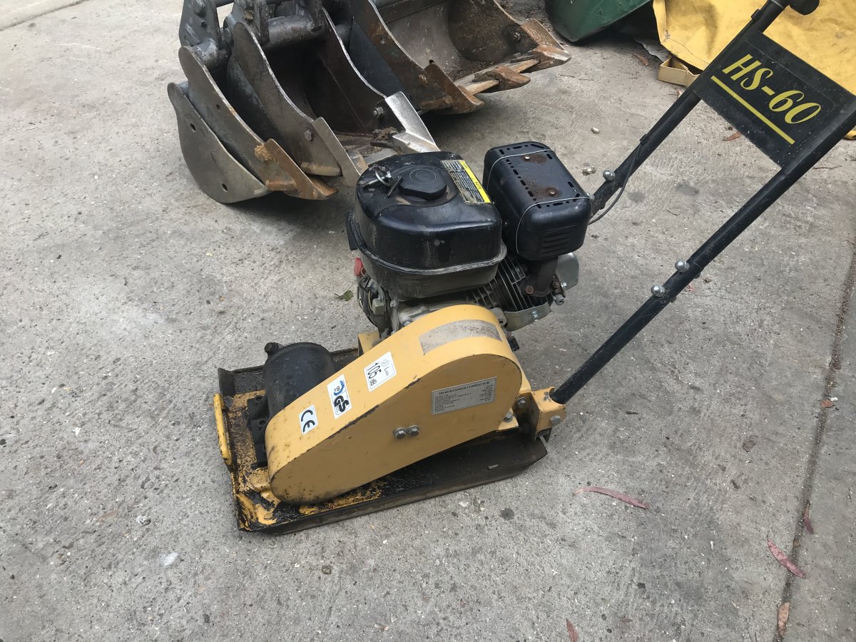

So during my busy period a few weeks ago, we had just finished a large gravel driveway when my old Wacker gave up :eek:
You will already know that the vibe unit has been pissing out oil for a few months now.
And I'd been planning to do the bearing when we had some 'down time'......
After it started making a clattering noise over the radio ear defenders I stopped and scooped up the bits :ROFLMAO:
Belt guard removed quickly showed that the bolt and key had come out of the engine clutch assembly.
A quick fix for that. But not gonna use it again until it's been fettled in the workshop.
So went a bought one of these ready for the next job. The old one can be a spare once repaired :cool:
As an occasional user, for me it made sense to get a cheap one from an eBay seller at only £389
Now looking forward to using it in the next week or so on a few driveway job on the list......

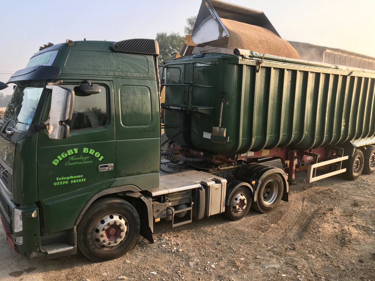

September was grain lorry driving month, giving some relief for full timers wanting a holiday or sickness ;)
Geoff Digby has got 5 full time lorries and 4 sub contractors on the road. Can see his farm from our house :cool:
Had this great lorry for a week while the full timer had a holiday re-fitting his bathroom.
I love the challenge of going to farms down lanes with blue signs.
"You shouldn't bring those big lorries down here!"
R - "You're in the country, what do you think I am loaded with." :ROFLMAO:
Then had this slightly older FH12 for a week or so while the driver was on holiday in Spain - stupid boy! :LOL:
Some may notice the N/S/F damage which he did and I got fixed before it's MOT :cool:

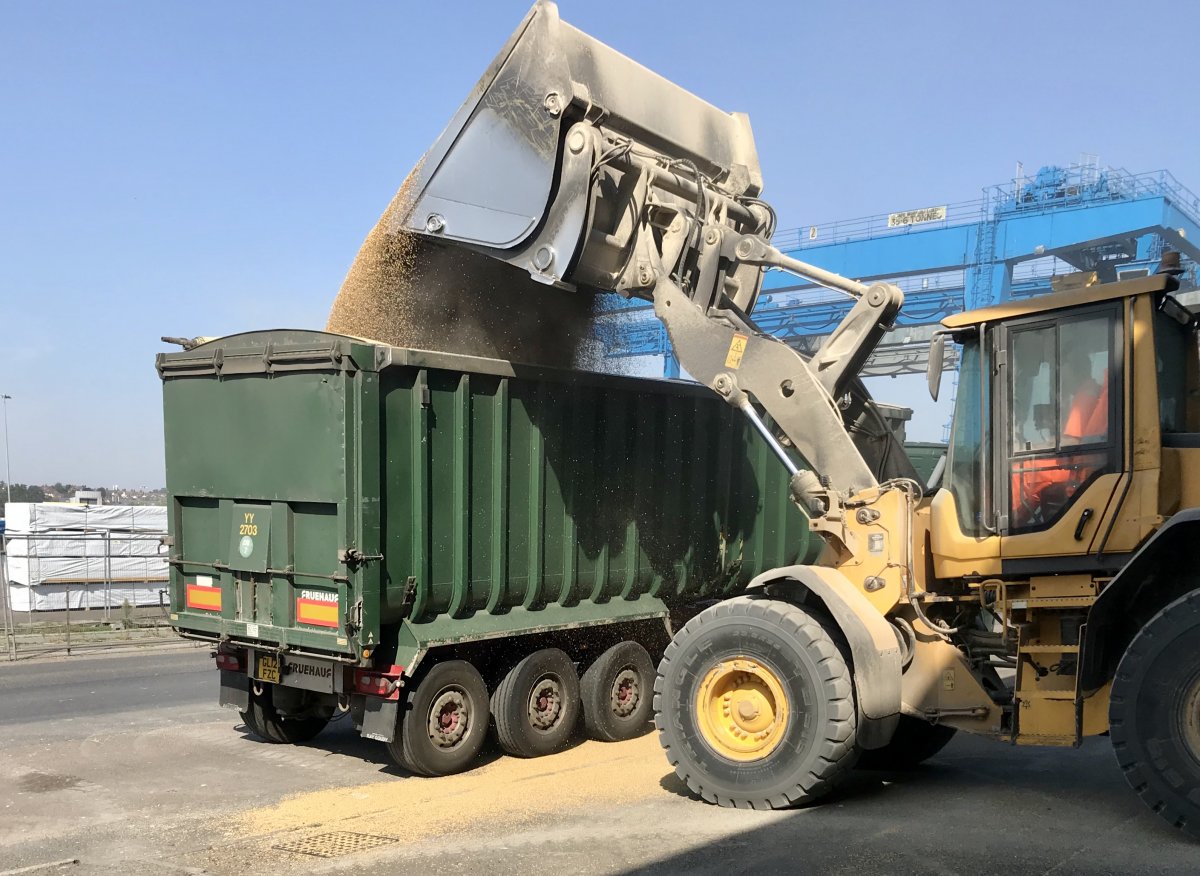

Ipswich Docks - we took loads of malting barley out to Witham.
These loaders drop about 3T per bucket straight in giving a full load in about 4 mins :cool:
Carrs Flour Mill at Maldon down by the river Blackwater.
Absolutely love going here. Great bunch of guys who always give you a warm welcome :)
Then my mate Jim Maynard rocked up with his immaculate FH12 (on cherished plates). He is an owner/driver sub contractor.
Known him most of my life. Our dads were good friends. Introduced him to Geoff.
It's often who you know in this business 🥰

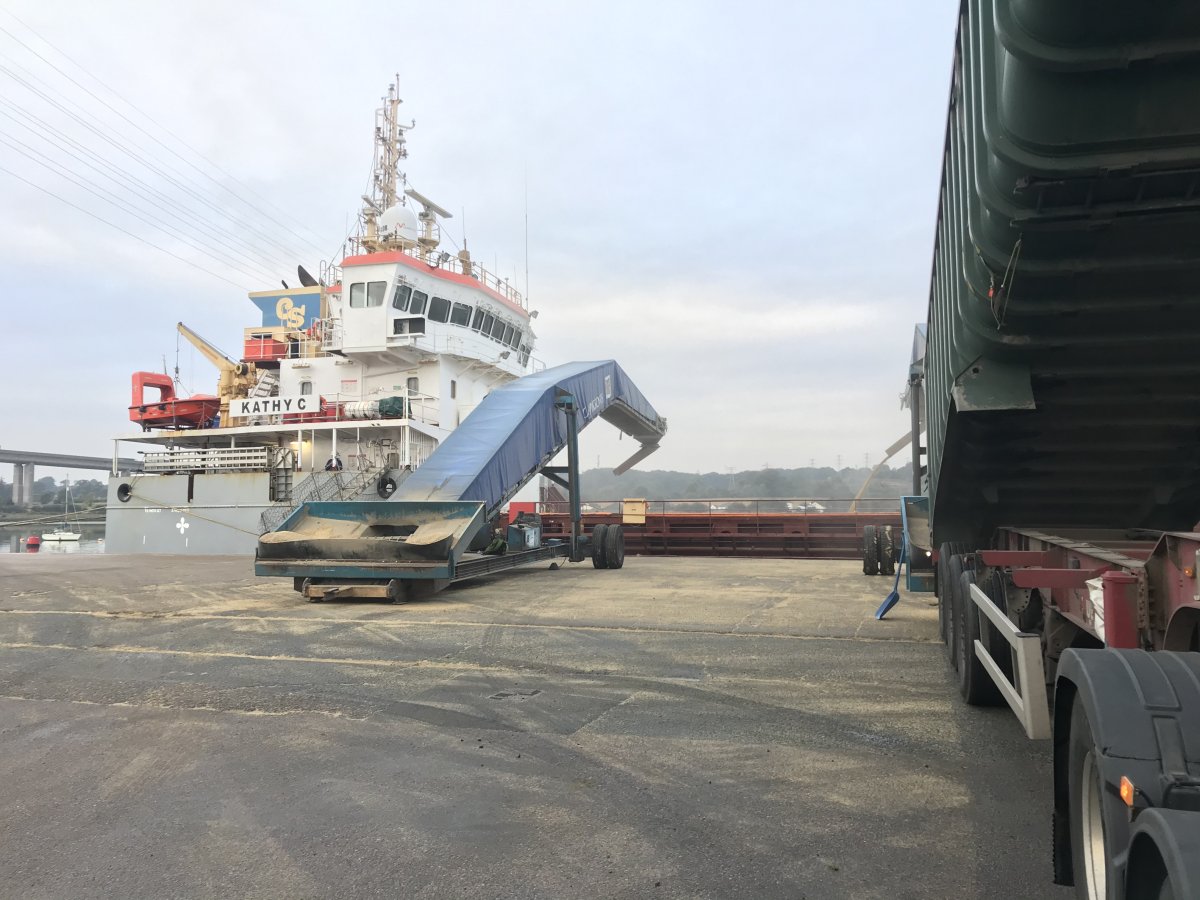

Then we had to do a barley boat at Ipswich Docks. It's go go go - managed to get 5 x loads there one day :cool:
They had 4 of these elevators running to get the job done.....
You gotta keep an eye on things when tipping this stuff.....
Cos if you get it wrong you end up with tons of it on the deck :ROFLMAO:
There's loads more to tell but September was enjoyable out and about playing with lorries😊

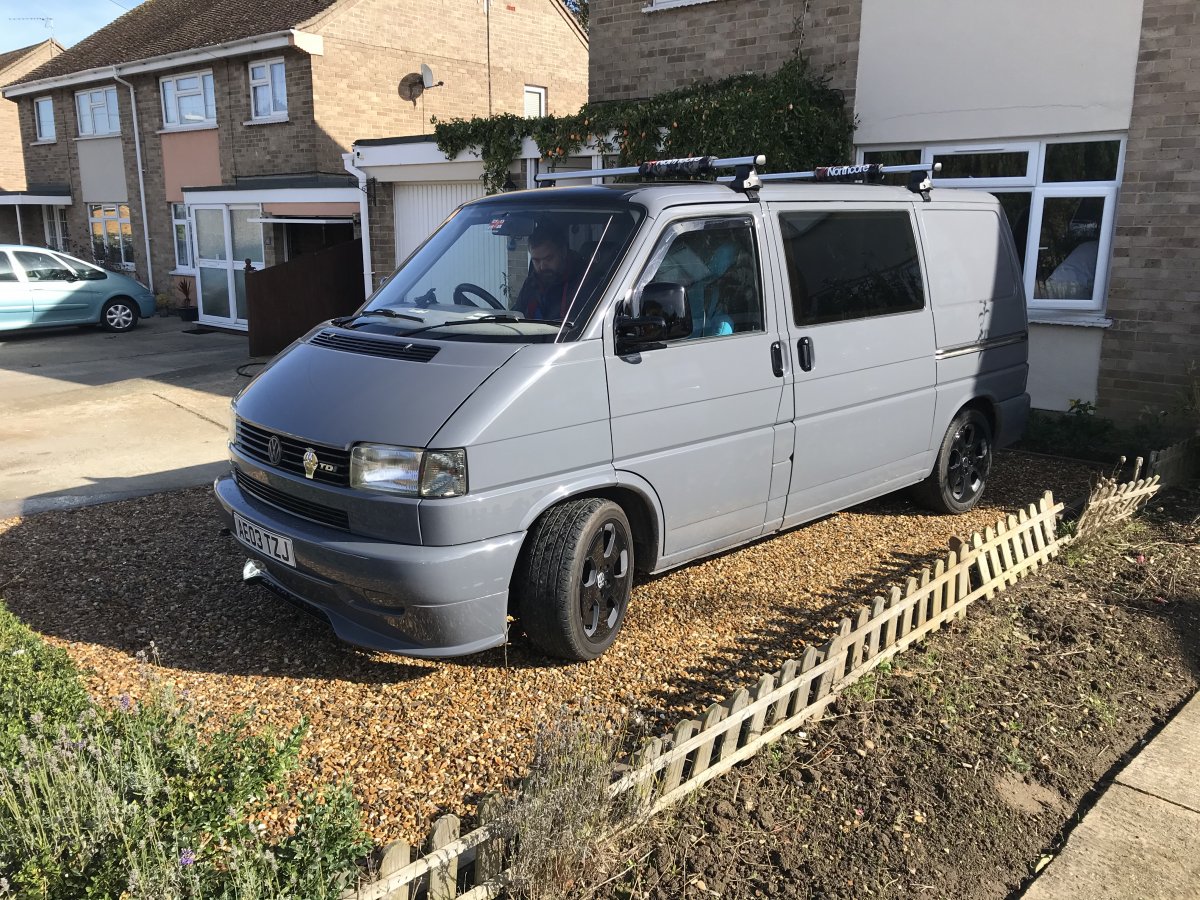

October is digger jobs :cool:
Last week started on a 20m2 gravel parking area for a camper on what was a front lawn.
Took the tipper loaded with concrete stuff for the edges - remind me that this is Groundworker stuff :LOL:

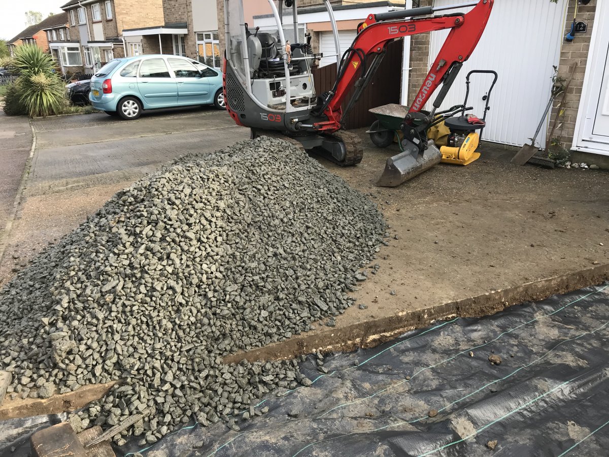

Dug out the dirt and set the edges.....
Tidy site is a safe site ;)
Geotextile and type 1 to go
Wacked to refusal with my new Wacker - so pleased with his new toy :)
Permeable because of reduced fines.....

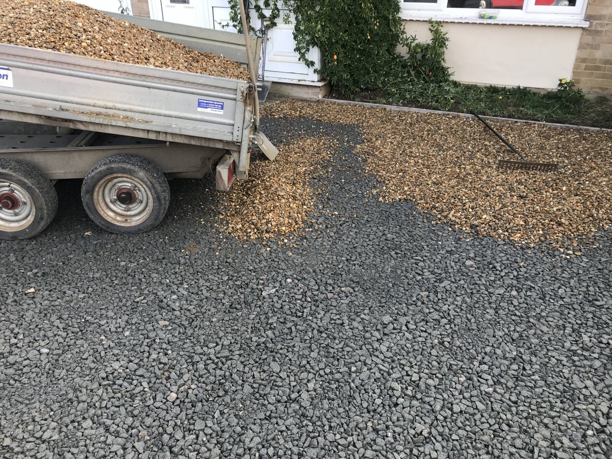

Added a few tonnes of 20mm stone......
Grey camper vans are very popular at the moment. He's only gone and bought a newer one. The one has now been sold!
Customer was absolutely delighted 🥰
