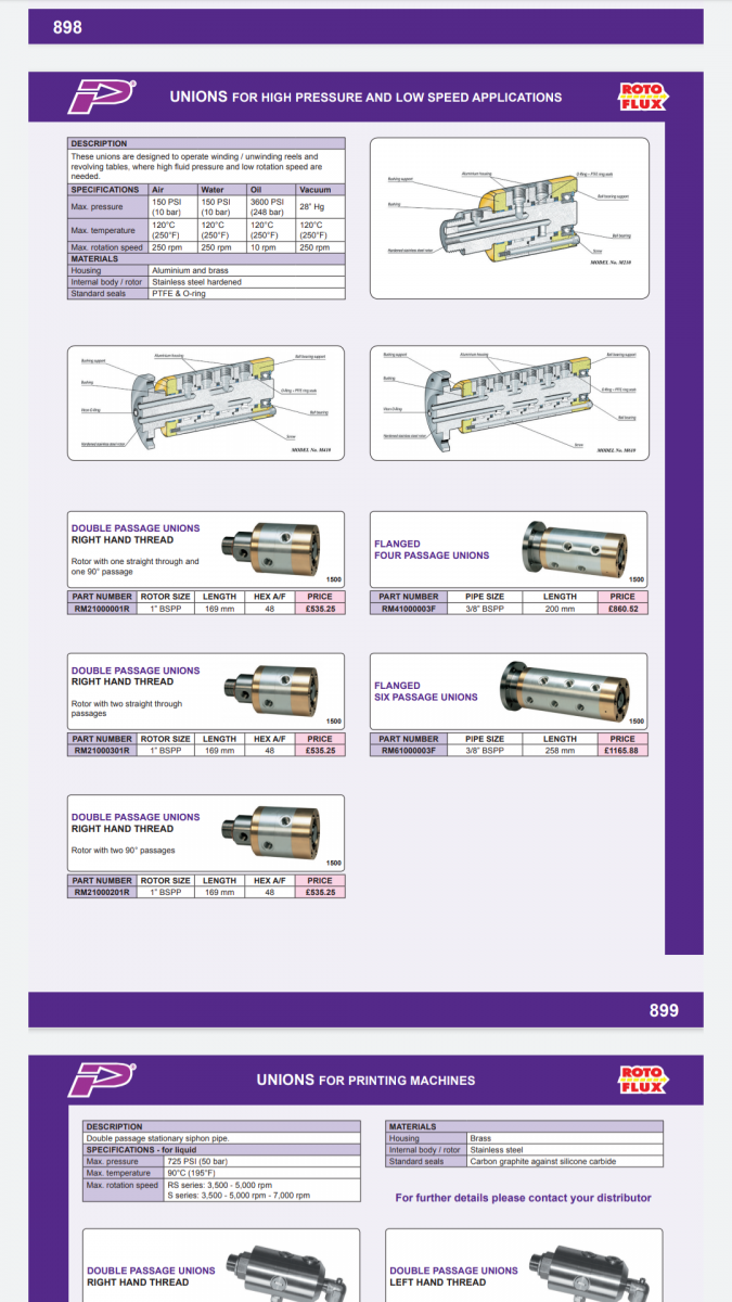

that flanged 4 port is half the price of the RoemheldsView attachment 17405
I'm thinking 1/4" ports might work. They appear to be rather expensive and in long lead times![]()

I got one from deublin, had in stock was just over £6 ton but is new ex manufacturer and the right thing for the job so all sorted thanks again![]()
aye it's a good price TBF, for a new unitHad some quotes for I've £2k for some so think 6ton is reasonable. The second hand unit from Athens was £4ton and who knows when or if it it would arrive.
