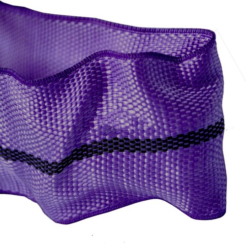

buy a 1t endless sling and just hang it .. cheap as chips and easy to sort

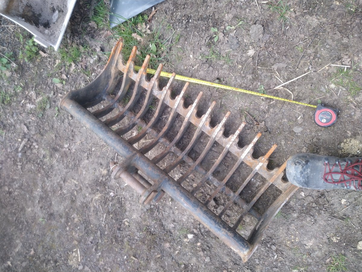

I've just checked it's 70mm centres and it is a digits one.

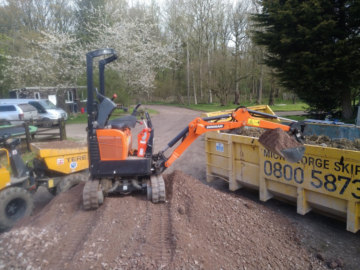

900mm buckets are fine on these my 900mm grader is off a dx19 and not too bad
A Mick George skip? Where are you working, Brendan?

The one I made for myself I took a punt on 4” specing with 5/8” thick tines. I’ve found that spacing works a treat.
I don't think I'd want a bucket hanging off a sling on a micro while trying to negotiate a tight gap you might even be struggling to get the arm high enough to keep it off the floor getting a pin welded on at 90°to the headstock might be a option if it's a quick hitch machine or it's a micro bucket just pick it up with one hand and carry it
