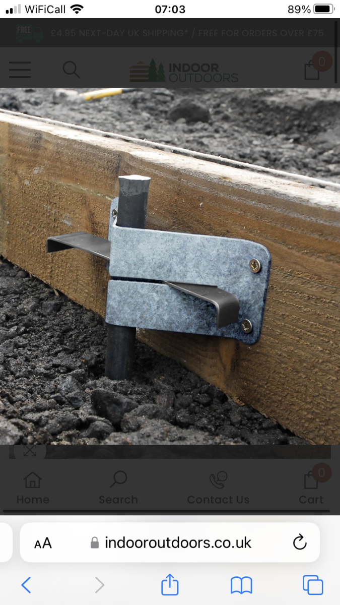

I have also seen screw on clips for timber that allow you to use steel pins.

I've got a crate full of those metal clips for wood. They're OK-ish, but the pin supplied are nowhere near long enough. Even if you buy longer, they will wobble about due to much less surface area than a wooden post. I also don't trust them with a beam tamper, they are liable to continue driving into the ground. Basically you've never got exactly the right steel pin that can be driven in deep enough to hold well but not stick up proud.

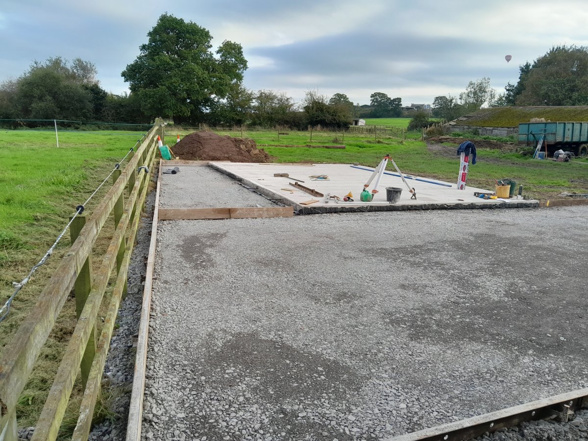

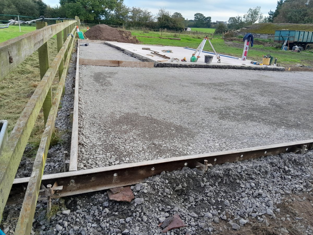

I’ve got a plans to lay a couple hundred cube of concrete to lay over the next few years at the new yard. Tracks and roadways + yards etc, some of it with curves as well, hence thinking about road forms.

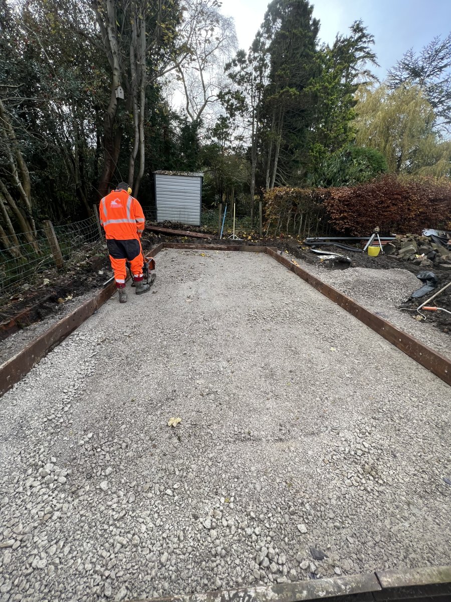

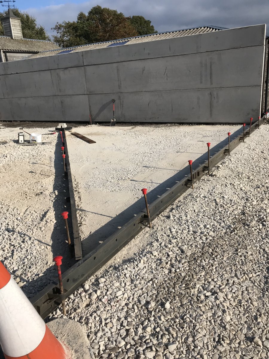

I like using roadforms for larger slabs, find them a bit quicker than timber but very few hire companies keep them now as nobody looks after them. Only people that keep them in this area are Marwood group who have a few depots around the country and may sell some off perhaps 🤔
Recently bought 10x8” and 10x 10” snd 4 x 4” at an auction for £450 2 bent though so will need straightening so far easier than all the timber shuttering I’ve ever done
