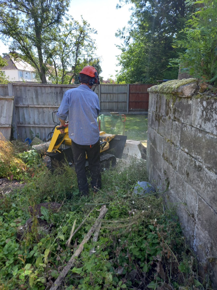

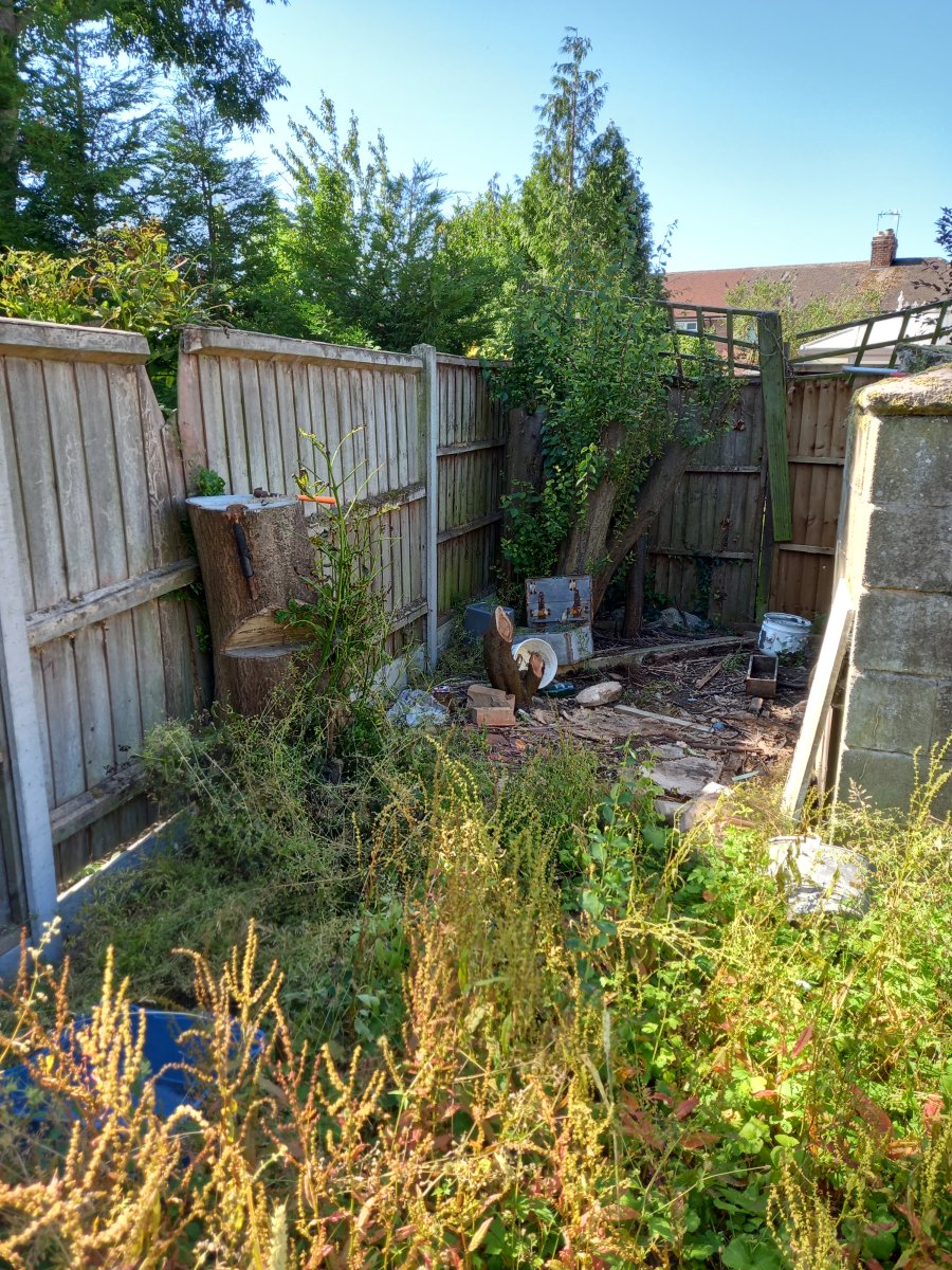

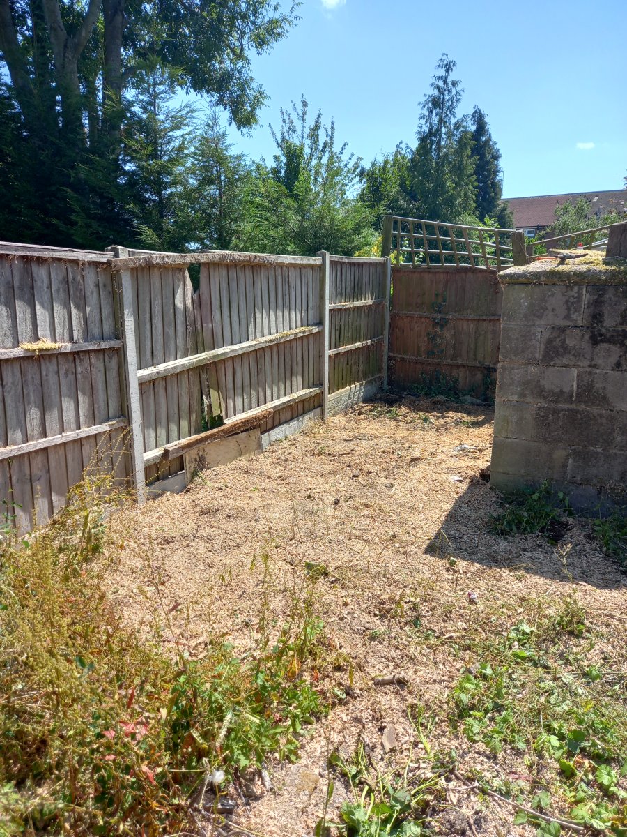

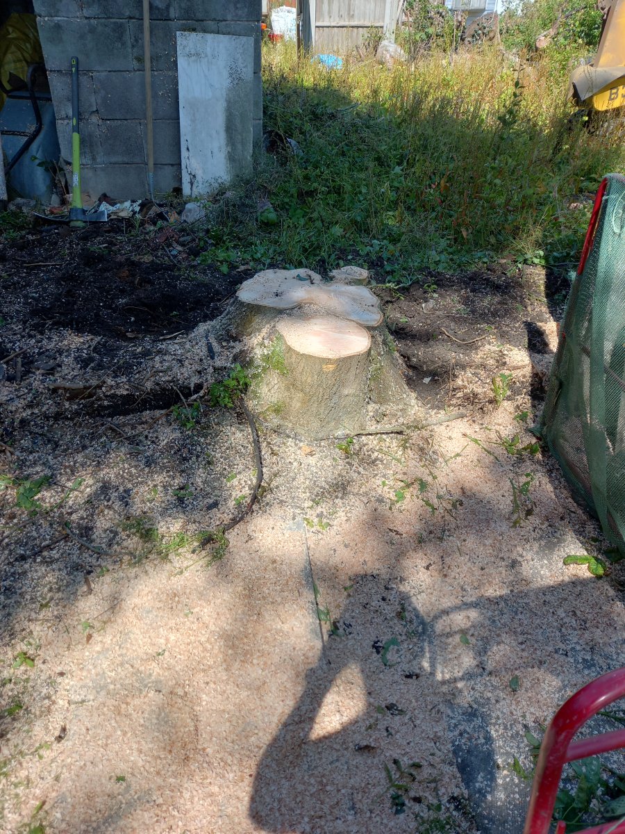

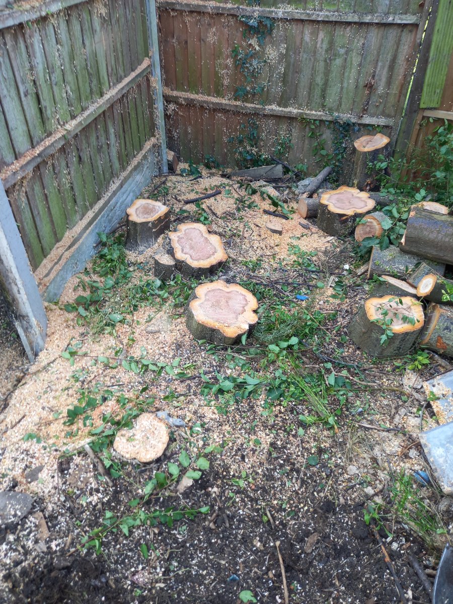

Today was the day for the back ones. Even managed to salvage the fence panel wonder how long its been there around that tree?!
