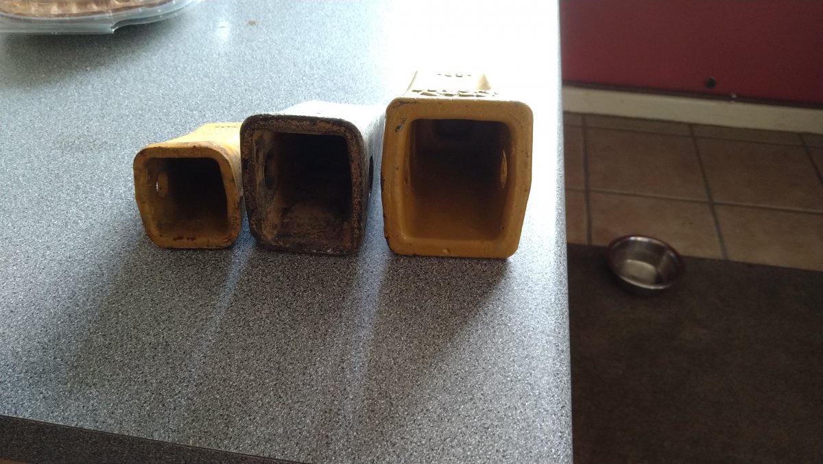

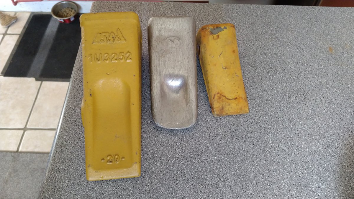

Got my 205 today and it was still too big having a 55/65 opening when I wanted a 45/55 MM opening.got it fitted by welding a 12 MM spacer on end of tine and 6mm on top and some beads of weld either side of tine so my tooth not fits snuggly and having tried it,it is fine.i emailed harford again to ask if it should be a 205 or another size.they replied another size so I asked what that was and they would not tell me do a big thanks to kirstie for that.ill remember that next time I’m after something.pics show my tooth in middle,small one is a 200 and big one is 205

Aside from the difficulties you're having sourcing or even being told which one you need it's a bit like @Routy56 and his dumper tyres where i look and think there's life in the old tooth yet.
