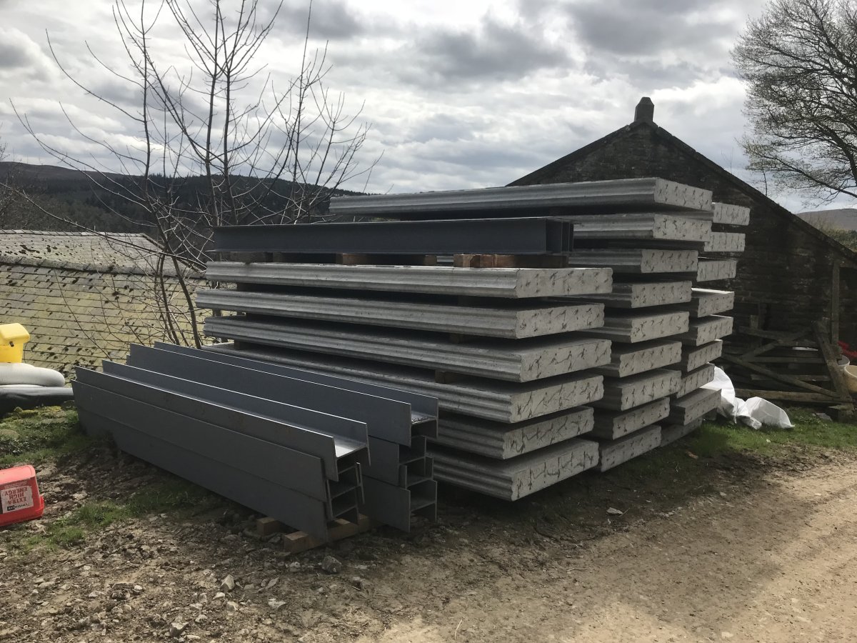

don't think they'd be up to a retaining role .... more stress free walling, but if there ain't a lot behind 'em they'd make a lovely walls

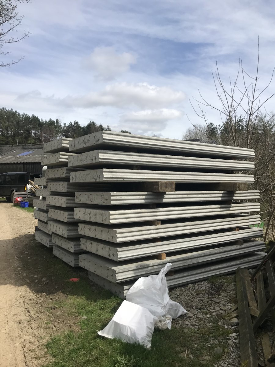

They use them as walls for silage clamps and grain stores - there is a curve to them so they have a ‘strong’ side (for pushing against). No reason that couldn’t be reversed to retain soil etc but I guess you would need to be careful then pushing against the ‘weak’ side (which shouldn’t be an issue if the strong side is actually retaining something).
do you have a good source for the concrete sleepers - make excellent roads/hard standings too, if you prep right (y)

so they must be pre-stressed, specifically for the job, much like floor beams ... all the wall panels I've seen round here are gun barrel straight / flat

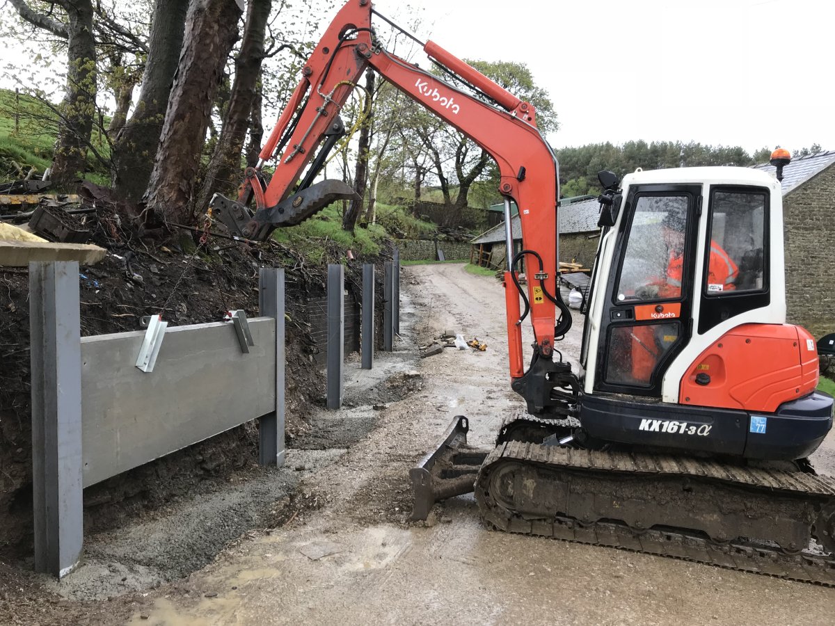

Even the flat ones are pre stressed. I've done a few kingpost retaining walls and we always use ones that are symmetrical.
They use cable in them and tension it with hydraulics. Then cast the concrete around the cables and release the tension.

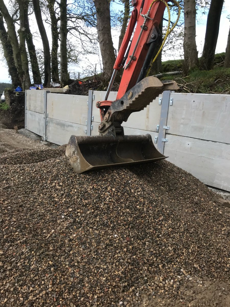

They are plenty strong enough for retaining walls. The kingposts will give out before the panels. We did one that was at 2m centres and 4m in the ground for a 2m high wall in running sand.

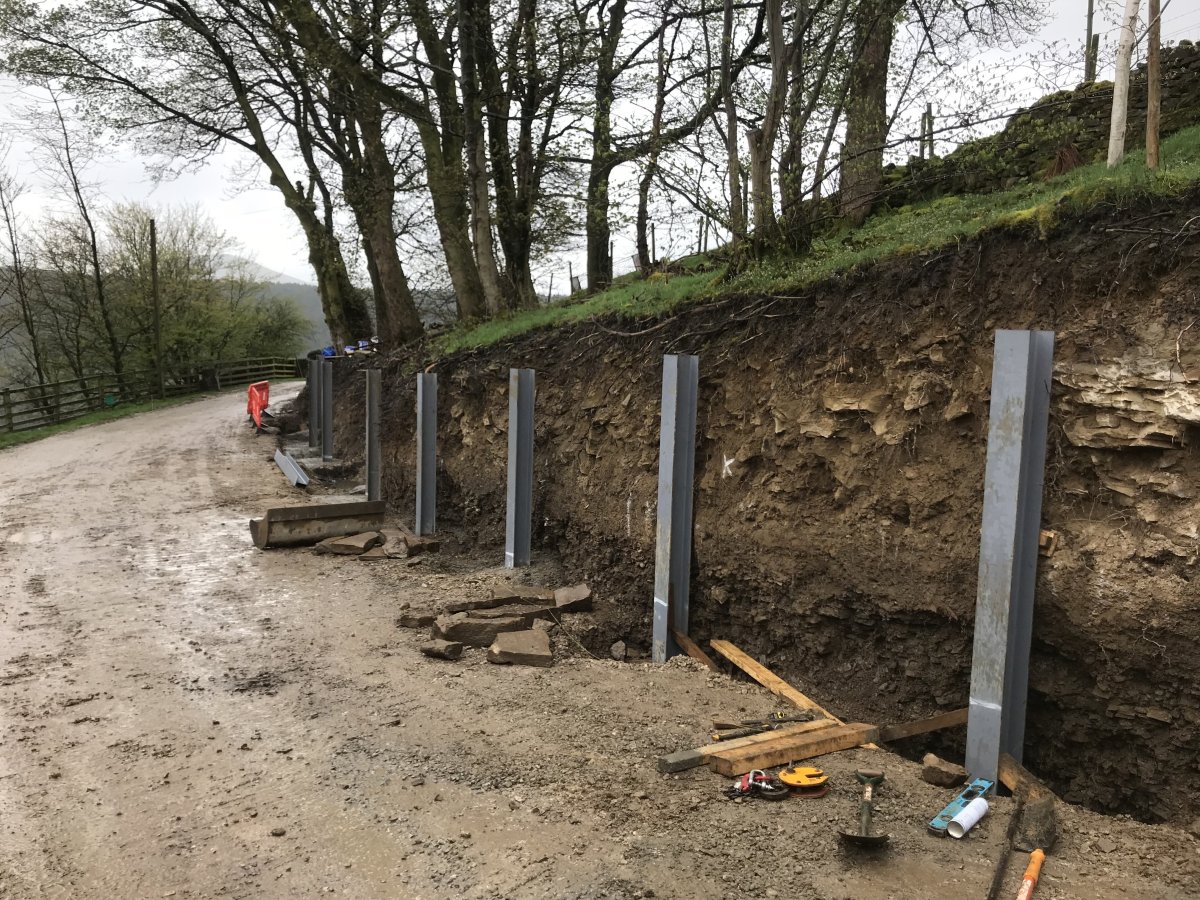

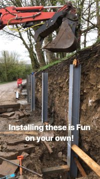

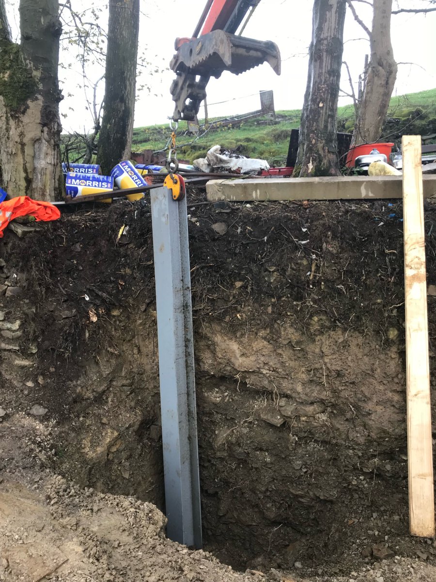

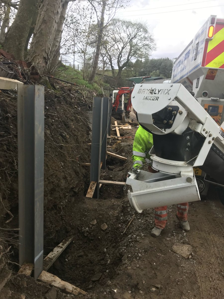

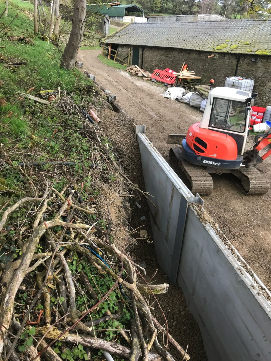

I was thinking 1m in the ground (soft rock) and 2.4 high above ground . Backfill with 40mm recycled concrete

I would think you will need it a bit deeper than 1m. All the ones I've done have been at least as deep as they are tall. 2.4m has the potential to be some serious hydraulic pressure.

Will dig a test hole. Its more to give a flat edge than retaining as its mostly virgin rock. Wont be any hydraulic pressure with sleepers (gaps every 300mm) + granular backfill and drainage I shouldn't have thought?

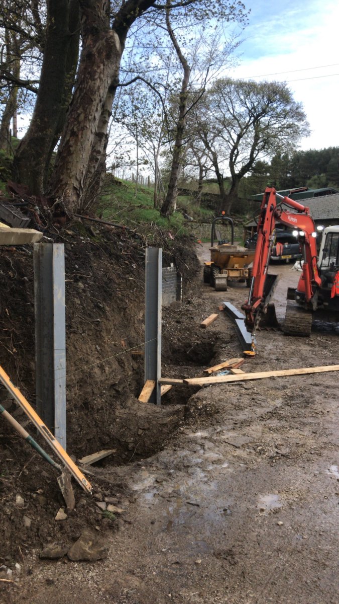

Silage pit I took out at home was about 1 meter in ground 2 meters out, each steel had about 2 cube around it.. didn’t move!
We have only ever done augered holes just big enough to fit the rsj. I can't find the photos of it but one we did the holes where done with a piling rig. 6m deep in chalk in godalming. The 13t couldn't lift the steels in from the ground so it was parked up the top on retained ground.

yeh I should have said pre-cambered and prestressed - there're a few vids on you tube of them being made and how they stretch the rebars

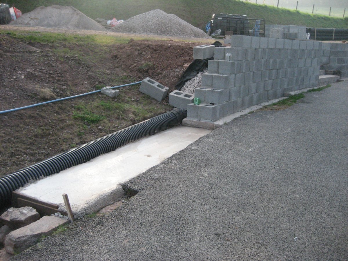

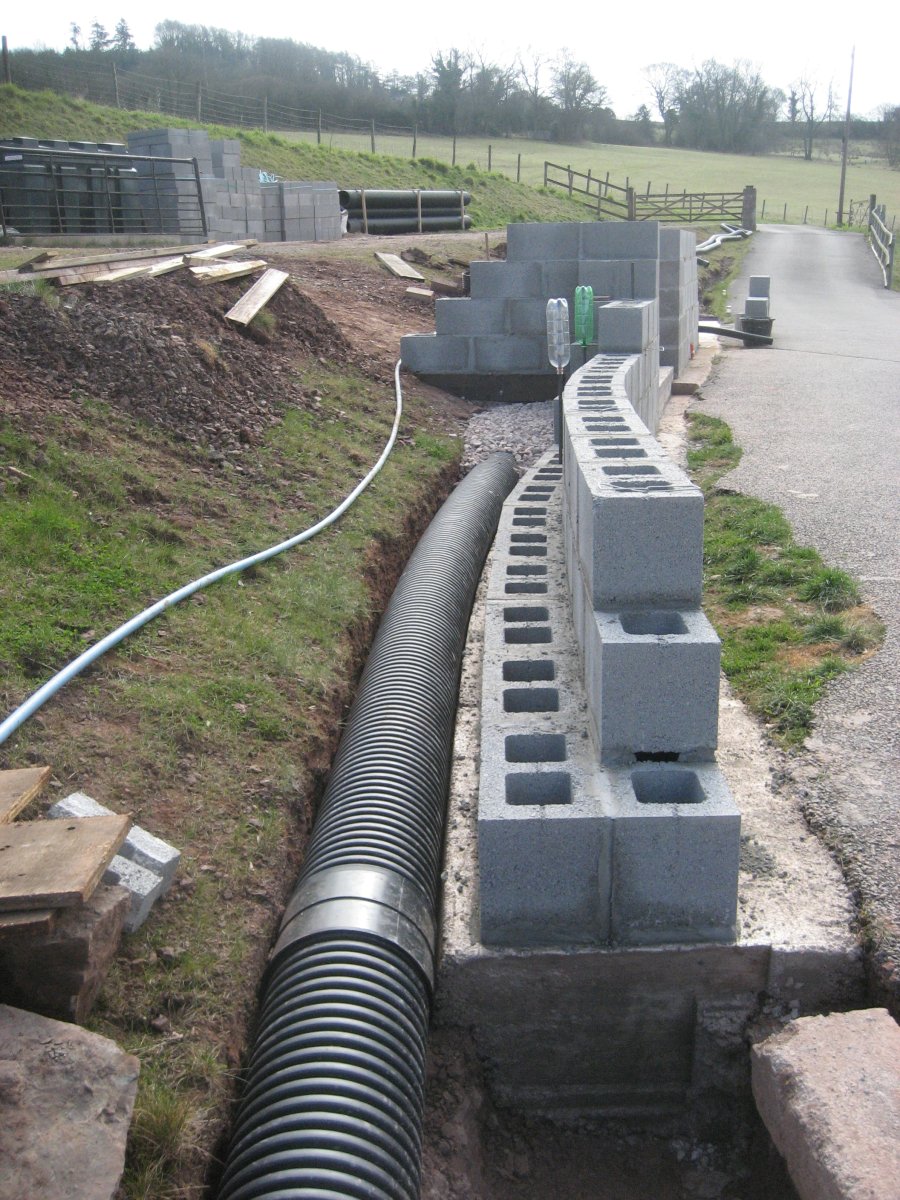

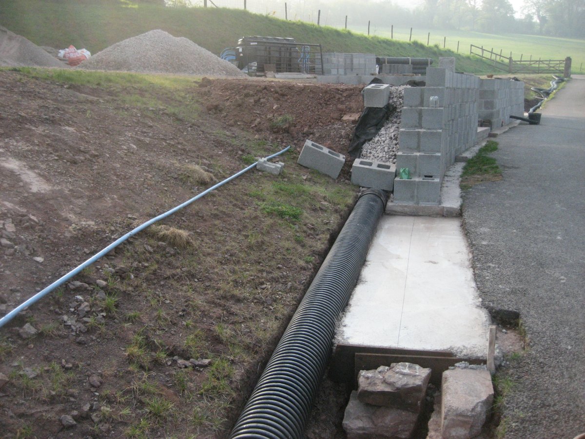

Solid plastic slotted is better stops fines blocking it up
yeh - like this stuff - 10" bore IIRC

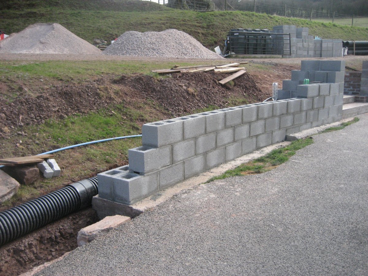

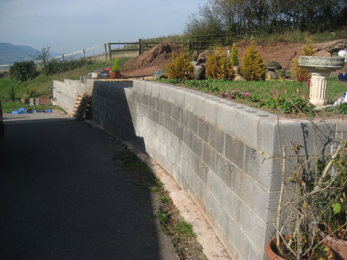

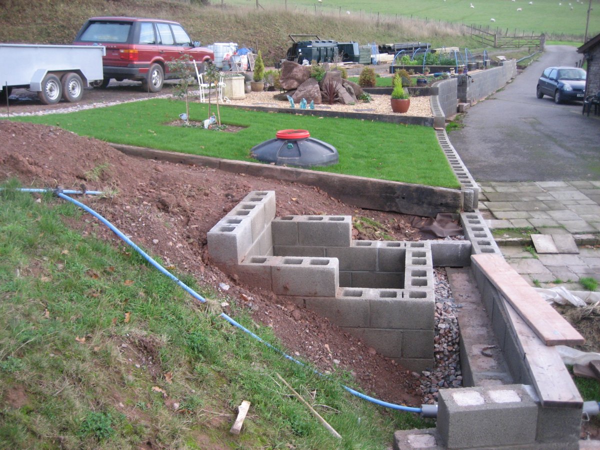

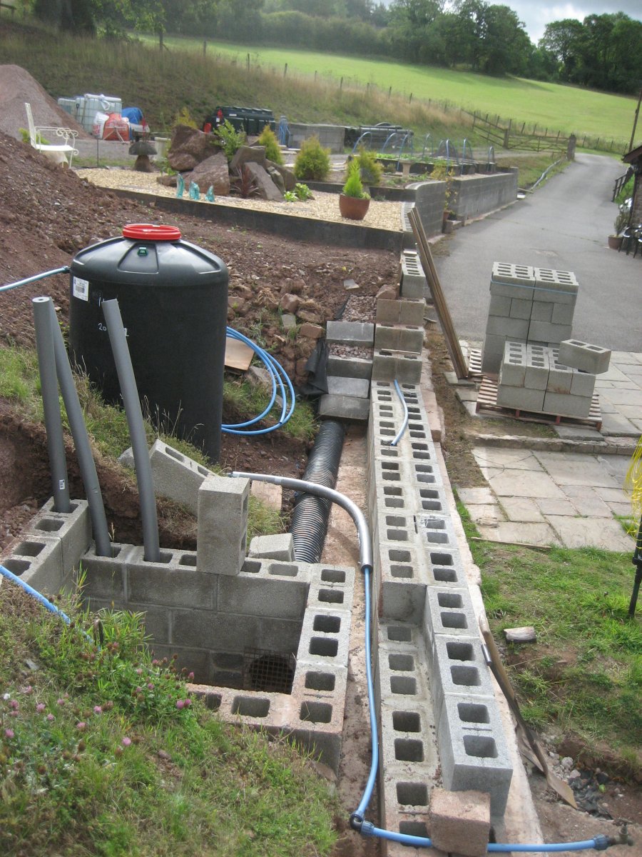

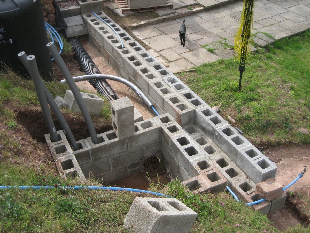

got pretty adept at laying them 9" hollows after 1200 of 'em ... would never be able to earn a living doing it - too slow - but it won't fall down
impatient 'boss' wanted it flat and green, faster than I could get the bloody wall up

Engineer designed will have drawing somewhere we had 1.4m or more into ground about 1m3 per steel in rocky shale
