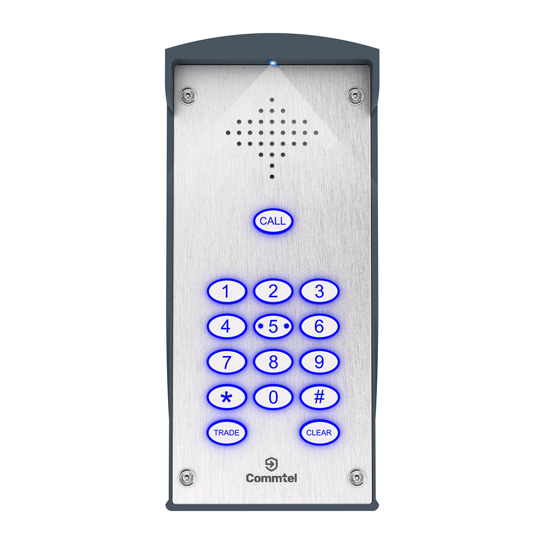

Had exactly that scenario a job I used to look after. I think this is the product that was on the outside gate post;
I also set up a camera like you said that looked at the gate that you could view remotely and then you could just text the gate to open it and close it etc or hold it really handy.
There was an app that you could add people's numbers so they could be allowed to open it and things like that
That looks quite good, I'll have to look into it 👍
Yes that’s what I’ve got. Seems ok 👍🏻
