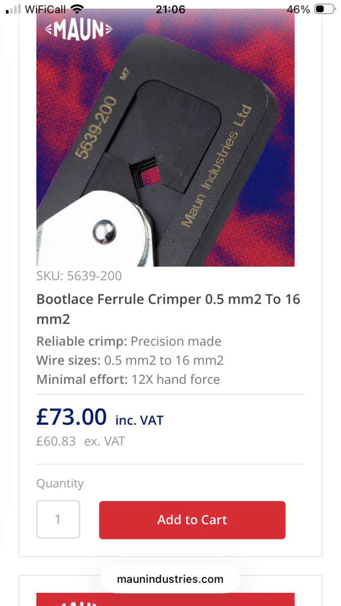

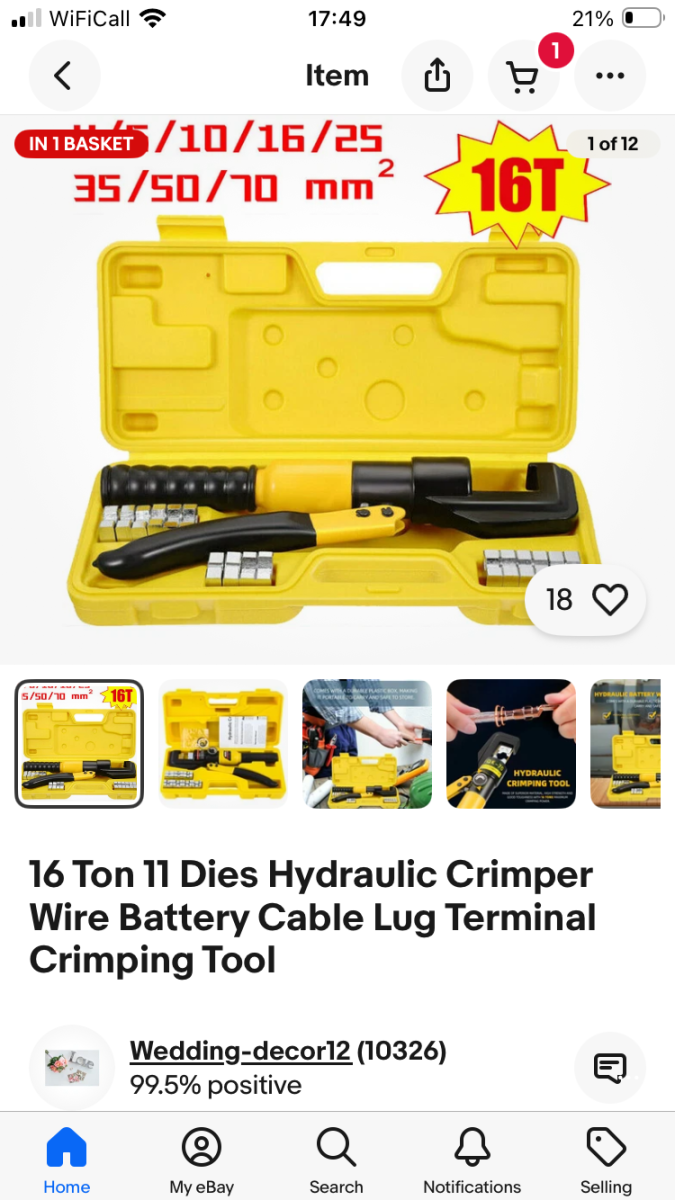

Have a little project on the go where I need to make up some 16mm2 cable ends. Lots of cheap crimpers about , but wondered if anyone had tried anything like these ?

eBay sellers never disappoint do they..."wedding decor" 🤔😂
ditto .... way quicker and easier than pumping the tish out of one of them and trying to keep everything where it should be
50mm2 is still a blunt-ish chisel in a V block :giggle:
0.5 to 16 ? I'd suggest they trying to much . Be damn un wieldy on 1mm
Yeah my little ones go up to 6mm2

Mines old version of this iirc
I'm away ATM so can't check but never let me down. I'm sure mine goes up to 75 though as I've deffo done some 75s on a Genny
For bootlace small stuff get the knipex if you feeling flush but recently bought another set of copy off Amazon and it's fine ..
looks much like what I have, on both counts
