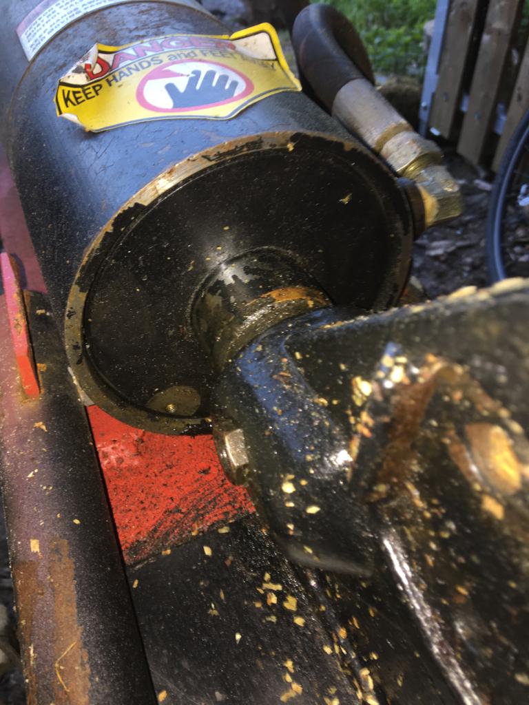

Ram seal replacement
I've sent you pictures on Facebook messenger. It was the only way i could do it. You might be able to put them on the forum
sorted Boyo .....
as I said on FB earlier Dylan ,..... peel the label back and look for a grub screw under it ?? :unsure: .. or anywhere else .... or even a pin in the cylinder wall ??
Was thinking threaded as rotates freely ?
unusual to be threaded without being wound down to a seat though :unsure: and with only one drive hole in the end cap :confused:... fair chance of leaking past the threads too .... ;) ..... will be interesting to see the final outcome on this one (y)
Left hooker
Left hooker
Main side to ram would be piston for pushing rod side just for retracting back for another go

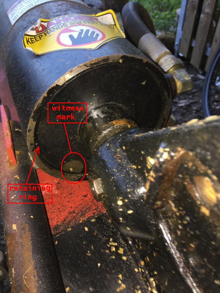

Would have o rings to seal against cylinder and snap ring to stop coming off with lock washer/bolt to stop cap turning?

Remember having one that had ball bearings in a groove behind a grub screw to hold the cap on

He got it out today. Bigger hammer and 8t jack. Hes asked me to thank you lot. So thanks
