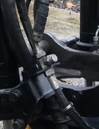

Had a pile cropper on hire in Jan and it was a bitch to de-pressure to get the connections on! Two adjustable spanner’s and a dribble of hydraulic oil was the best I could come up with!
K
Komatsu
nifty idea that Ollie :cool: might just 'nick' that idea (y)
Originally was going to stick a little tap there, but when it was on it just looked to bulky, so just put that it, just have a bit of rag handy to wipe up any excess oil.
yeh ... tap'd be a bit of a liability and'd make a hell of a mess if it got caught inadvertently .... or worse ... knocked off :oops:
