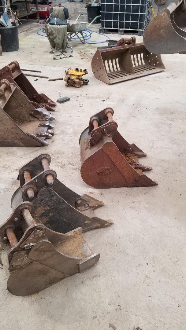

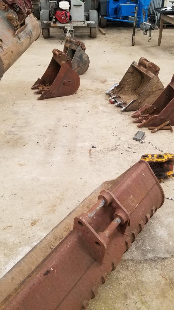

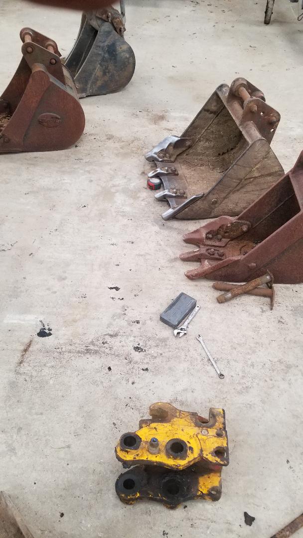

Got a KX71 a bit back - I already had a decent set of buckets and a hitch from a JCB 803 from years ago - when it came I took off its hitch and put my hitch on it and used all the buckets no prob.... there was a fair bit of slop in my hitch so thought I would change the hitch to the one that came with it ..... strangely the Q/H that came with it will only pick up half the bucket set and the others are too tight ....quick measure round shows half of the buckets have 125mm centers and the other half 130mm centers
What do think best plan is ? dont want to buy another hitch as plan to buy a powertilt at some stage and would like to use the hitch that came with it........... butchering the actual hitch which is for 130mm is going to make it slack on half the buckets so I suppose its a matter of grinding the pins in the wide spaced buckets
Thought I would ask opinions on how best to do it before sparks fly .... 5mm off the back pin 2.5mm off each ? or is there a better idea ?
