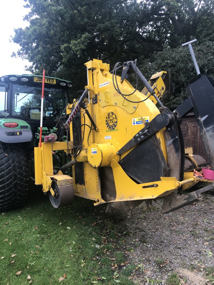

The trencher was good and simple enough to use, it suffered from lack of weight to be honest and if it hit a flint, it tended to drag itself forward until it finally got the obstacle out. There didn't seem to be anything it couldn't dig through, and I pulled some monster flints out with it (not in the sports pitch bit in my photo but in the rougher dig areas). Obviously the deeper you go, the slower at digging it is but I would say you should get 100m/ day out of it from what you describe. In sand/ softer ground it would romp along!
Personally, if you can make a mess, a 5t excavator would probably be my choice of machine to price in. Narrow bucket, enough power and a nice warm cab. Standing by that trencher all day did become a bit dull. But it made a very neat job and that was more of a priority for me. To be honest knowing me, I would price for a bigger machine, based on 100m digging a day and have a hack at it with my 2.7t and see how she gets on. You own it, even if it takes half a day longer than you allow you would still be £££'s in and with some teeth on a nice narrow bucket, I don't think you would be that far behind the bigger machine. Or hire a bloke with a 3cx? Perfect sort of work for it and you don't have to even do the job!

Or use one of these and have it done in about 20 mins! 😁

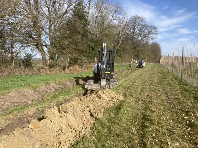

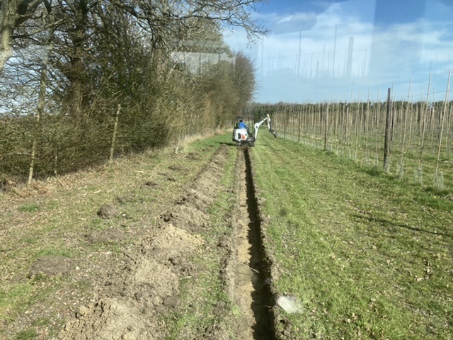

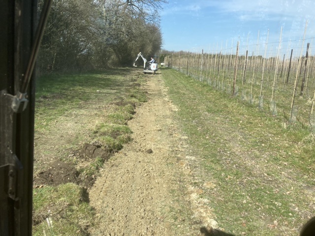

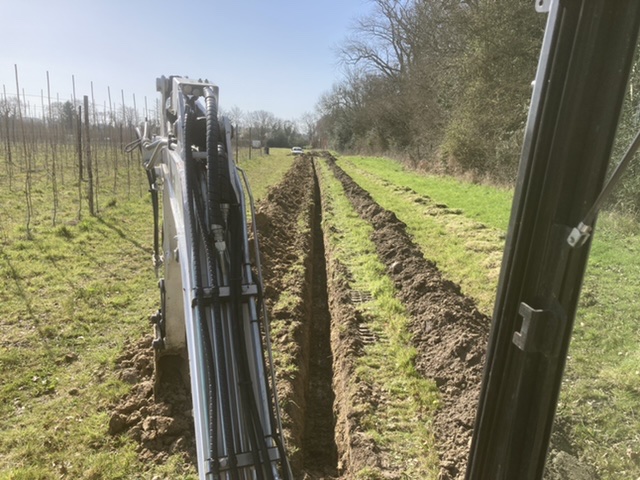

Keystone XL is progressing well. Did 150m between two of us in a short day yesterday, including repairing the original main and putting in a couple of mole launch pits. Should smash that today.
Mike has the e19 with the 18 ” flat blade and is stripping turf then topsoil for pipe bedding. I’m following with the e27 and 9” toothed, and it’s about an even match.
£6 ish per metre inc 32mm pipe.
