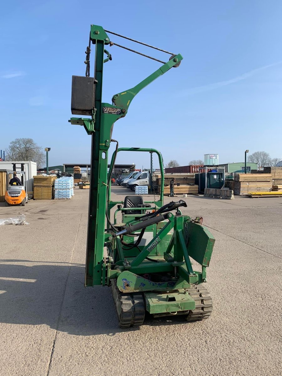

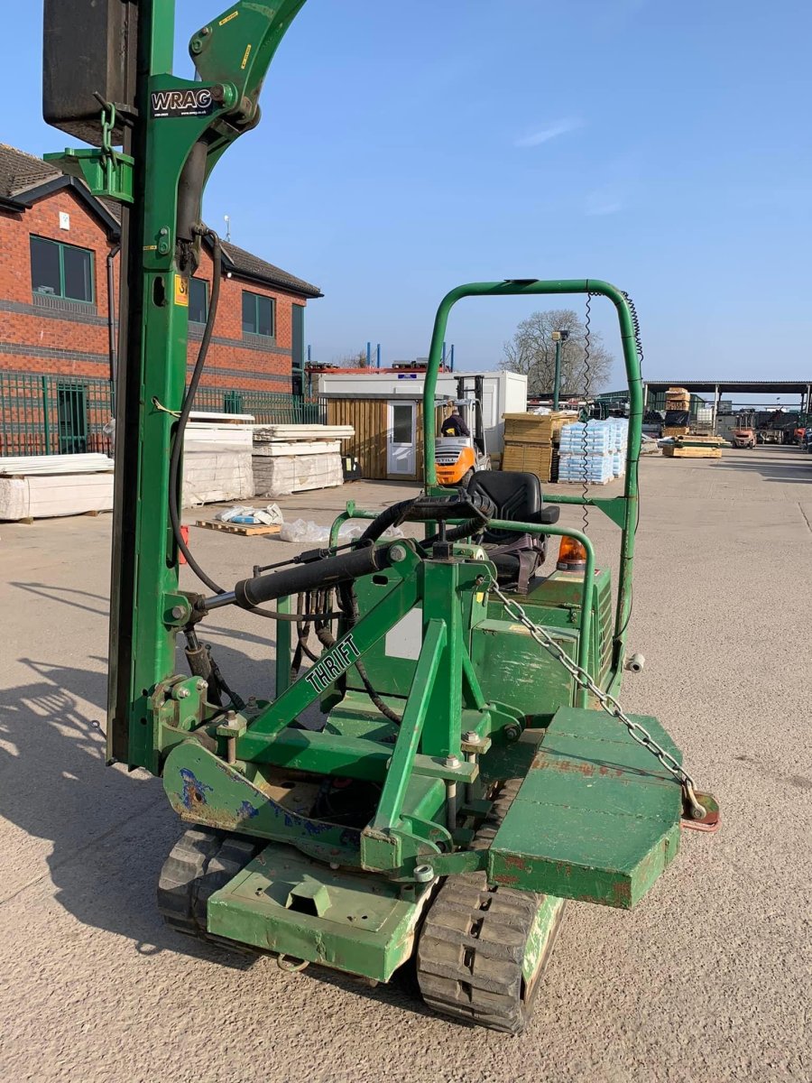

Will do something like this
I'd be uprating that pump as a matter of course, 12l/min is painfully slow. I also strongly suspect the pressure won't be enough.
Is the dumper full hydraulic drive or is it hydrostatic with steering clutches? If the latter I think you'll still be jumping on and off it unfortunately.
It's these factors that have stopped me looking at making a knocker mount on my dumper.
Fully hydrostatic but bigger belt drives pumps for motors vs small pump for tip/swivel

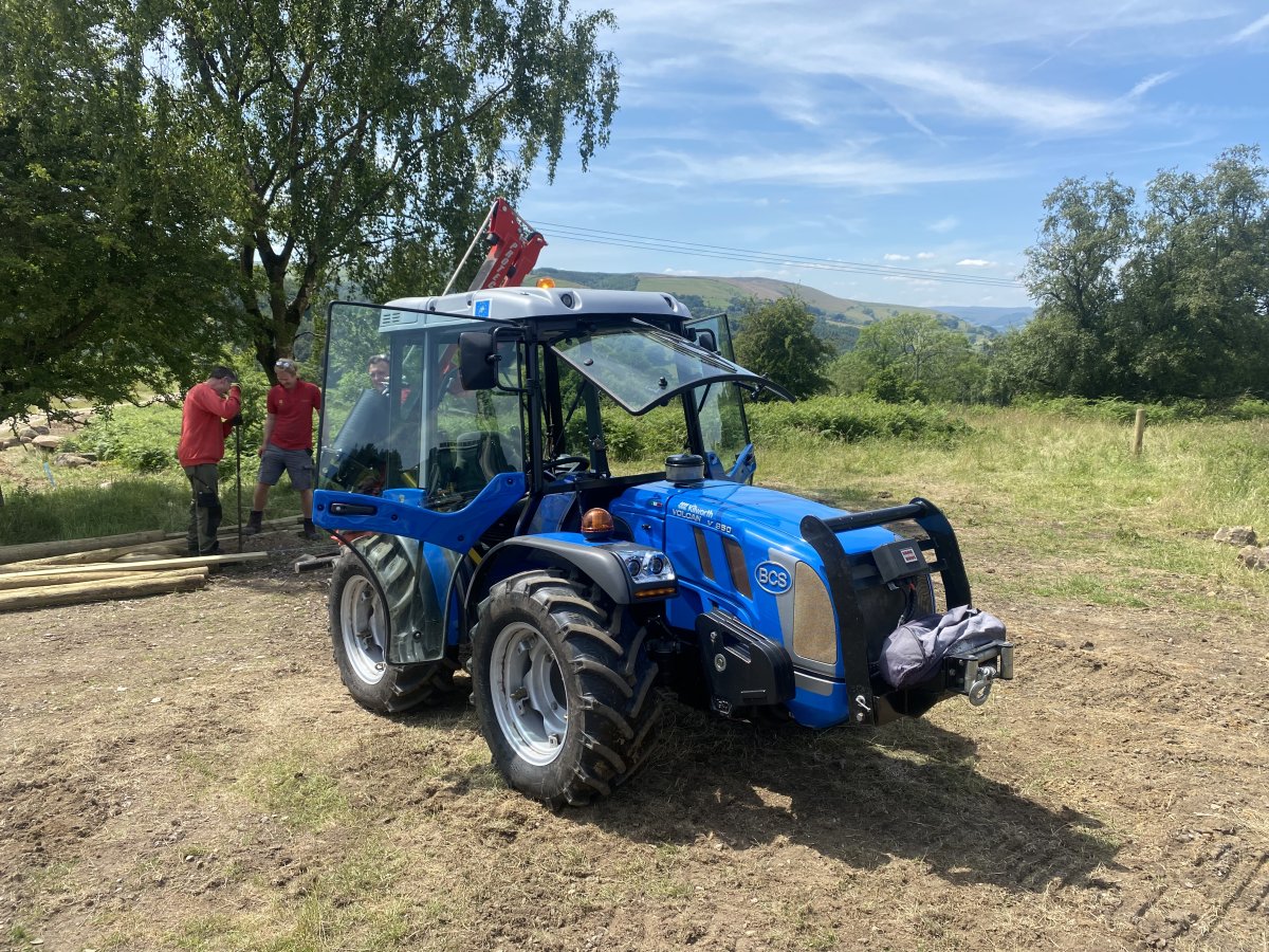

The trust rangers we work with have an immaculate 4k hours bcs alpine tractor that they lovingly look after , I’ve told them I want to buy it off them when update it. That’d be a good alternative
That looks a lovely setup. I've often thought about alpine for a fencing setup. It usually came down to lack of weight because I needed a rock spike really which made it all quite heavy. But for a towable unit that can get places an alpine would be ace. Quick moving it around site too which is where the digger knockers aren't so good- working around farms and displaced fields etc. My dad has a small alpine the only problem I'd have with it is it's a bugger to get on and off it- which would make a bit awkward for the solo fencer on and off etc.
I think the P30 contractor model is a brilliant looking thing, all the movement you need in a small package and still decent enough weight for most strainers etc
