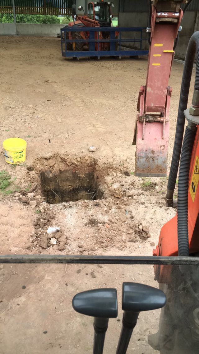

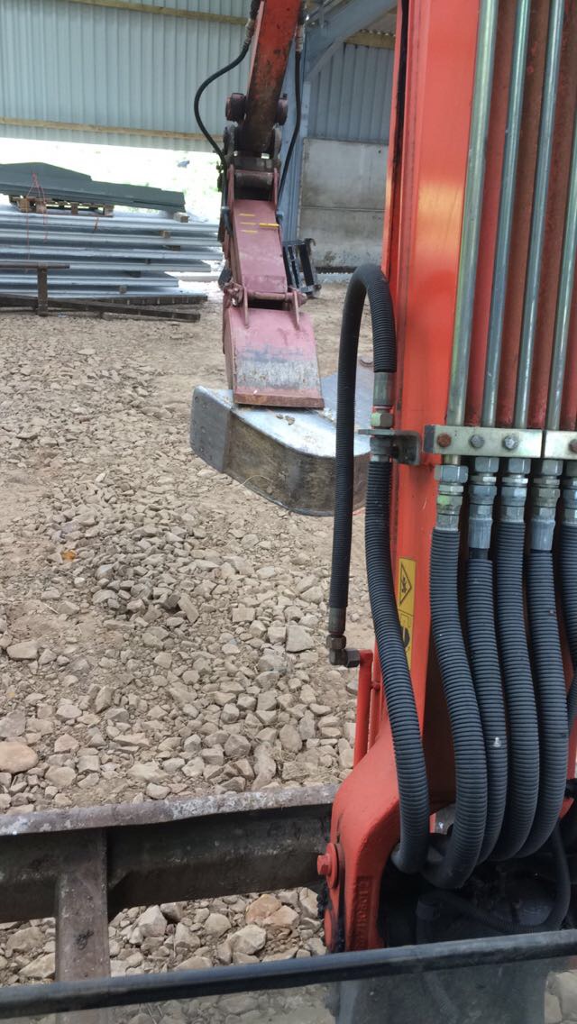

This works well got sick of using a hand held one so made this :LOL:
did you ever put this up on CEF ... seen one before somewhere and they're a brilliant thing (y):cool:
