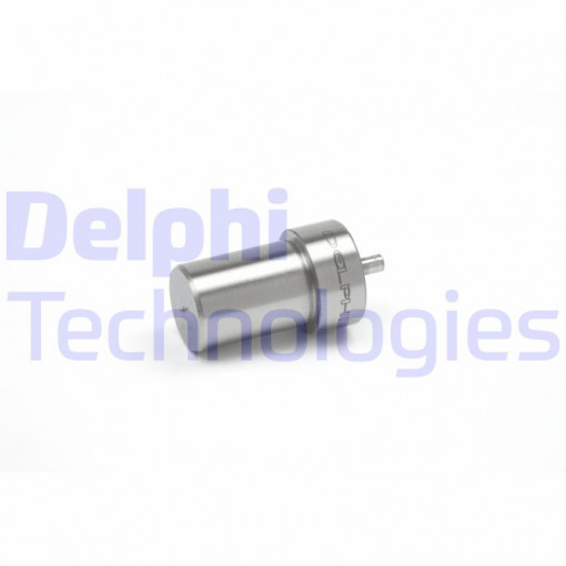

I'm thinking, if the injector head is new, removing the shims will adjust the timing to 0 degree

Show me injector head?

Nozzles👍 take the injectors out put them on the ends of a pipe, turn the engine over see if you get a good atomisation(spray)
