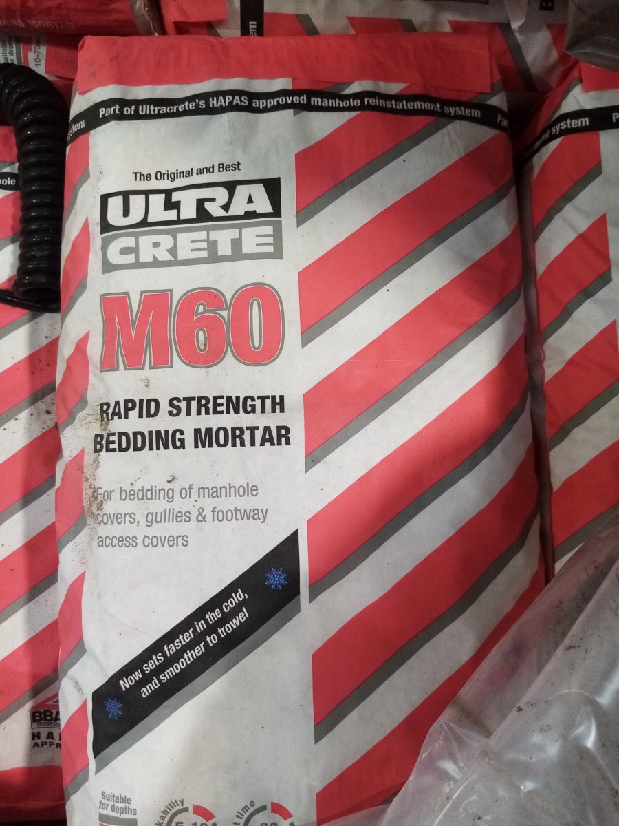

This is the stuff I have used
We use that for setting manhole covers in the road. It goes of f****** quick. 45mins before we open the road.
The blue circle stuff is more usable it takes a couple of hours to be strong enough to open the road again
Ye it's manhole we use it for really strong Toby the time you have cleaned tools etc lid is set solid,

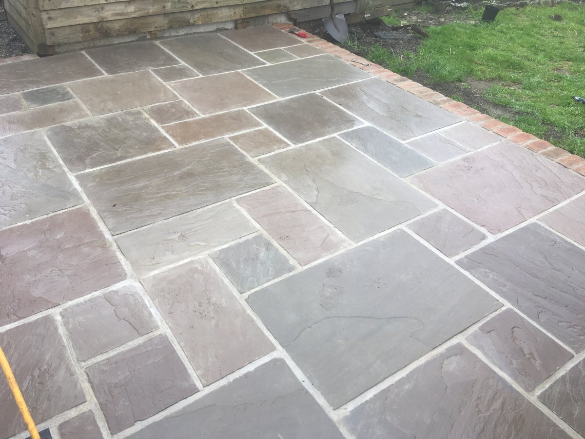

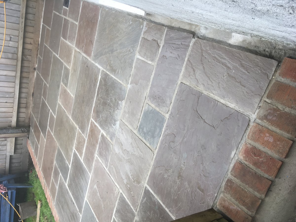

Yeah I found that- I cocked up a bit when laying my one out the back, wet the slab and bedded on a full bed of mortar but noticed before I pointed that some of them weren't totally convincing- so pulled up and made cement SBR slurry and relaid- seemed solid after that.
I'd never lay a patio in a professional capacity but was happy enough with my efforts in the end- you'll notice joints aren't that consistent in width and in the end did away with string line and just eyed them in as seemed to make it easier to even the joint width out better..🤔

Maxus
Looks nice with the white pointing 👌
