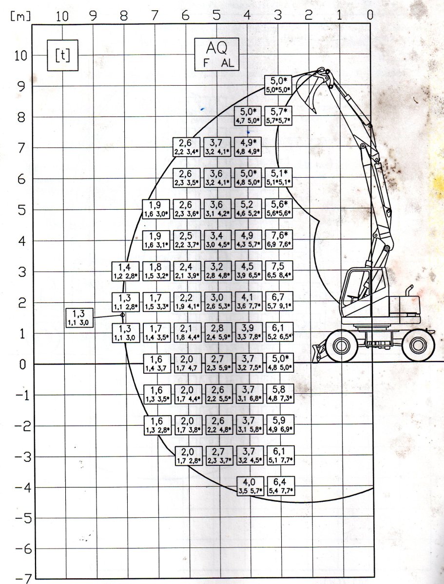

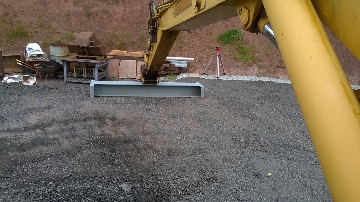

there's 800+kgs of bucket on there at full stretch and the grading beam is about the same ... will do 1100kgs at that free on wheels, cross carriage, 1300kgs in line FOW and 3000kgs at 360 degs with the blade down including a 500kg bucket
this chart is blade only spec. .... somewhere I have a chart for mine with blade and legs ... can add a 1000kgs to most of those weights with blade and legs down ... stability is very much down to the operator ;)
got it
bear in mind the loading (and reach) is on the lift hook WITH 500 kgs of bucket mounted on the dipper, fully crowded/closed

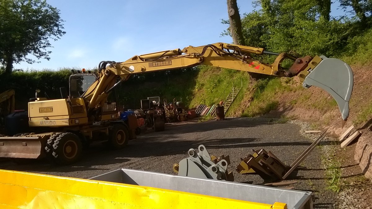

My one will pick up 2 tonne on the forks, and that's with 300kg of tilt hitch on the dipper as well.
